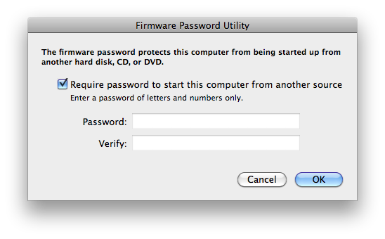

The last time I set a firmware password was years ago, and I don't remember it having any minimum requirements. This is the password box, and it doesn't list any requirements:

Here is what the Apple Genius does when you go in for a EFI PW reset. After you have proved the machine is yours, they will do the following.
1. Option key boot which will result in the EFI PW entry screen.
2. While still in that screen hit command+control+option+shift+s keys all at once. This will bring up a 33 character hash code that uniquely identifies your machine.
3. The Genuis will email the Apple mothership that hash code with a request for a "keyfile" to reset the PW.
4. The keyfile (about 350 bytes) is sent back to the Genius.
5. The Genius puts the keyfile on a USB key and option key boots the machine.
6. The machine reads the keyfile and resets the PW then reboots.
No more EFI PW.

Nuke61 is correct, but just to clarify, that is not quite what is going on with the OP in this thread. Someone used iCloud's Find my Mac remote lock feature to lock down that machine, and that locks down the firmware like we are seeing here. Removing either the PIN lock (without the PIN) or a firmware PW will require a visit to the Apple Store on newer machines. Even on older machines (pre-2010) where removing a RAM chip would reset the PW, that still does not get around the PIN lock. The two are interconnected security features.
