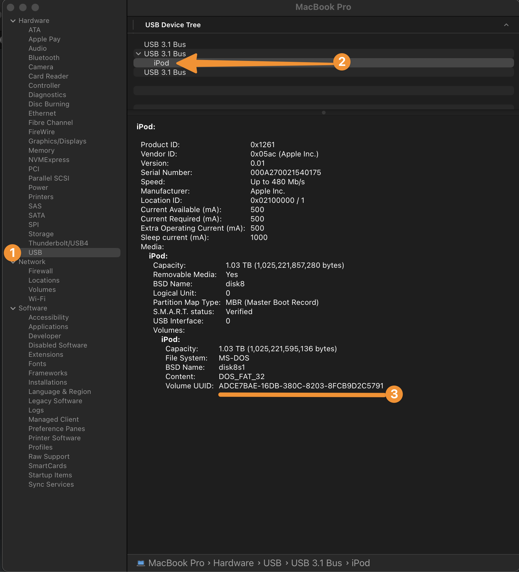

Step by step:
1. Launch the System Information app, and go to the USB tab, then locate your iPod and copy the Volume UUID of your partition:
2. Open a Terminal and modify this script by pasting your Volume UUID on line 3, then run it:

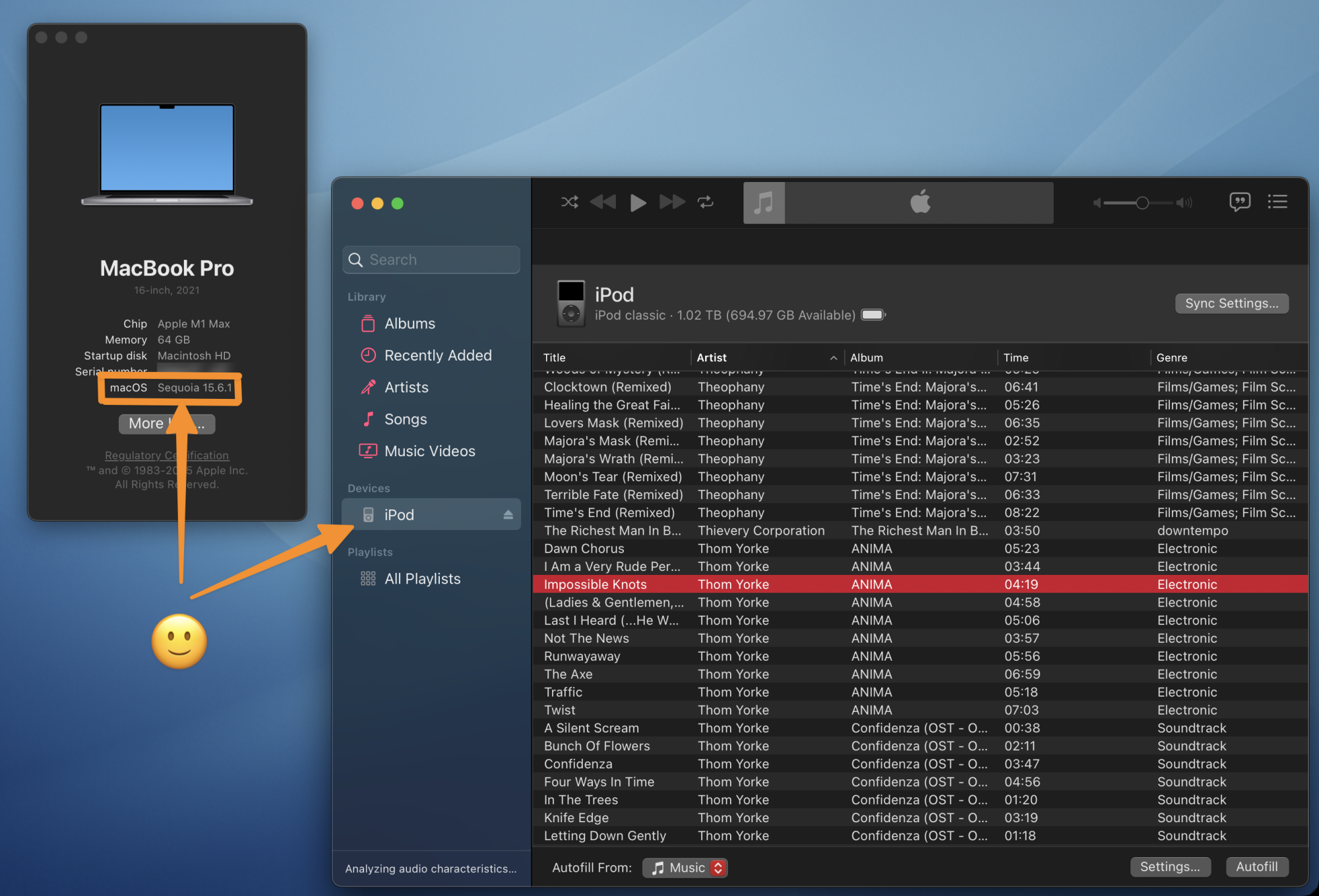

Fantastic work, thank you for sharing! I will try it as soon as I am somehow forced onto an OS past 15.3.2
This also means that the Apple Music won’t work for syncing anymore, correct? Time for me to finally make the switch then…
It actually does work. ... Quite surprising heh.
