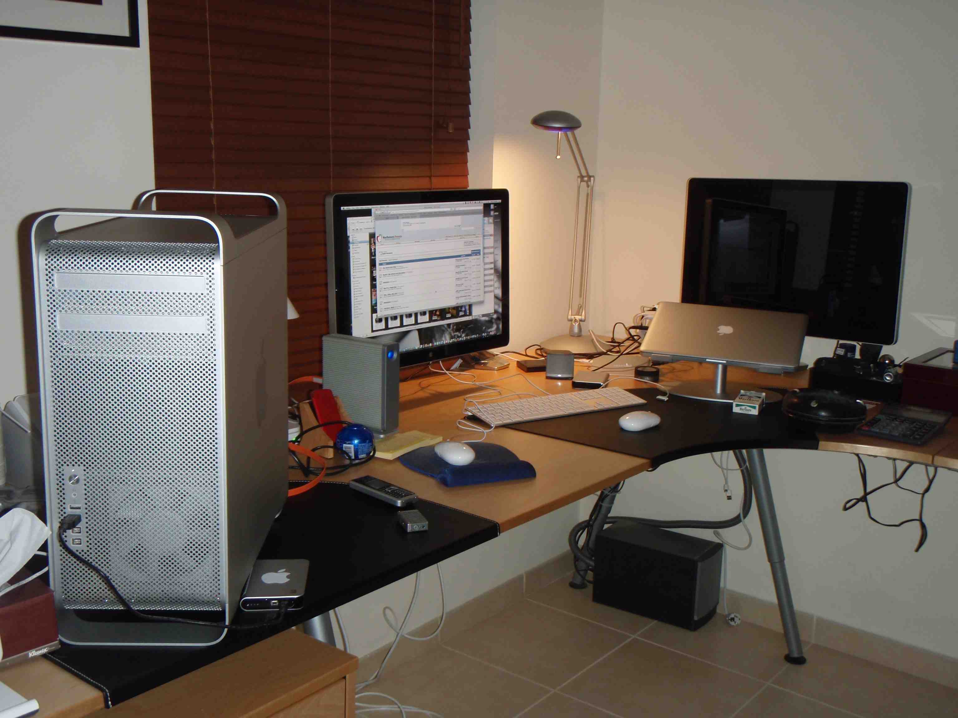

Well its here, I am still waiting for my SSD's and my second GT120 but its all fine I think, I have cloned my drive from my MBP.
Is there anything I have to do to any settings on the clone? difference between MBP and MP?
I have my second screen on its ergotron terminator arm.
Here is a photo as is, not plumbed in until I have finished in the case, spec as of now is, 2.66 quad, 8gb OWC RAM, 1 640GB, 2 TB caviar blacks in Raid 0, extra 1tb, in the optical bay using noiseblocker from OWC.
