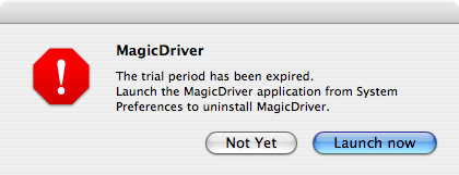

Despite removing the MagicDriver Manager app from my startup items, it kept adding itself there. So I would always get this error upon startup:
So I tinkered around and was able to figure out how to kill that notification that comes up every boot quickly after it comes up. Any other way around this besides killing "UserNotificationCenter"? Is there another startup items folder that I'm missing? I looked in /Library and /users/me/Library and I didn't see anything.
It works as it stands though so I'm not complaining! The below is technically compiled as an application and thus it's my first "app" ever! Thanks for your help!

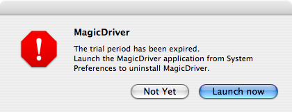

Despite removing the MagicDriver Manager app from my startup items, it kept adding itself there. So I would always get this error:
So I tinkered around and was able to figure out how to kill that notification that comes up every boot. Any other way around this besides killing "UserNotificationCenter"?

I would guess that the preferences in Magic Driver are set to "Open on login". Might look through them to see if that exists and uncheck it if it does.
OTOH, I do recall having to deal with the annoying message so there may be no way to get rid of it other than clicking on 'Not yet'. That said, it should only happen once unless you have to change a setting.
Glad you worked out the code. Looks right.
