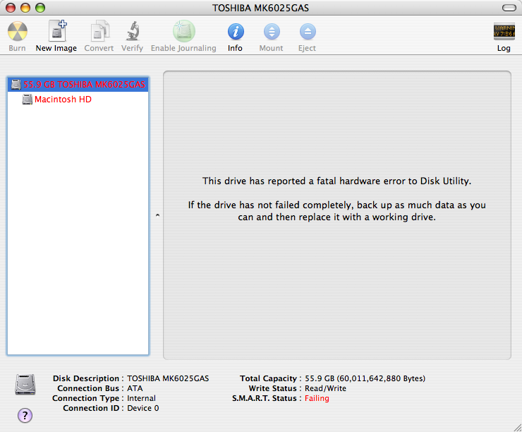

So my PB has been acting very strange lately, well actually, acting strange for the last 2 months. Constant freezes with beachballs, a hard drive that sounds like it is constantly accessing when I'm doing anything. Hard drive buzzes when I tilt my PB.
Over a year old, no Apple Care, so I am probably going to spring for a newer, larger, faster HD. Do I head back to my reseller for a PB compatible HD or can I buy one off a store that sells PC parts? Which hard drives are good?
First time buyer of 2.5" HDs.
I guess this is bad for me. Attachment included.
I've yet to do it, but as far as I know any 2.5" laptop drive should be fine.
Just to state the blindingly obvious...back that drive up now!
It's on it's last legs for sure. I'm fairly certain any 2.5" will do you, but I'd spring for a 7200rpm one 😉 Apparently it's a nice little speed boost.

So disk utility only showed this today after 2 months of odd behaviour?

i had also error messages from my pb hd. even the genius said the hd is going belly up. but it turned out to be faulty ram that wrote garbage onte the disk. that then came up as disk errors. fortunately i found out before i replaced the hd.
so check your ram. hardware test showed my ram as good in the beginning, but after a few days it found errors. after replacing my ram i had no problems for 3-4 month now.

Well, the HD finally died. 🙁 Didn't get a chance to test the battery life with the original Toshiba 60 GB 4200 rpm HD for comparison.
