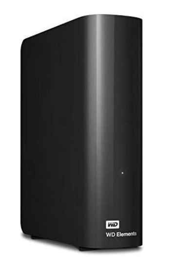

Do they have to stand up? or Can I run them on their side?
Nearly taken a fall, would hate to trash one of them before its time
I do have CCC back up but still concerned stability standing
If they can lie down Im think more air floe would happen as well

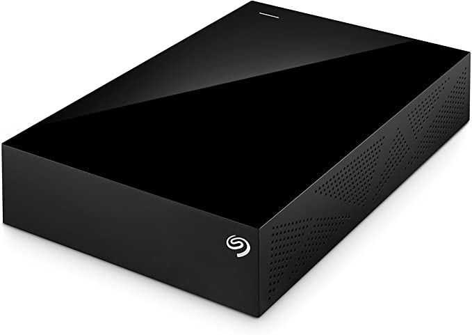

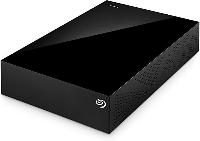

You are welcome. If you look at some of the Seagate desktop external drives, they can also need used vertically or on its side.

I'm just wondering what led you to that conclusion? The particular model you posted has moulded feet on the bottom but not on the side. I'd be wary of doing anything which covers ventilation holes (like placing them flat on a surface...) as this increases the chances of early failure due to heat.

Which models do you have, exactly?
Pretty much every hard drive made that is still functional today can operate in multiple orientations including flat or side-on. Think back to the original ipods and ipod minis.
HOWEVER: external enclosures aren't always designed with this in mind and heat is the biggest killer of these devices.
Pretty much look like this, all except one is USB 3 and some are my book and some are call essentials
I'm thinking lying down may let more air in from the vented top and bottom?

I have the 8 TB WD easy store which looks exactly like the OP's. These contain 5400 rpm drives and run cool. I've been using my three externals for years while laying on their side. The ventilation holes are not obstructed.
The Seagate pictured is meant to sit on a flat surface and the ventilation holes are only on the bottom and rear of the enclosure with none on the top, front, or sides.I have two of these Seagate 6 TB drives at work. I then daily and they have worked wonderfully for years.

On a different note, I have one of the pictured Seagate drives at home, and as you can see in the picture, you're wrong. I assume you haven't been to work recently and have forgotten, but they absolutely do have ventilation holes at the sides.

The correlation is that the Seagate has holes on the side and sitting the WD on its side means the WD has holes on the side.
I see on the Seagate picture that the holes are very tiny compared to the vents in the WD. Does it make a difference? I don't know.
