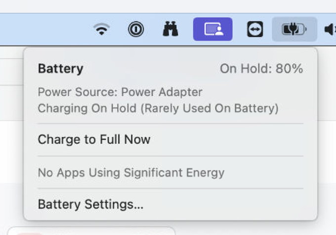

Yeah, it will definitely happen at some point if you leave connected constantly. Every time I remote into my mom’s MacBook to help her with something, I see this because she basically uses it as a desktop:
