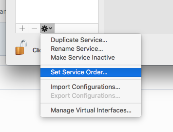

I'm confused here... so you have a Time Capsule device (Apple router with a hard drive built in) and you are backing up to that over wifi? Where does USB come into this?
If you can see the Time Capsule drive over wifi, you should be able to see the same drive over ethernet as long as they are on the same local network.
If your Mac is connect to both ethernet and wifi, and you want the backup to use ethernet (good... because it is faster normally) you will want to go to this setting in the Network pane in System preferences and set it so Ethernet is at the top and wifi is below ethernet. This will make the connection prefer and use ethernet when both are present. Otherwise, even if you are connected over ethernet, it will not be used.

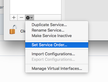

That did the trick! I wasn't able to find the Time Capsule-harddrive in the list when I was going to choose a drive to store my Time Machine. Thank you!
