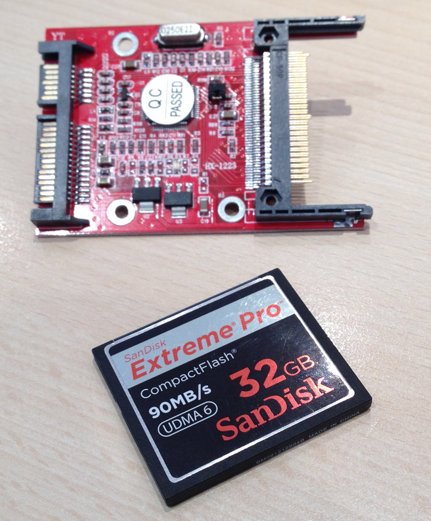

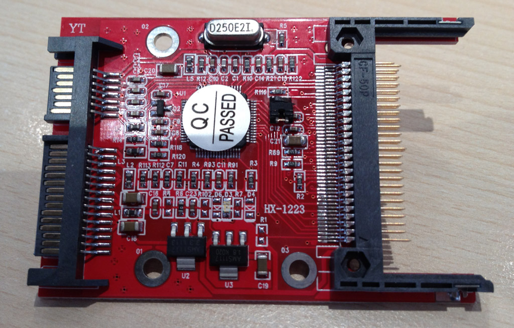

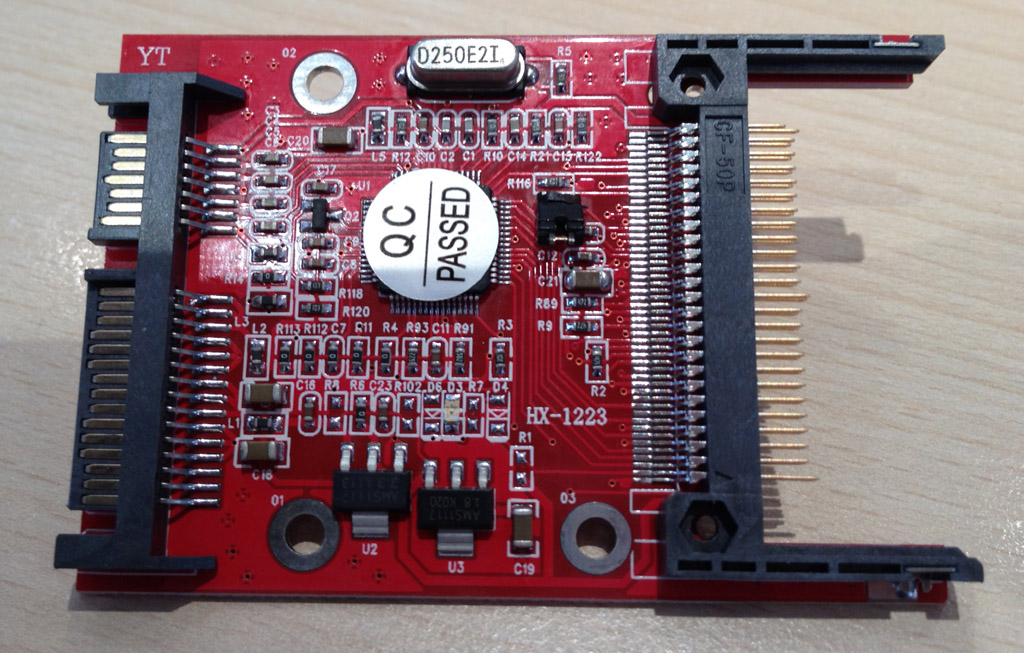

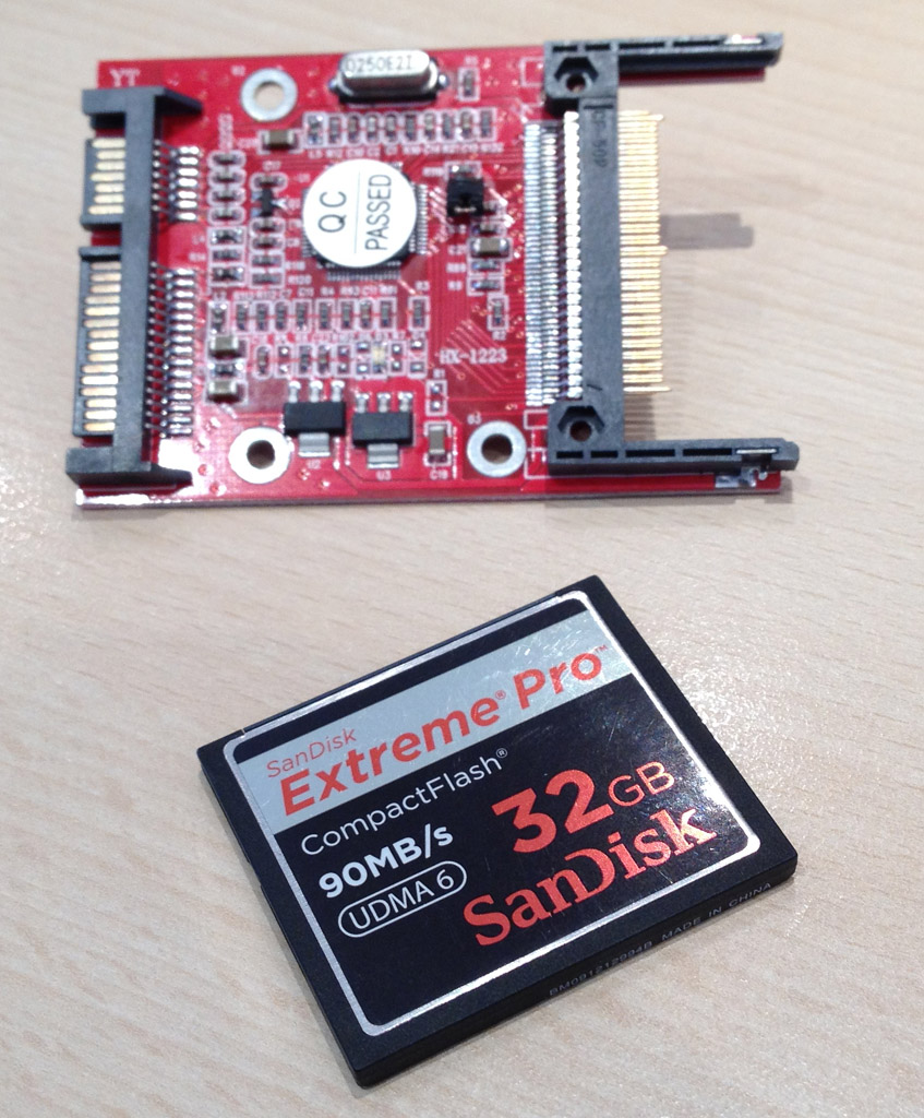

Here are some photo's of it.
Firstly the adapter on it's own, and second next to the CF that I used.

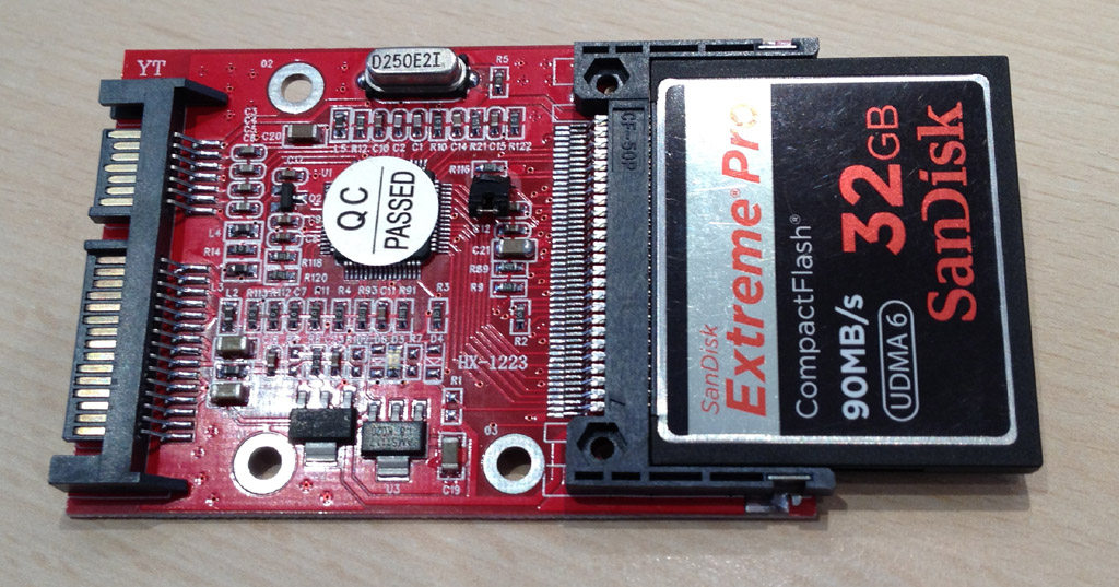

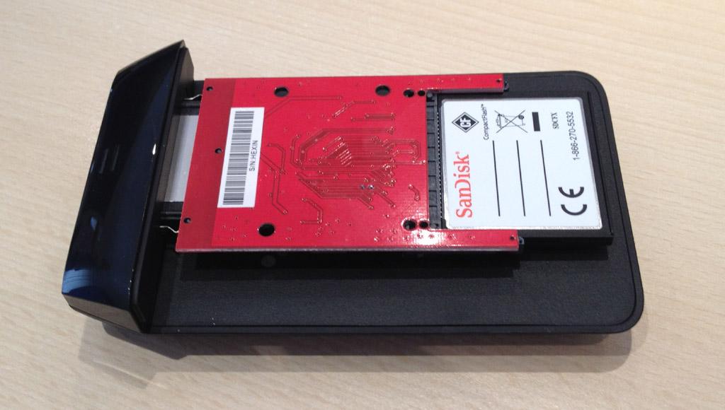

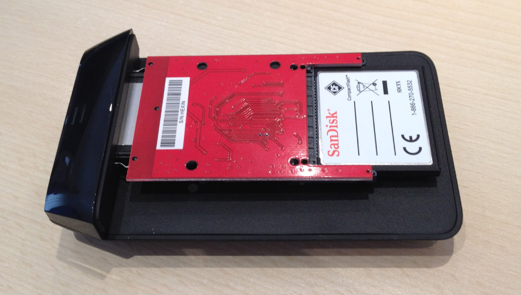

On the left is the CF card inserted into the adapter.
And on the right is the entire unit attached to the Seagate Thunderbolt adapter.

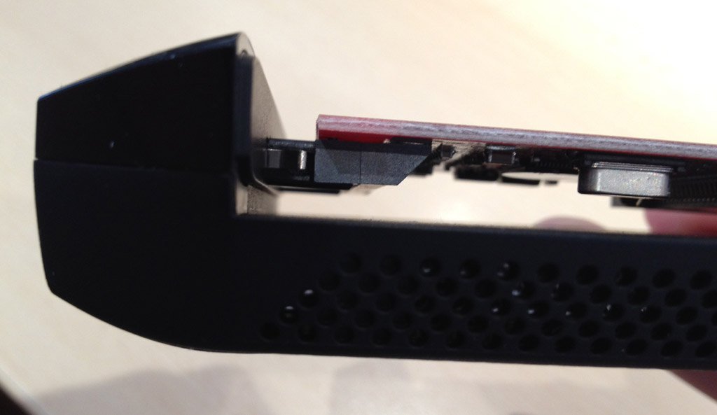

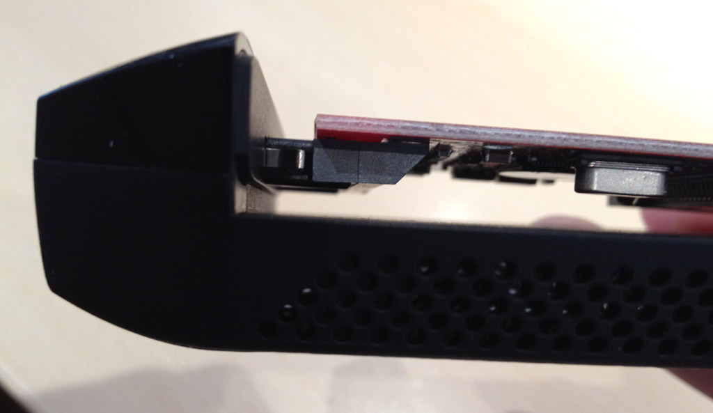

Finally this is a photo showing the connection from the side.
As you can see there is a gap between the card and the interface. However this is not a problem as the card is very light.
The card slots onto and off the Thunderbolt interface pretty easily. I am careful with it though and usually wiggle it a bit to help things along. Once connected it has a nice snug fit and I think it very unlikely that it would disconnect by accident.

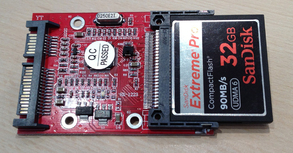

The adapter is a bare interface, which is designed to be inside a computer. As such its components are rather exposed.
I have now bought three of these, and may try to make one of them a bit more rugged if I can find something suitable to enclose it.
Please understand that I am not interested in marketing these myself, I am simply providing the information.
As a photographer who take a lot of photo's from time to time, I think that this will really speed up transfer time in the field.
