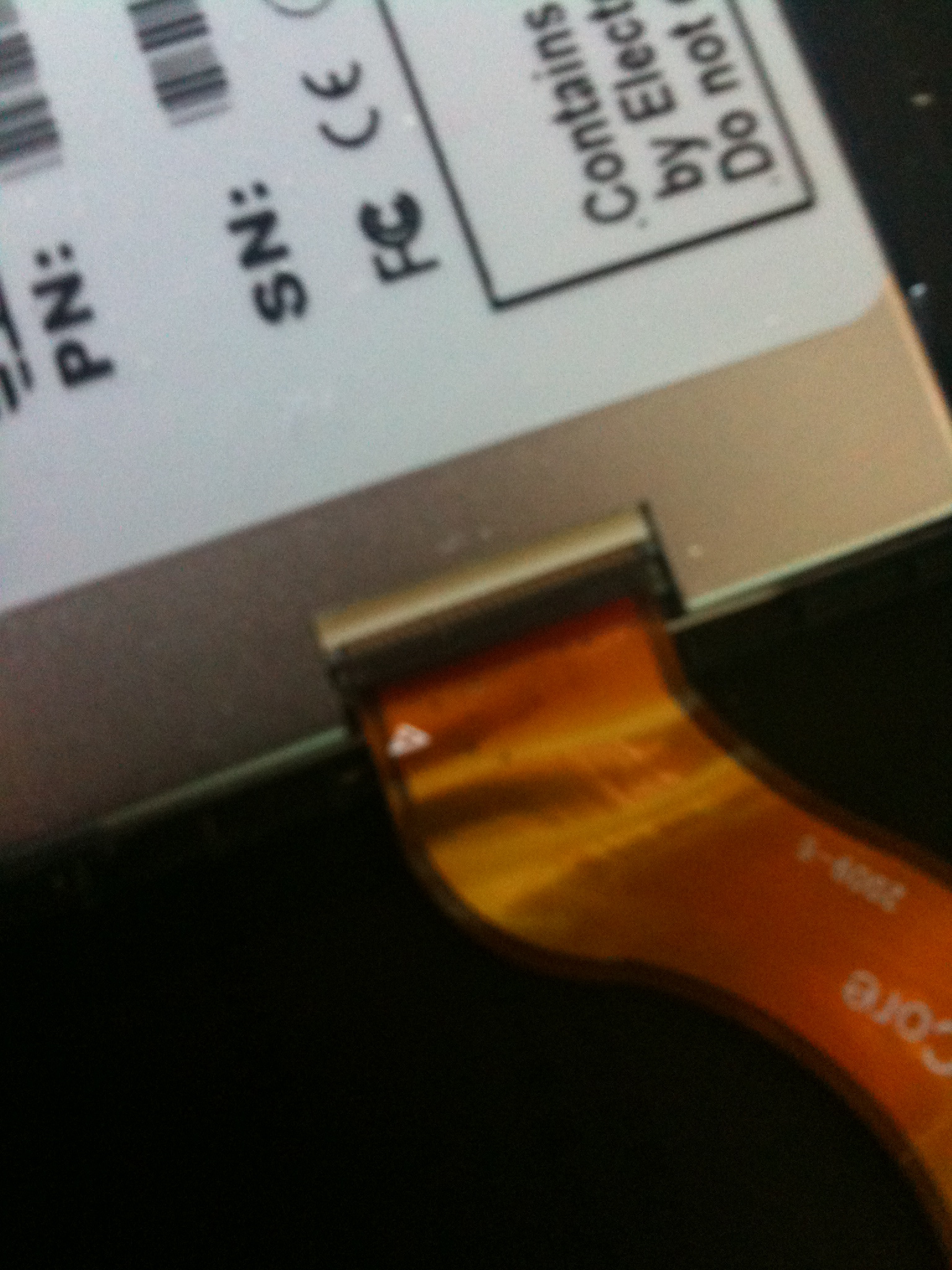

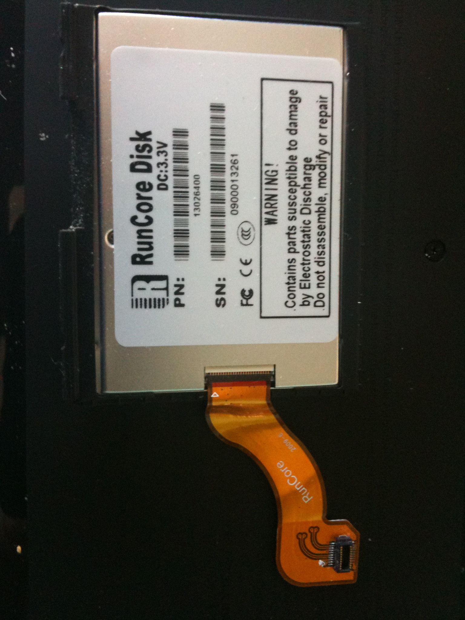

Hi Scotty,
The Runcore LIF connector does not have a tape on its cable. I have tried taken it off, there's a black lid as shown in the photos above that clips the cable down. Lift the black lid up, and the cable comes off easily (Low Insertion Force). Push it back down, it fastens the cable. If you need a tape to secure the cable down, perhaps the black lid has broken?
Interesting, mine doesn't have that! Perhaps we have different models??? How new is yours?
Pictures comparing OEM 120gb HDD w/ cable to RunCore w/ cable
Below are some photos. You can see the Apple cable is wider than the RunCore cable and that the Apple cable has the 2 littles holes for the black latch on the drive. The black latch has little posts that lock into these holes when the latch closes. The Apple cable will not fit the RunCore drive because of the extra width.
That's interesting... I have to take it apart again to check this out. Maybe I took the tape off the Apple cable and put it on the Runcore LIF cable? Honestly, I have been on some pain meds, and it's highly possible that I am forgetting what I did now.
Does anyone else have a "black" tab that locks on their Runcore SSD? Mine doesn't have this feature the post by UltraTux says it does? I am wondering if we have different SSDs... maybe his is a new batch? Or, maybe mine was shipped without one? Would explain why I needed to tape the cable in place for sure!
Anyways, when I am feeling a little better than today I will figure out exactly what has happened with mine again. This black locking mechanism that opens and closes and fixes the LIF cable in place has me confused, as I am sure mine doesn't have that and I don't know why.
hmmm, That cable is very strange. At first I thought he was talking about the Rev. A ZIF connector, because it does have a black retainer clip. Then looking at the pictures, there appears to be something different going on. My old Rev. A did not have the extra-wide cable like that. Perhaps he has a Macbook Air prototype???? This is different than anything I have seen.
These photos of the factory cable and drive are from a MacBook Air Rev. C (MC233LL/A) built in June of 2009. The drive is a Samsung HS12UHE.

Has anyone figured out why the previous poster had such a wide cable??? I'm still interested in knowing what that's all about.
If he could check his serial number at appleserialnumberinfo.com and see the production date... that might give us a clue.
I assumed my cable was wide too. I haven't opened my case again, but I did realize that I didn't use my original cable with the Runcore SSD in the MBA. I didn't remember correctly. All I did was use the tape from the original LIF cable on the new LIF cable. Anyways, sorry for the wrong initial information.
Next, I know for certain there is no "black clip" fastener on my Runcore SSD. I don't know if it's a different model or if it's simply missing. I sent Matt from Runcore an email requesting clarification.
According to one poster, this is a clip/lock that you open and close to lock the LIF cable in. This is obviously something an instruction sheet should inform. I can assume that if some people have that clip they're not installing it properly and the cable probably isn't being "locked" into place creating problems. I am sorta assuming that mine is just missing, but it's possible that Runcore has made different models. I know from my experience working on technology that this would be a great thing to have on an SSD... much better than Apple's "tape solution." Yet another benefit to Runcore SSD over stock SSD. If we could just inform people with some instructions, I think a lot of the reported problems would go away.
I hope to report back soon.
Every Apple OEM drive and 3rd party drive like RunCore (SSD or HDD) should have a hinged clip that flips up and down to unlock and lock the LIF or ZIF cable in place. Every LIF/ZIF connector i have ever seen from any device or manufacturer has this device. If yours doesn't have this it is most likely a manufacturing defect and broke off. If it works without it i guess thats fine, but it will not be held as securely as it should be. Below are photos of these clips that should be attached and working.
I believe you. I didn't notice it though when I removed the stock SSD. We definitely need to be warning people of this. I certainly need to take everything apart and review it all again. If I make a video, it will all be very clear to people, and all of these problems should cease. It sure would have helped had I paid attention more and reported this with the original instructions. I apologize for that. My Runcore SSD definitely doesn't have that piece though. Perhaps it broke off during shipment. I will look through the packaging again.
ScottsDale as far as I can tell they all have had that tab. That is defiantly why you had to tape yours down.
Matt Dawson
Runcore
So is it all different for Rev A, B & C. When I installed the Runcore 128GB SSD in my Rev A a couple of weeks ago, I used the original connector.
