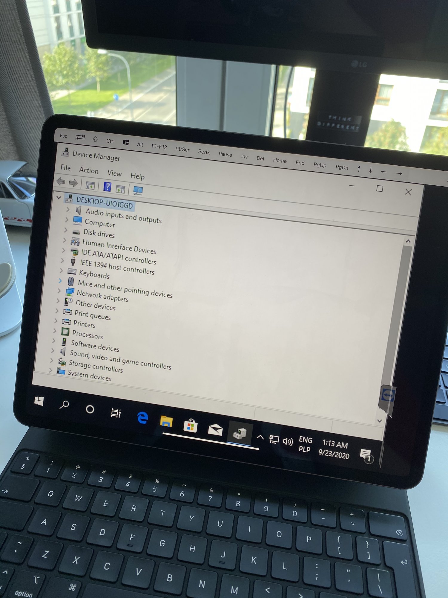

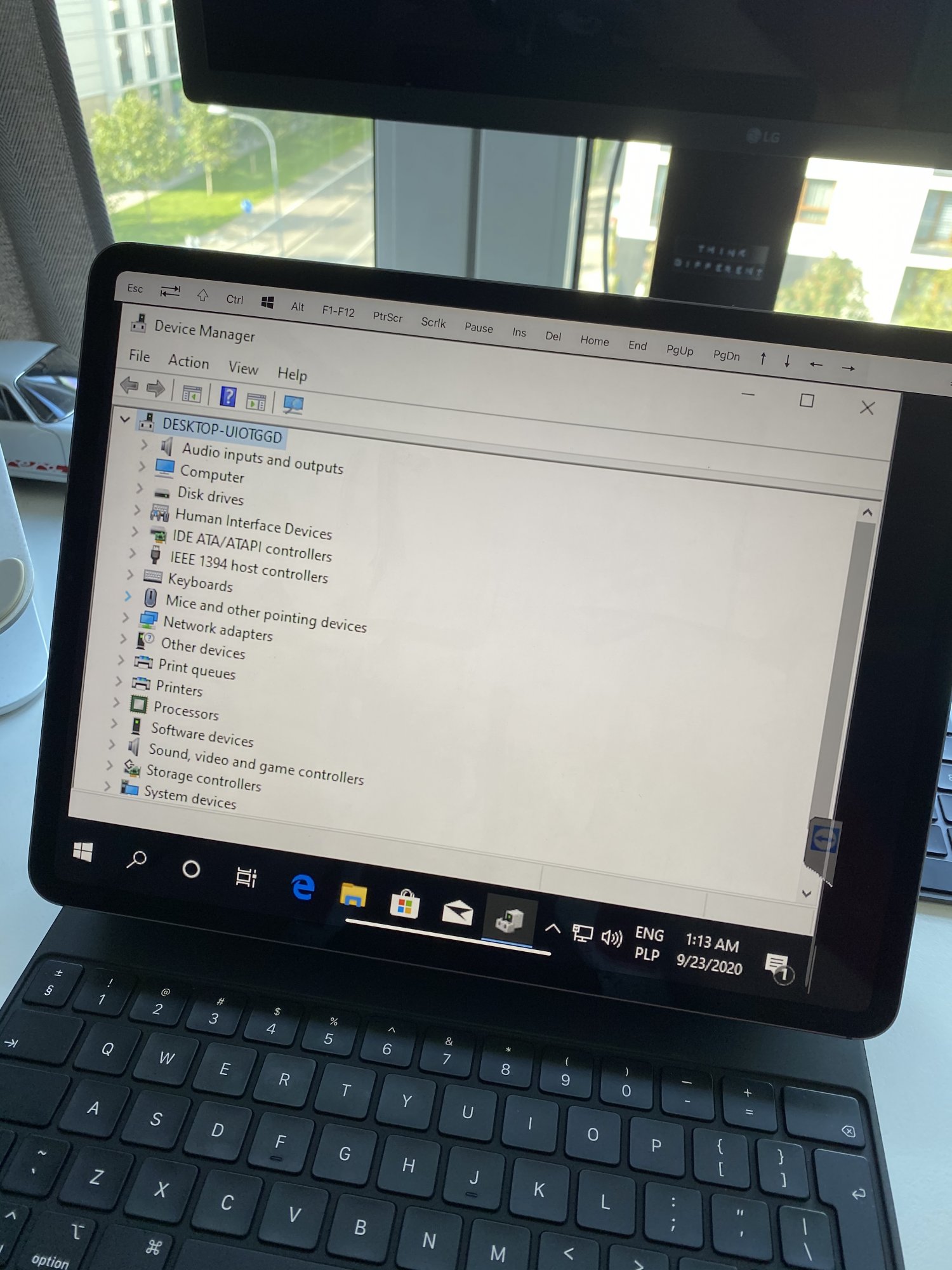

I have installed teamviewer and connected to it with RTX inside, device manager doesn’t list any display adapters.

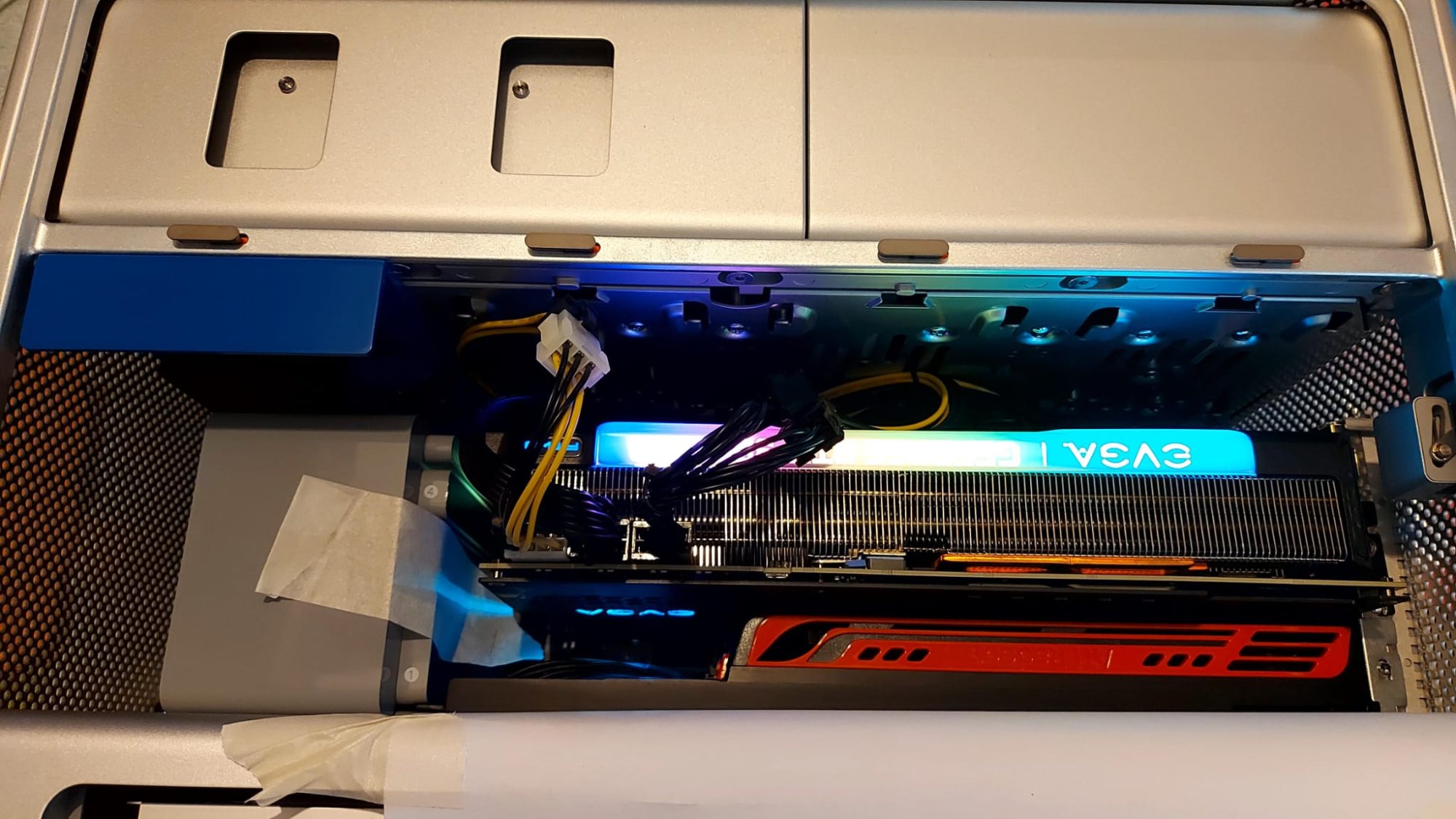

Hi everyone, I'm trying to see something with RTX 3080ti with MacPro 5.1 only with windows.
The power for GPU is ok, I tryed to power also with external PSU but can't see something

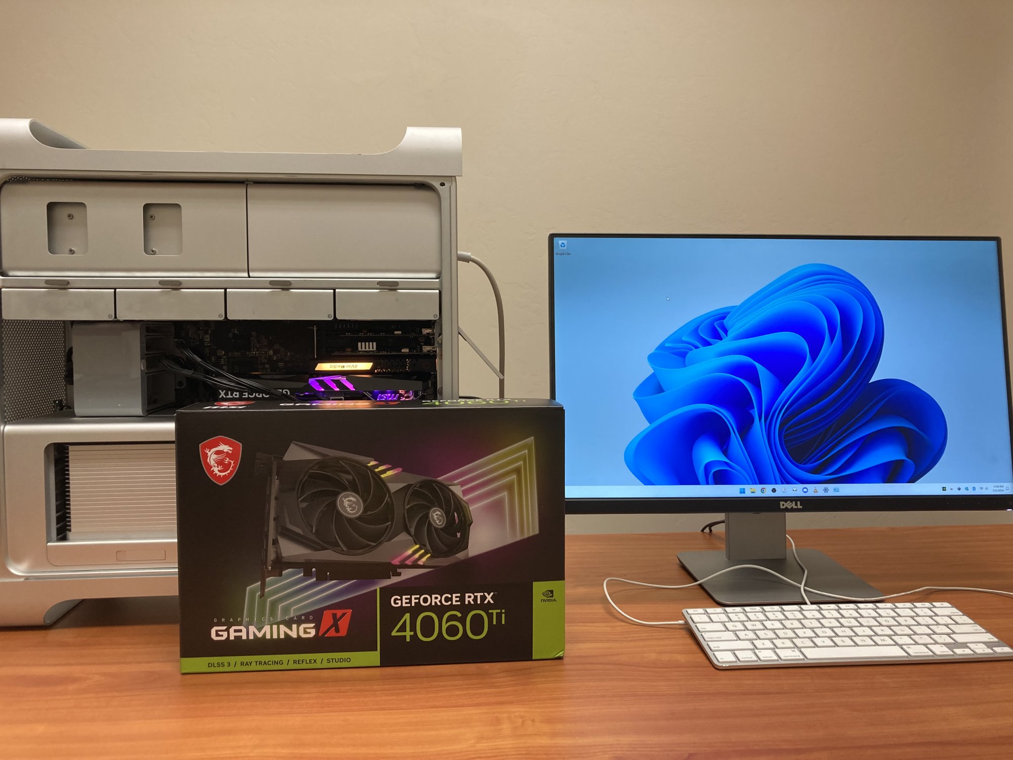

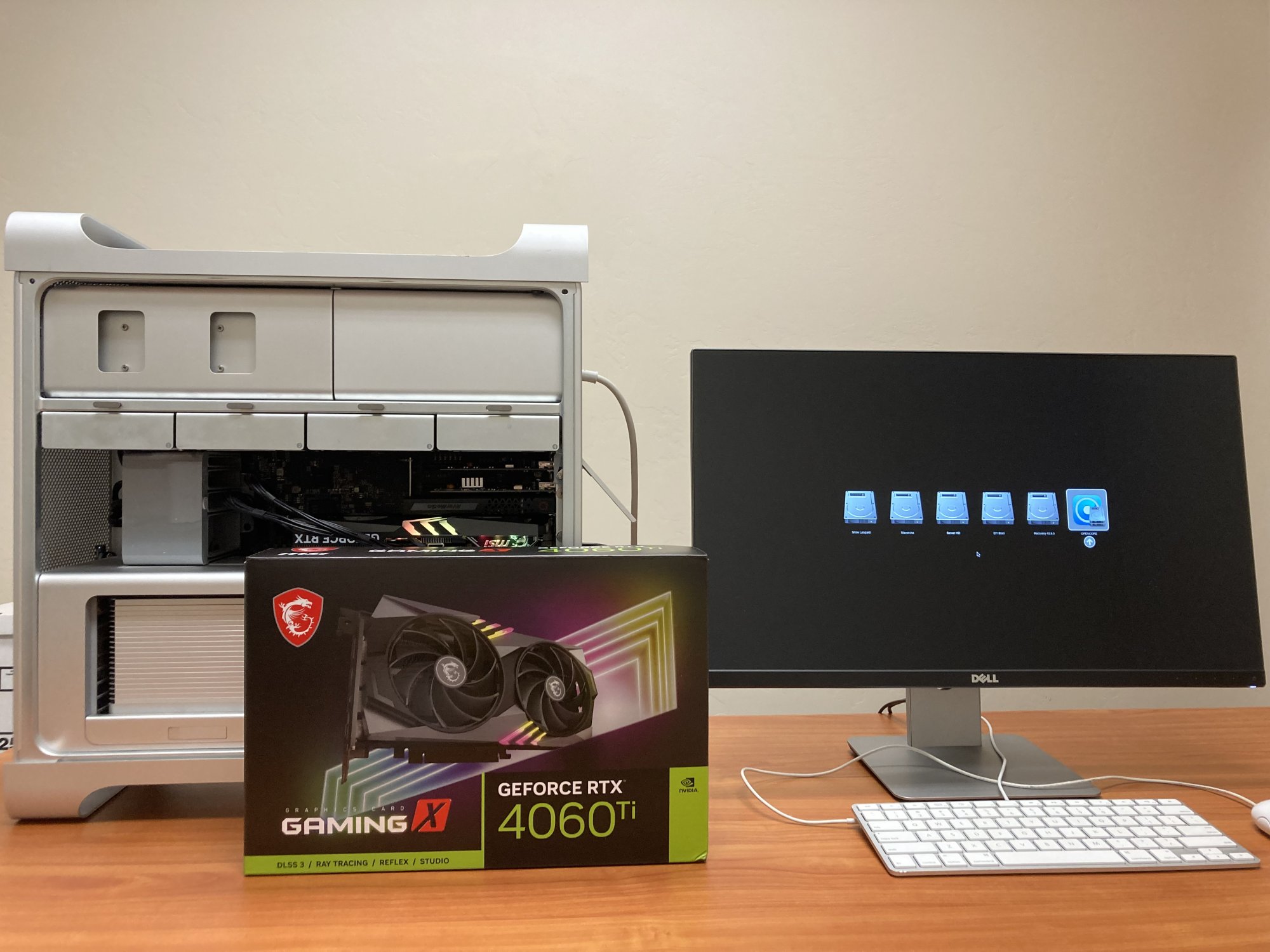

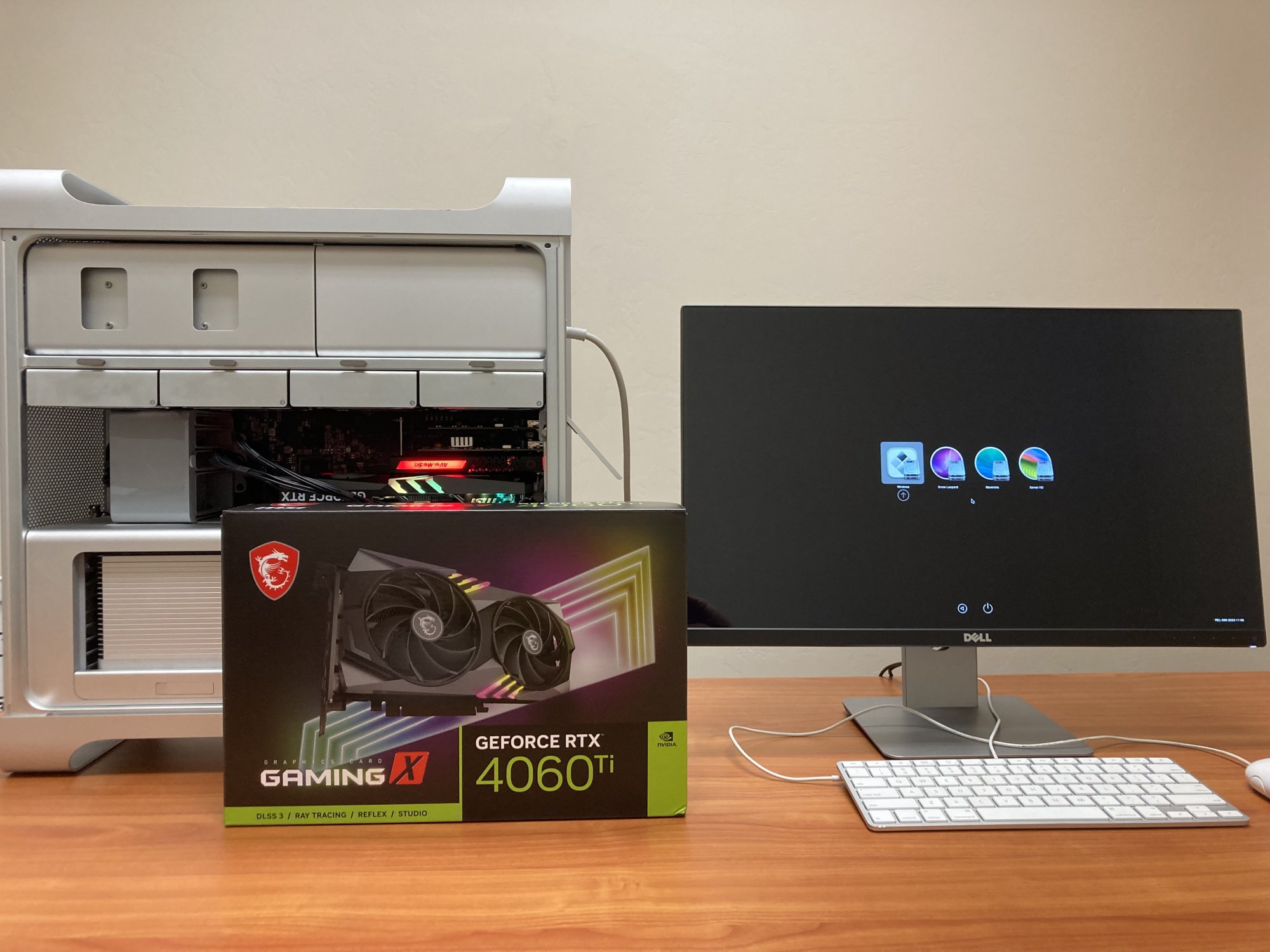

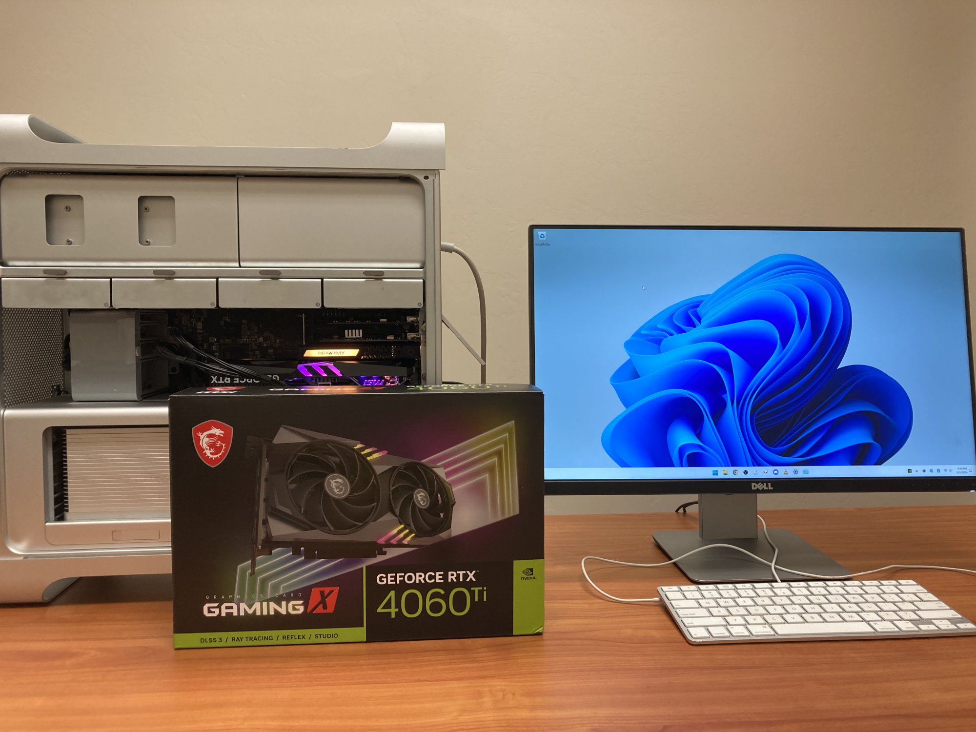

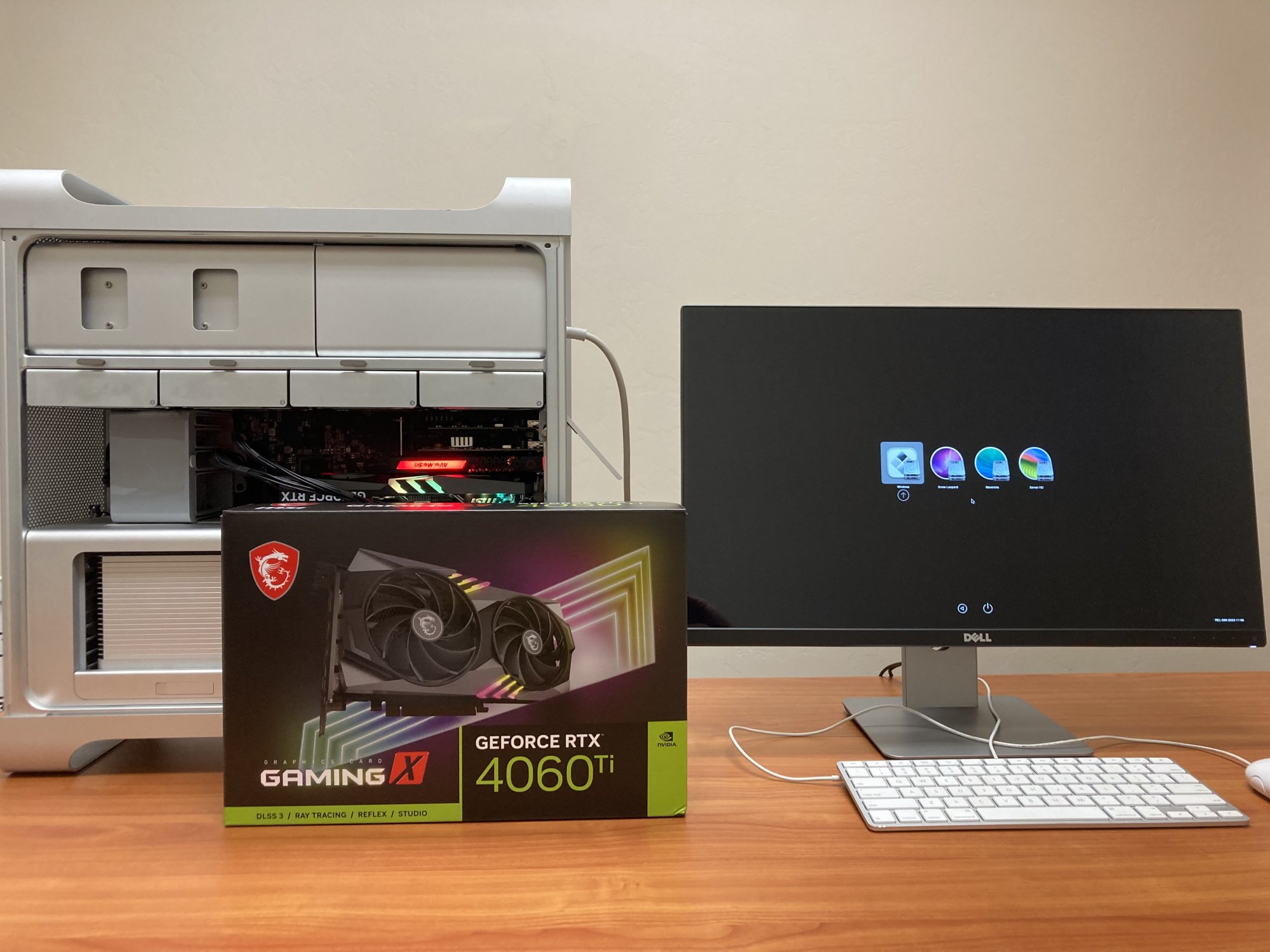

I was able to use dosdude1's ROMTool and DXEInject, as well as OpenCore's EnableGop.ffs file to get past the GPU Firmware block on a GeForce RTX 4060 Ti Gaming X 8GB, reference: https://forums.macrumors.com/threads/manually-configured-opencore-on-the-mac-pro.2207814/
Appendix section on Native Bootscreen Support
I used Mac OS X Mavericks to backup the stock firmware and Flash the GopFirmware back to the MX25L3205D chip on my motherboard.
I was able to get Windows 11 x64 UEFI to work with no issues, but I haven't touched macOS yet.

I used the Appendix Section on Native Bootscreen Support as my step-by-step guide, from this page: https://forums.macrumors.com/threads/manually-configured-opencore-on-the-mac-pro.2207814/. It's the very first post and the section is at the bottom. You will need to have the latest firmware already installed before following this guide.
I used my ATI Radeon HD 5770 and Mac OS X Mavericks to do all the firmware stuff, because that was easiest (didn't have to mess around with the csrutil).
If you need more help, just message back after you get your firmware updated to 144.0.0.0.0
