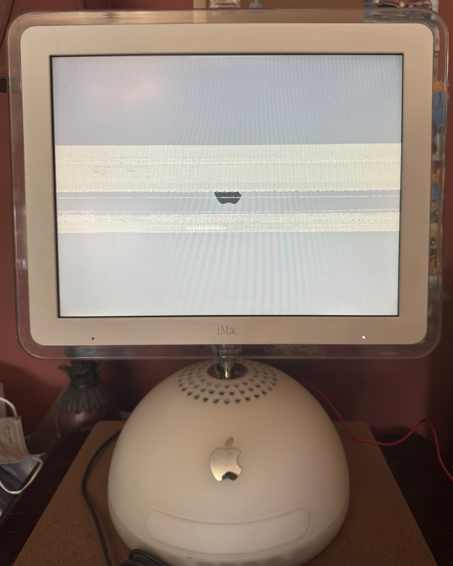

I have an iMac G4 700mhz 256mb 40gb CD-RW (January 2002)
It had Mac OS Jaguar 10.2 and Mac OS 9.2 dual boot. While I was rummaging through the previous user's files (I just got it from ebay), I opened something that made it open a black screen with a window about locating something, and would give me an error when trying to close it. So I force shut down the computer, and when restarting it, it flashed between a Finder folder and a question mark folder.
I restarted the computer holding down X to hopefully boot into OS X. Same result.
I reset PRAM by holding Cmd + Option + P + R. Same result.
I held down Option during startup. It showed no drives.
So I downloaded this copy of Mac OS Jaguar from internet archive:
From the iso I downloaded, I burned the CD-R in Disk Utility on my PowerBook G4 at 8x speed.
I held down Cmd + Option + O + F to launch Open Firmware. There I could get my cd drive open and insert the CD-R. I gave it the command boot cd:,\\:tbxi and after trial and error it showed the Apple logo for 10 minutes straight, and then it showed these lines.
