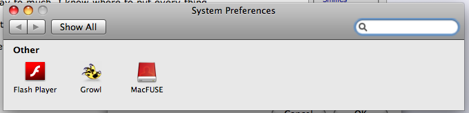

My system preferences look like this

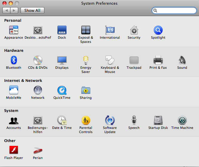

They need to look like this

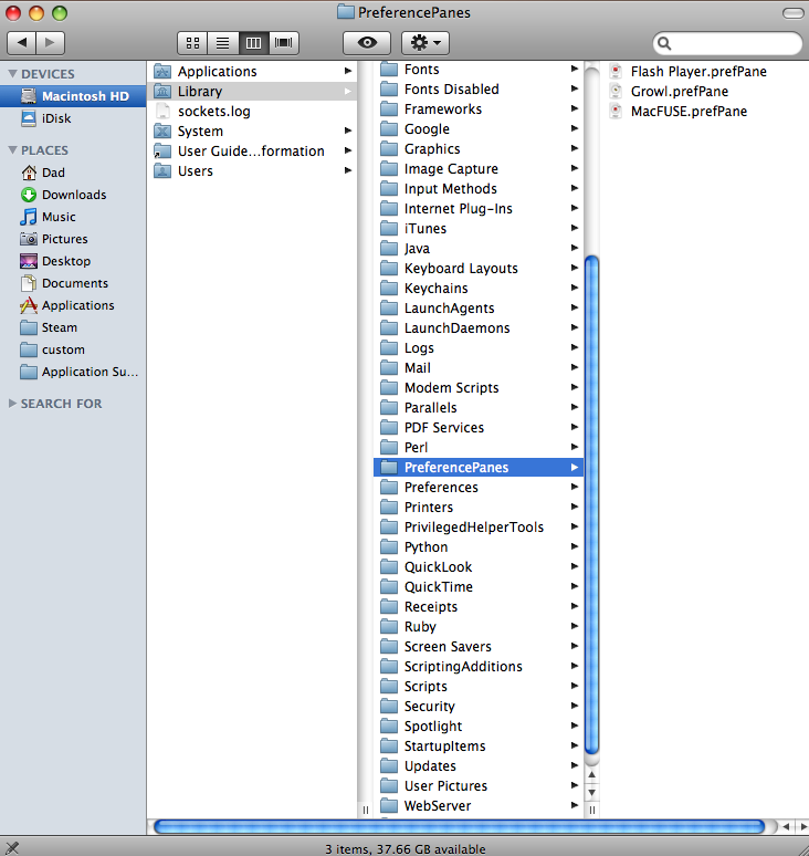

Your system preference panes are NOT in that folder from your screen shot.
You are looking in /Library - please check in /System/Library/PreferencePanes
But - go to your user Library (in your home folder), then open the Preferences folder, and delete the file "com.apple.systempreferences.plist", and "com.apple.preference.desktopscreeneffect.plist"
Then, log out and log back in, or simply restart your Mac.
Even if your system preferences still do not appear properly, the hot corners will be reset to defaults - none - which will fix the corner issue that you are struggling with.
