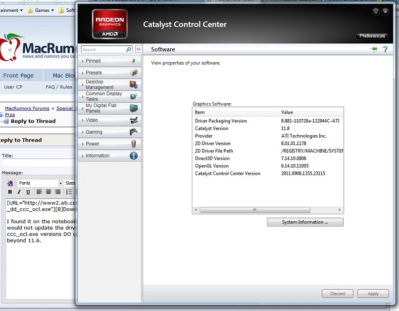

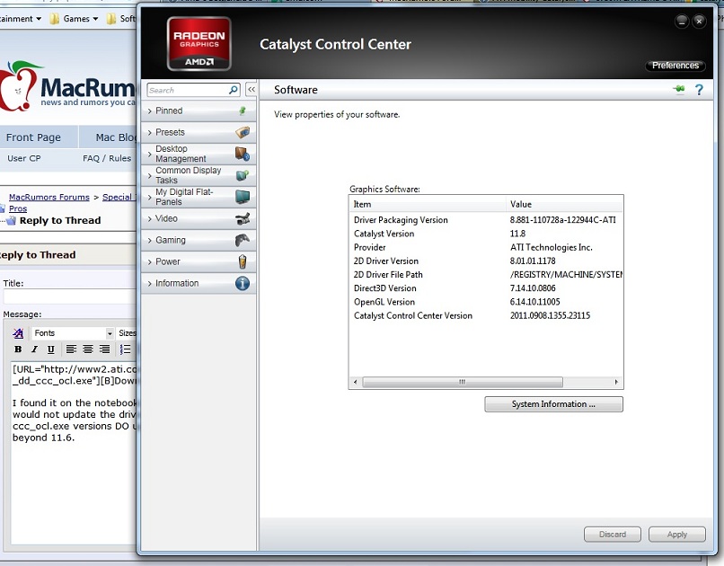

Download from this link.
I found it on the notebookcheck forums. The ccc.exe versions of the drivers would not update the driver version or catalyst version beyond 11.6. These ccc_ocl.exe versions DO update the driver version and catalyst version to 11.8. You can try changing the version number in the link if you want 11.9 or whatever.
