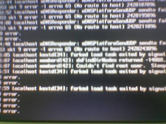

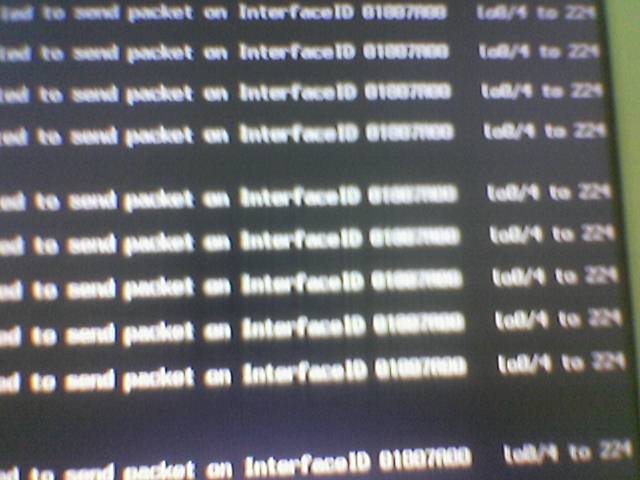

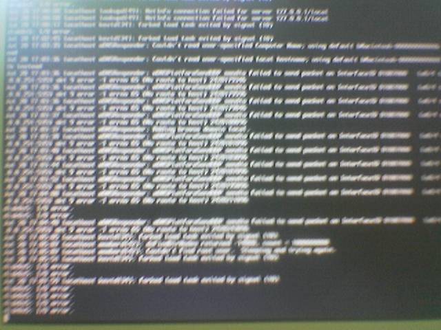

Heres whats coming up when I boot in to single user mode and leave it for a bit
Two of the pics are of parts of the screen and the last one is of the whole thing.

I have a I/O error. I started it up in verbose mode and it said it was a I/0 error before it started hanging. Then it shows load task exited by signal (10) about five times.
well hate to tell you this but this I/0 error is kind of the proof that it not MS fault but a hardware failing. All office possible did was macro hit your computer it put a little stress on the hardware (maybe a bunch of re write of the hardrive, cpu 100% ram filling up ect) none of which should cause any more than a minor incovences while you have to restarted. Now if your hardware is already nearing failure it might be enough to push it over the edge. All it tells me is your computer was a time bomb waiting to go off. The OS is never given the chance to load so it points very quickly to a hardware issue not a software issue which removed MS completely from being the cause.

So I think it is hardware trouble and when I boot holding command+v im getting text:
disk0s5:I/O Error
Also when I type shutdown it says /etc/master.passwd: no such file or directory.
Also, it still dosent find the resore disk but it boots from my Ubuntu live boot disk fine.
