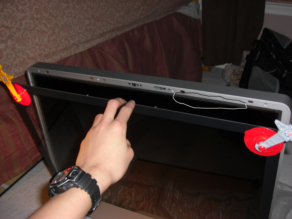

I have some pictures, if you take the actual glass off, its gone (I think, its been a while), but you can see the foam padding out of place in the areas where the bleeding is coming from.

Remember when I told you i opened my iMac? I don't have pictures of the actual bleed when the glass is off, but have pictures of the defect (i think, lemme find em)
EDIT: found ONE that is actual clear and high res, ill post it in full size, sadly the pics dont really show the defect much, but I hope you see what I'm talking about:
See how the foam is sticking out? I believe that's the culprit, Apple doesn't glue them down hard enough.

i can kinda see what you mean from that photo... but i just don't understand how foam that is not flush with the actual screen (under the glass) would cause a light leak... unless there is light coming up along the side of the screen, or from behind the screen, and the foam is there to block it ?? also, didn't you say the light leaks disappeared when you took the glass off? so it seems that either the glass is reflecting light, or is pressuring against the foam and making it no longer light-tight... ??

Don't take this for truth, but i THINK I pushed down on it while the glass was off in Front Row and it went away, but I THINK. It's been months...
