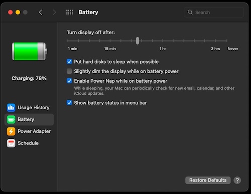

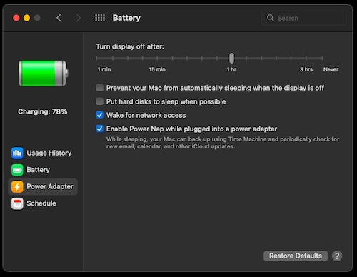

ADDENDUM: Because of the GitHub site's further info on app, I decided to give ALDente a whirl - albeit using its more limited features Intel version. Seems okay. Though further to comments there, I had to set it to 75% to achieve close to 80% charging (80% gave me 87%).
BTW, as far as the Optimized battery charging option within the OS is concerned, as far as I can see on my 2017 Air running 12.0.1, that feature doesn't exist at all? Maybe only exists for newer models?
