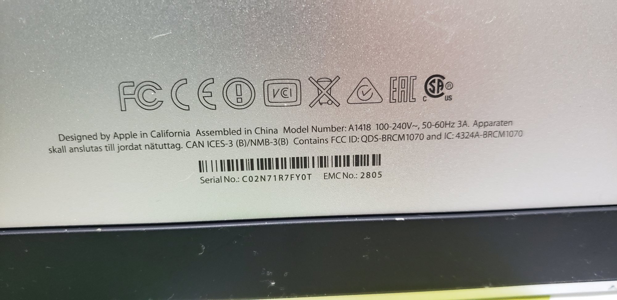

hello there, I have an older i mac i hardly used ,few months ago it started to get really slow....now I have that folder with a ? ,I did try to force reboot by press the command button and some other letter ,but all I get is a ped lock with a password window .....not sure what it means...
I guess I need a new hard drive? What do experts here think?? Here the pic with the model number hope you can see this
That is a firmware password that has been put on the machine. A new hard drive won't remove it - it is tied to the firmware chip on the logicboard.

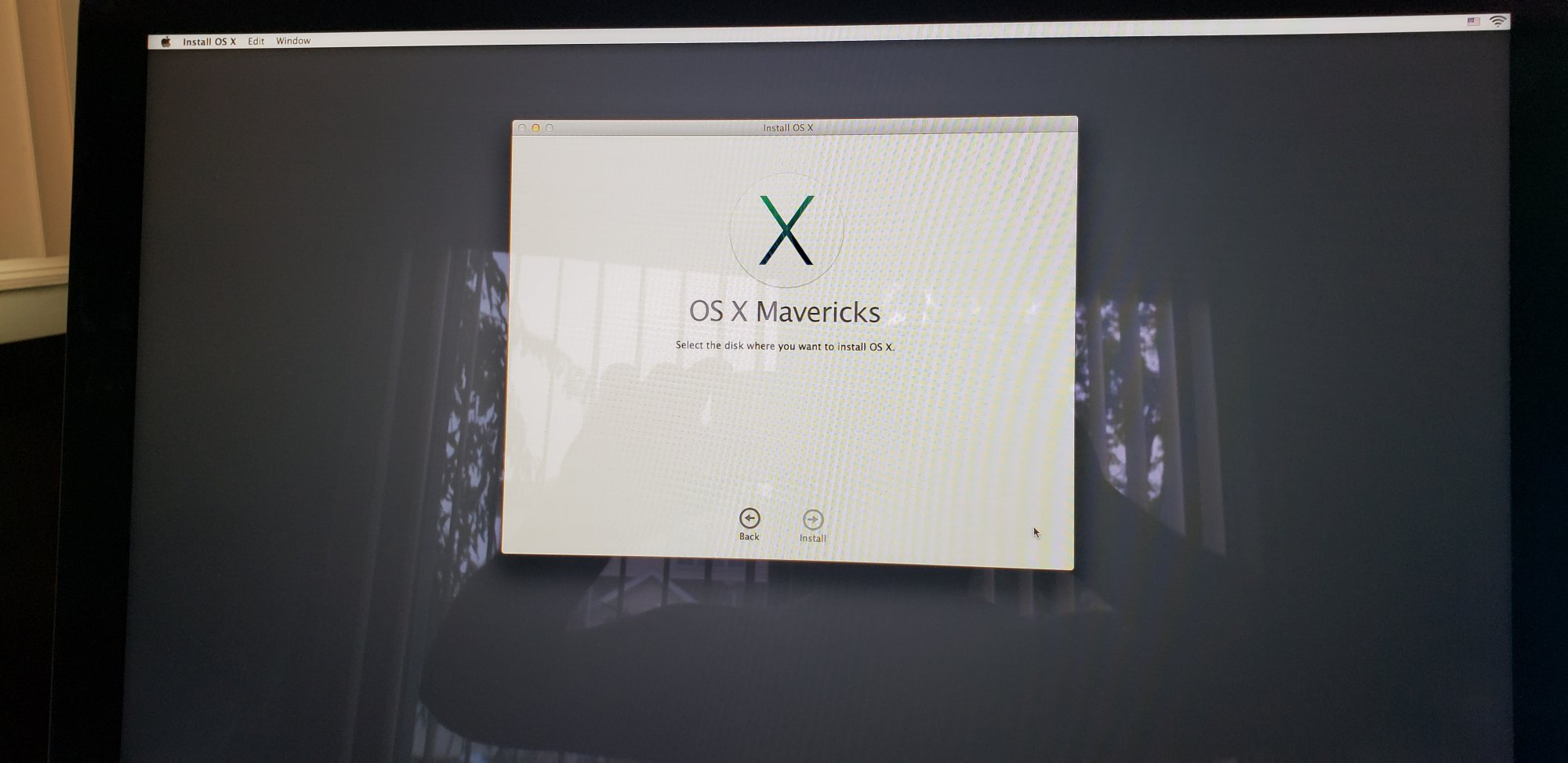

UPDATE i got the firmware password, going through the steps, internet is connected mouse and keyboard also connected when I chose to restore or install new OS X Mavericks there is no hard disk for me to select see pic

Good job on the firmware - yeah by the looks of it the hard drive is dead and would need replacing.

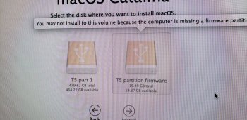

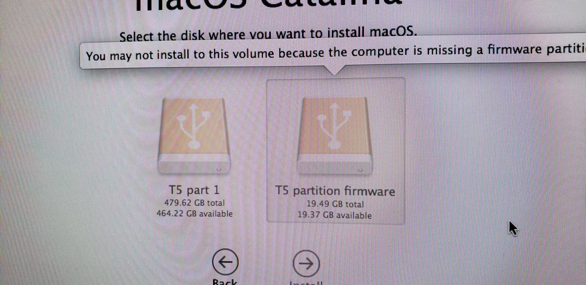

Update so I installed an external drive samsung T5,works very good, now I wanted to install mac os catalina becouse some app wont run with osx 10.9.5 ,so but I have this issue ,the mac need a partition for firmware ,i created one by following some steps found on line but it seams that the system does not see the partition that i made for the firmware partition ....see the pic ....im not sure why,please keep in mind that the internal hard drive is not lon ger working
