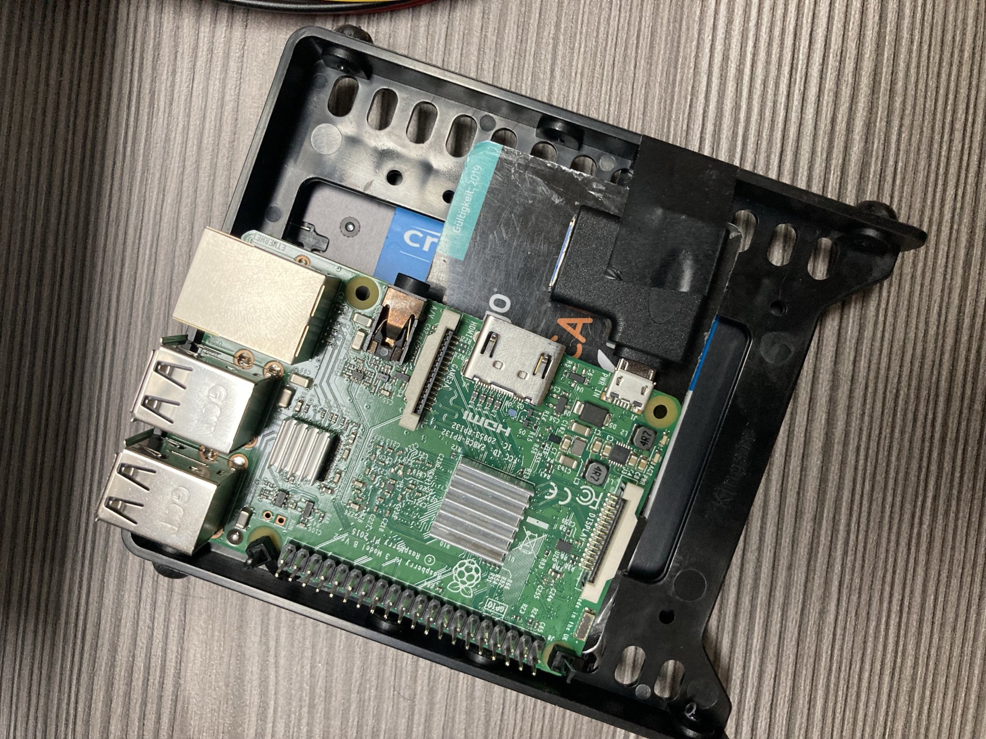

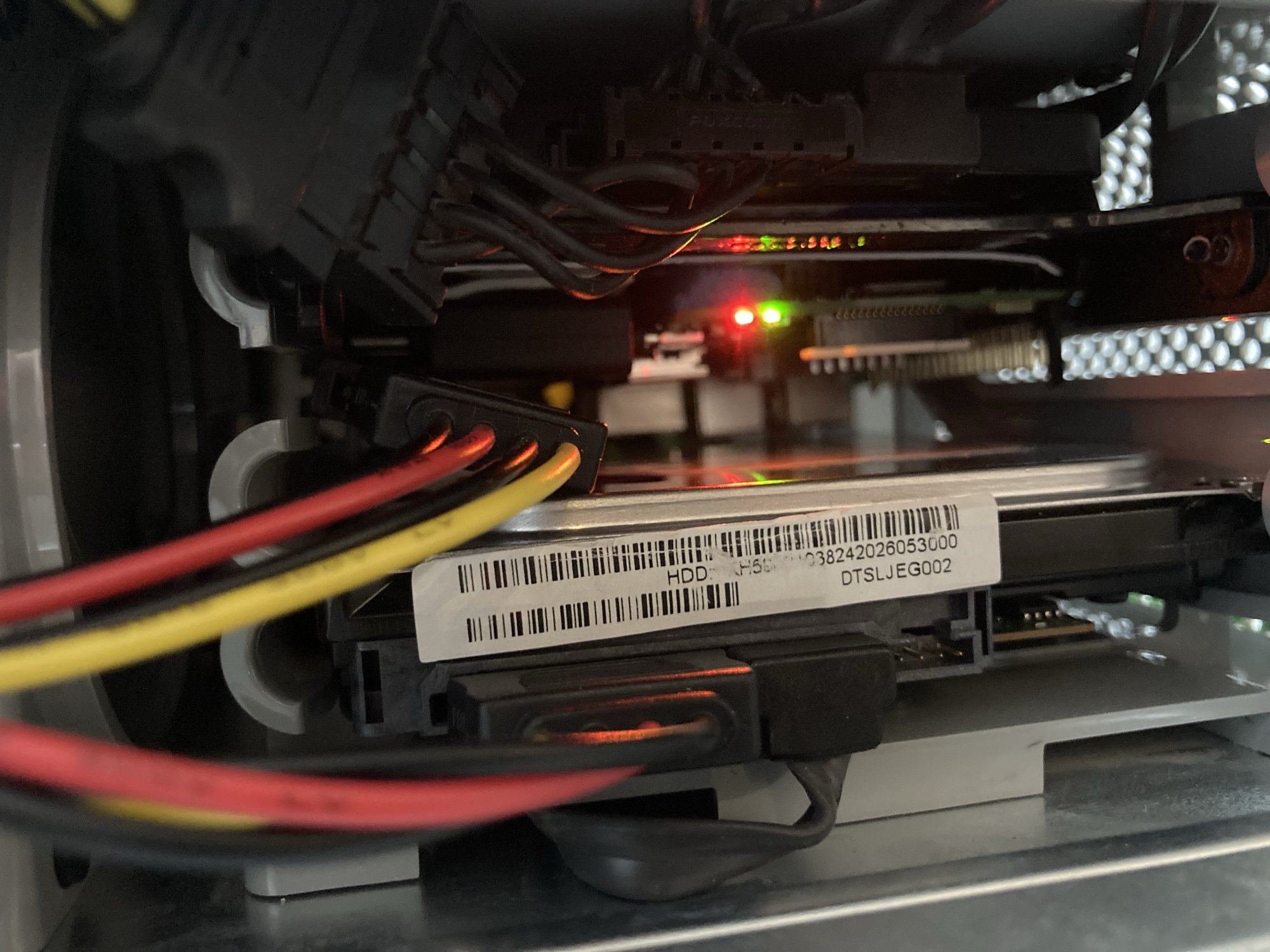

Let me explain my mad tinkering with the aid of some pictures:
Below you can see how I mounted the Raspberry Pi 3 inside the upper hard drive bay of the G5. I am using a 2x2,5" drive to 3,5" drive adapter. One side of the adapter carries the main operating system SSD, the other side carries the Raspberry Pi (I had to get creative with zip ties and tape but the mounting is pretty firm):
This is what it looks like after sliding it into the G5:

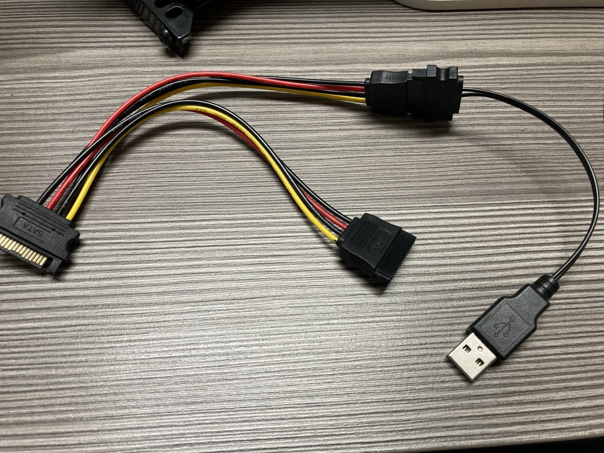

This is how the Raspberry Pi gets power:

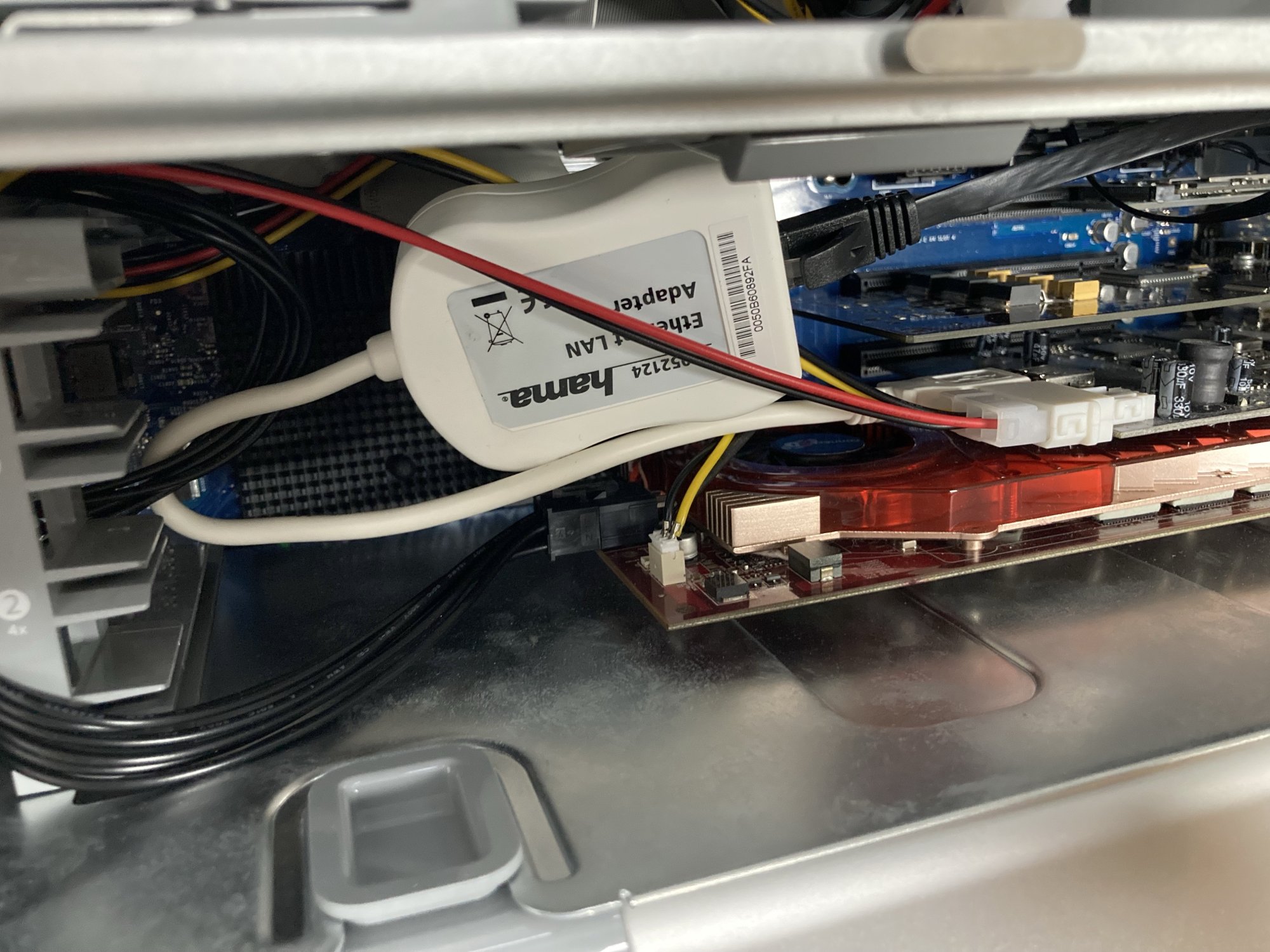

This is how the Raspberry Pi talks to the G5 and vice versa (Ethernet cable from the Raspberry Pi to a USB to Ethernet adapter plugged into the rear USB port of a PCIe USB2 card):

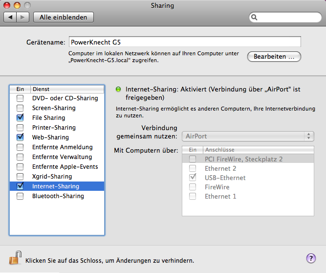

The Raspberry Pi can't get online via its own internal WiFi or Bluetooth since it is more or less enclosed in a Faraday cage. It gets the internet connection from the G5s airport antennas (in System Settings I set up Internet Sharing):

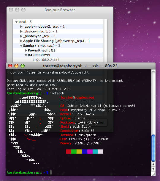

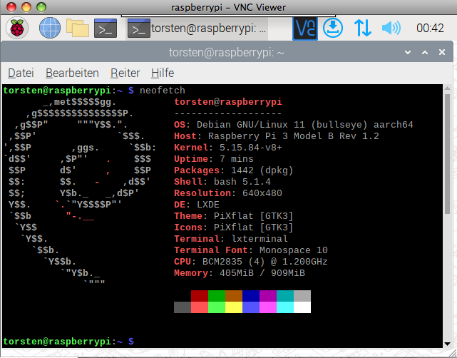

Over SSH and VNC I can still control the Raspberry Pi in case I have to reboot it or restart WRP or Browservice (which has to be done from time to time since both sporadically hang up):

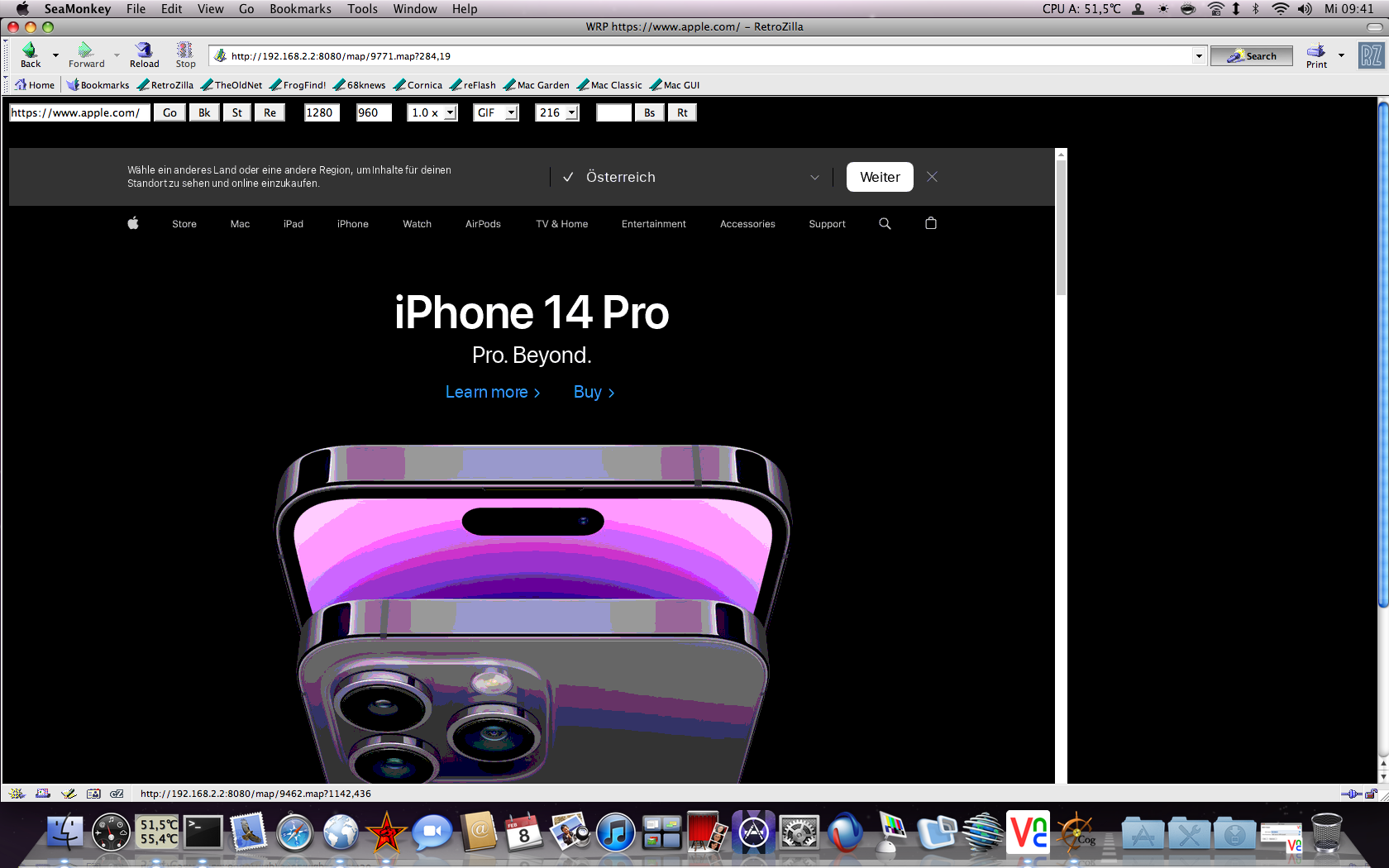

Some pictures of browsing on the G5 using both Browservice and WRP:
