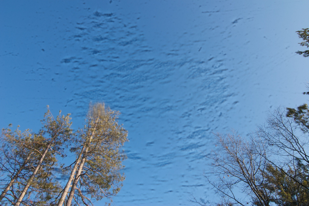

So I have been bothered by sensor dust on my Nikon D80 for a long time now, and finally decided to do something about it. Hoping that a brush from a lens cleaning kit would be sufficiently soft I put the camera in mirror lockup mode and gently brushed what I thought was the sensor behind the mirror. As I've found out later, there is actually a couple of filters on top of the sensor, but as these can not be replaced without replacing the whole sensor it does not make much of a difference. By brushing the filter it seemed like I ruined some sort of coating on top of it (the difference is visible to the naked eye), and I immediately assumed I had ruined the whole thing by scratching it. Taking a couple of test photos seemed to verify my suspicion. I have already started looking into upgrading to the d300, as replacing the sensor seems to cost around $400, but I just started thinking that the filter may not be scratched, but only dirty. What does this look like? Do you think there is any way I can fix the sensor by having it professionally cleaned, or should I suck it up and either upgrade or have the sensor replaced?
picture of the sky at f/22:
picture of the sky at f/3.5:
Wow. I would never have even put a brush, no matter the softness, against the sensor like that. You're brave. $400 to replace a sensor is less than a D300, but if you're looking to upgrade then I would think you could get a few bucks for the D80 as-is and then get that D300.
I would first try a professional cleaning. That would be the only investment I would make into the camera right now. If after that time you find this is not dirt and it is ruined by your hand then I would consider upgrading to the D300 or D300s if you care about whatever gimmick feature they added. 😉
The sensor looks like it is toast.
On a side note, at which point did you believe a lens cleaning kit was suitable for sensors? The glass on a lens, even coated, is likely to be more durable than a sensor. Invest in a proper sensor cleaning kit, I recommend this one.
Sensor brushes are certainly a viable way to go, however it doesn't look like it helped you out much in this case, and the brushes YOU used for this purpose certainly aren't designed for cleaning that delicate surface. I certainly do admire the courage it took to, without any self-education on your part, take just any old brush to the most delicate, expensive, and important part of your camera, although some might question the wisdom.
The usual cleaning paradigm when dust specs appear is blower -> brushes -> wet cleaning. Certainly your next step is wet cleaning of the sensor. While that's not a particularly difficult task if you have the right tools, given your display of expertise so far, I would recommend that you take it into a GOOD camera shop and have them clean it for you. I am not convinced, from the images you attached, that your sensor is damaged.
Hehe I know I was an idiot for using that brush, but after reading 3-4 guides on sensor-cleaning I thought the brush I had fit the description of the sensor cleaning brushes, and thought maybe it would be ok to use. However, I didn't realize how sensitive it is, and have pretty much come to terms with it being ruined. Oh well, I'll take it in for cleaning and then upgrade if the cleaning has no effect. I did have another look at the sensor and I have to say it does kind of look like fat or smudge, so I guess there's still a bit of hope. If anyone knows how photos taken with a scratched sensor look like, I would love to get a confirmation about whether or not that is what has happened to mine. Since it is the weekend there's no professionals to take it to, and I do not want to get my hopes too much up for a d300 if it really is only a bit of smudge! 😀

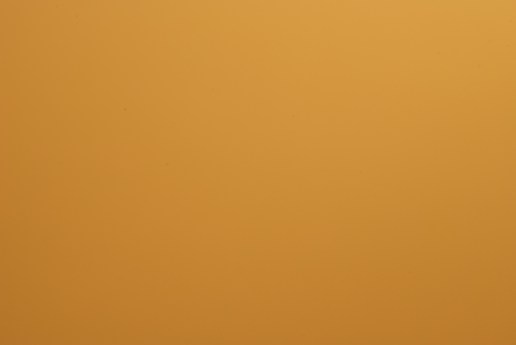

Here is another photo at f/22:

If you didn't use pressure or hard instruments, the gunk on your picture could as well be dust that has been pushed to little "heaps" or "sand dunes" on the sensor, but not taken off.

You may have scratched your AA filter, but not likely the actual sensor. I'd think a new filter could be installed since there are companies which remove them during IR conversion without having to install a new sensor. I'd check into it.

The only thing I needed to clean the dust off my sensor after extensive trips in the Greek back-country in an open-top jeep was my Arctic Butterfly. You seem to have gotten some goo from some other kind of brush on there as what you have doesn't look too much like dust. The good news is that I don't think it looks too much like scratches either as their patters are a lot more uniform and not as diffuse. Shine a flashlight on your sensor at an angle so that the whole thing looks white & it'll show up any scratches pretty obviously.

TO me, it looks like you can smeared the filter with oil, either from the brush or the lubrication inside the mirror box. It is doubtful that a brush, unless it was steel or you applied ALOT of force, would perm. damage your filter. IMHO I dont think you've messed up your sensor filter. Nikon will clean the sensor for 40ish bucks, or you could get an Eclipse/Pecpad beginner kit for 20. (and watch every video you can on how to do it.)

You definitely botched the home-cleaning job, but I too don't think any permanent damage has been done. People vastly underestimate the durability of the filters covering the sensor. It is probably a piece of glass, which will be pretty durable as it is likely coated as well for glare reduction, just like a lens. You cannot scratch it by just lightly brushing across the surface with a soft brush. A lot more effort will be needed.

Don't have time to write much, but here's a quick update: I had the sensor professionally cleaned with about 4 or 5 different liquids today. Here is the result:
There are still some specks of dust on it, but it is cleaner than when I first started this whole debacle. I'm happy, and my d80 lives on! 🙂 Thanks for all tips and support, and treat your sensors with respect!
