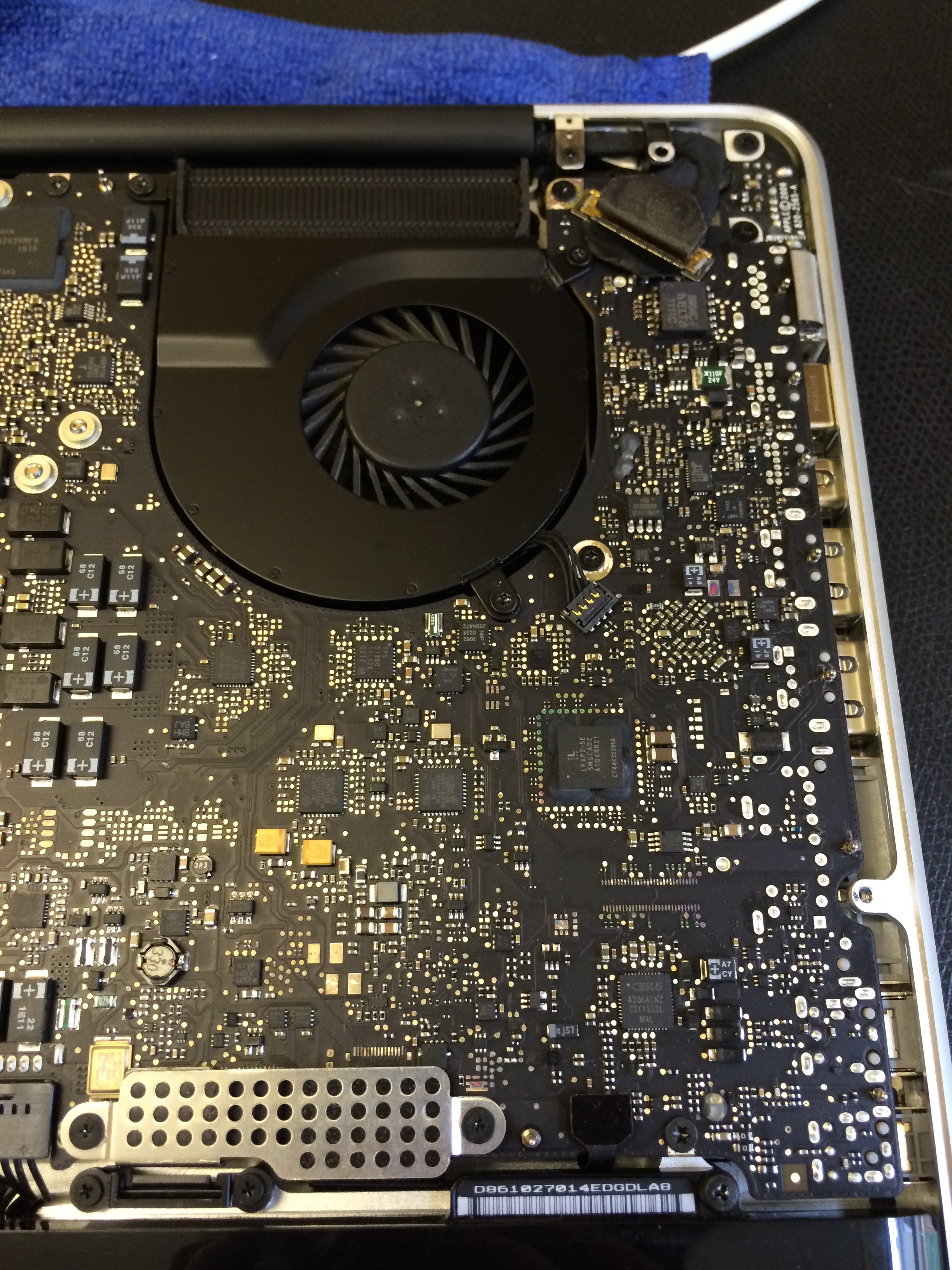

Hi guys. I wanted to replace the thermal paste in my Macbook Pro 15" Early 2011. I opened up the case as I did so many times before just to vacuum the fans.
But this time I removed the board and cleaned the CPU & GPU with Arctic Silver cleaner. Applied thermal paste neatly as described in so many YT videos.
I traced my steps back and closed the case. Now the computer runs but there's no light in the screen.
I know that it runs because I hear the boot sound, I see the fans running, I hear the click sounds when I hit volume up/down buttons and brightness up/down bottons.
So the only problem should be about the lcd screen. However, the lcd screen connecter on the lower left side of the board is neatly connected. I disconnected it and reconnected. But the problem persist. What should I do?
Thanks.

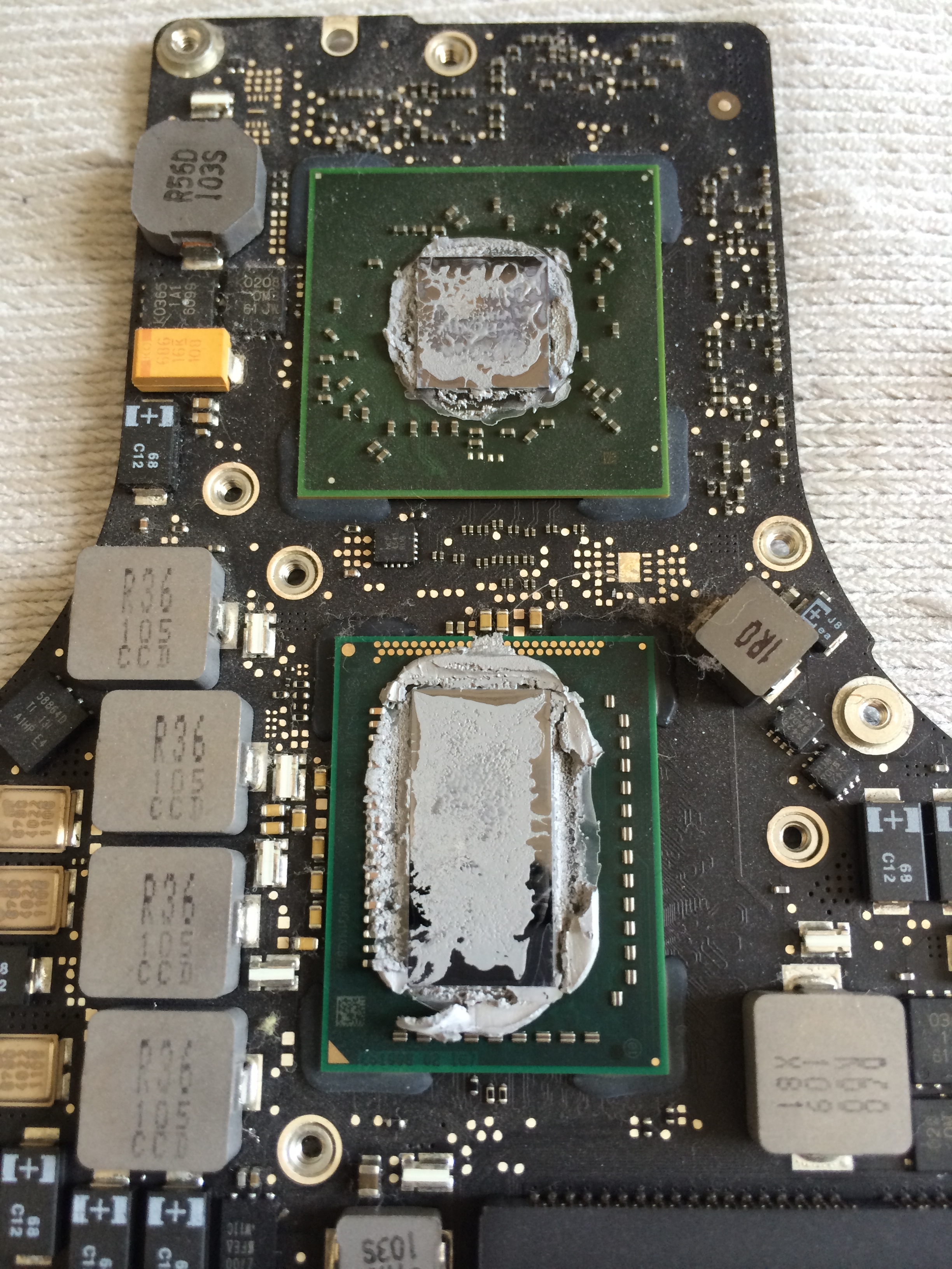

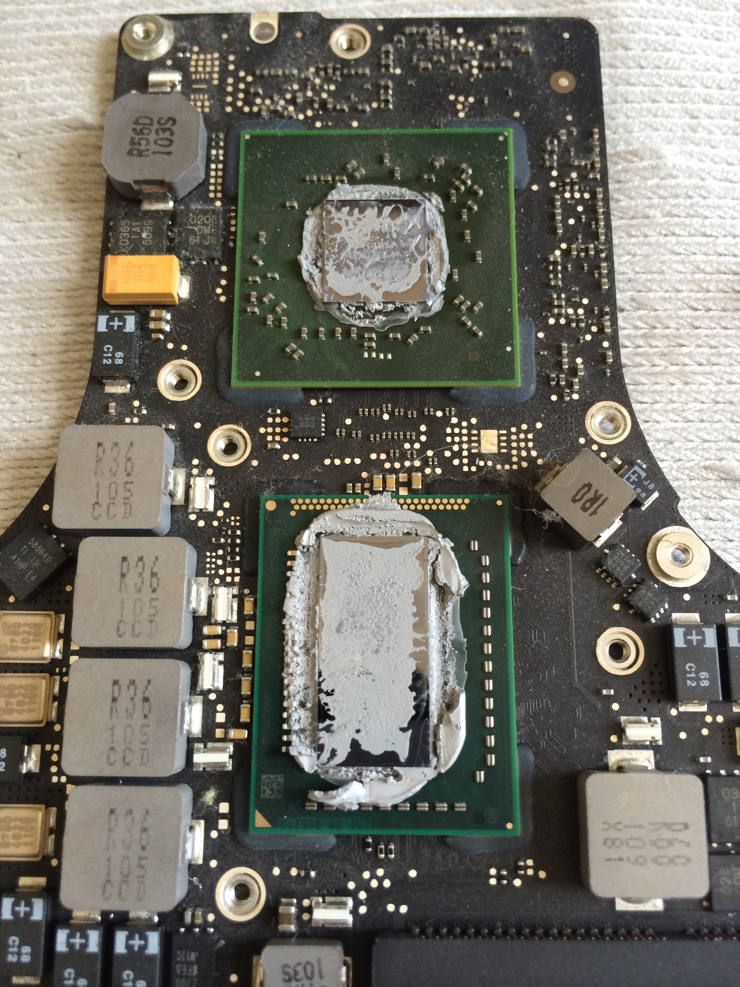

Do you know if the LVDS connector was properly seated with the clasp fully down, as in the top-right of the first picture?
Also, have a look at the pins on the connector. They're quite fragile! If any of them are broken, the only practical fix is to replace the entire display assembly. It's next to impossible to change the cable. 🙁
If it all looks fine, however, it could be a problem related to the graphics chip. Improper paste application can make it overheat (too much or too little). Many would be surprised by just how little you're meant to apply to get the best heat transfer.
I redid my thermal paste 3 times before settling on a massive improvement in thermal performance. For the final time, I used an extremely thin sliver on the CPU and a tiny drop on the GPU. Anything more turned out to be too much. I used Arctic MX-4, by the way.
Apple applied way, way too much on these models, as you can see in the second picture.
And sorry to sound so negative; I'm obviously discussing worst-case scenarios here. Hopefully it'll be fine!
Yes that's the one on the top right that I rechecked and reconnected. But I am going to check the pins throughly tonight.

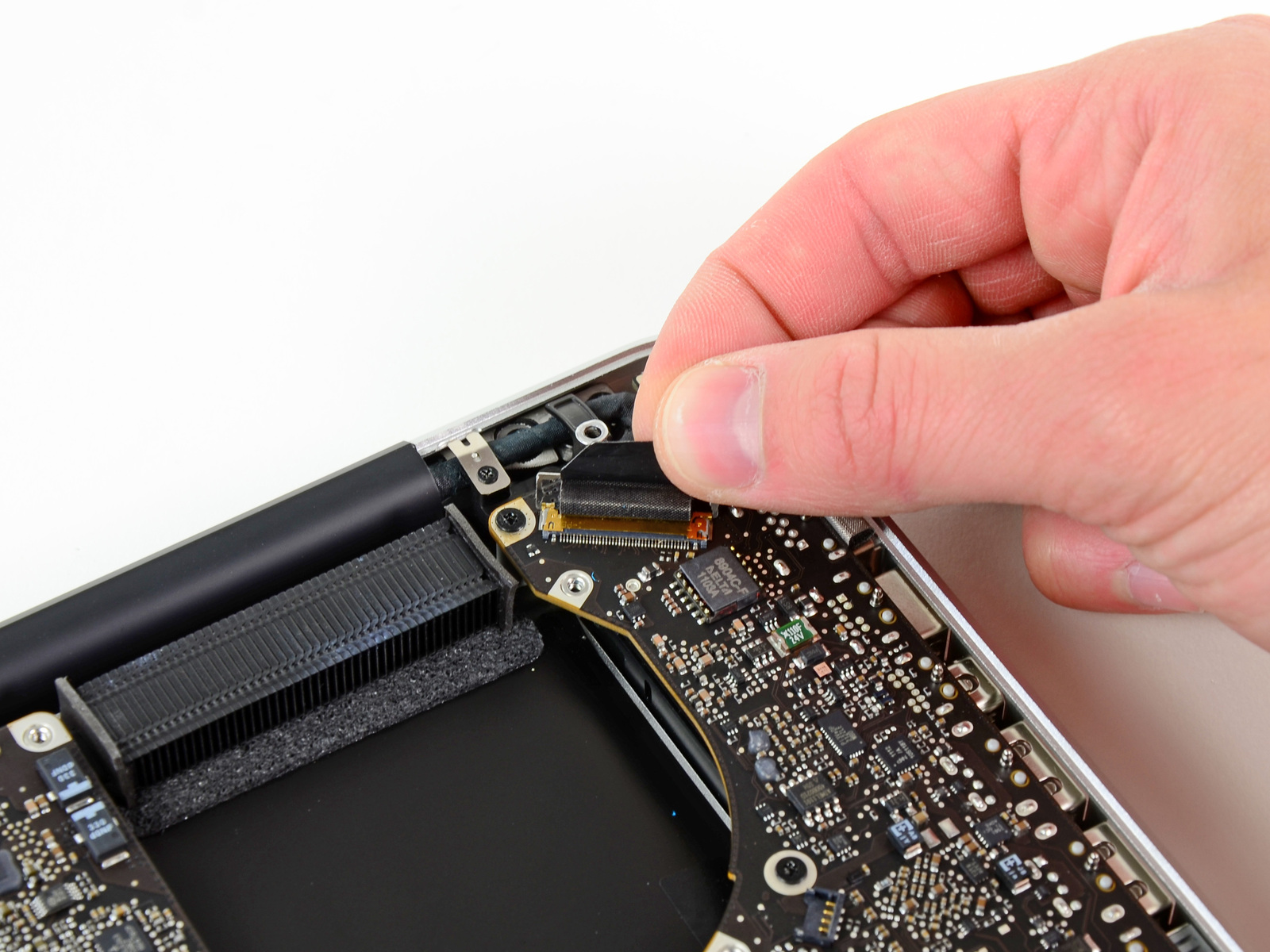

If that doesn't work, have a look to see whether the Display Data Cable is connected properly. It looks like this:
Eu5bo1CXpPLWXYQK.huge
Disconnect it carefully and reconnect it. Also, make sure that all other connections are secured properly. Follow the iFixit guide carefully in reverse order.
Let us know how you get on. I think it's just a case of a loose cable, most likely the display cable.

One thing to note, when dealing with the display data cable, make sure you handle it very carefully and follow the instructions properly as it appears to be very fragile. A slight moment of carelessness could save you bigger problems later on. Step 22 has the details on removal and it's worth having a look at the user comments for that step.
Thought it's worth pointing out before any damage is caused. 🙂

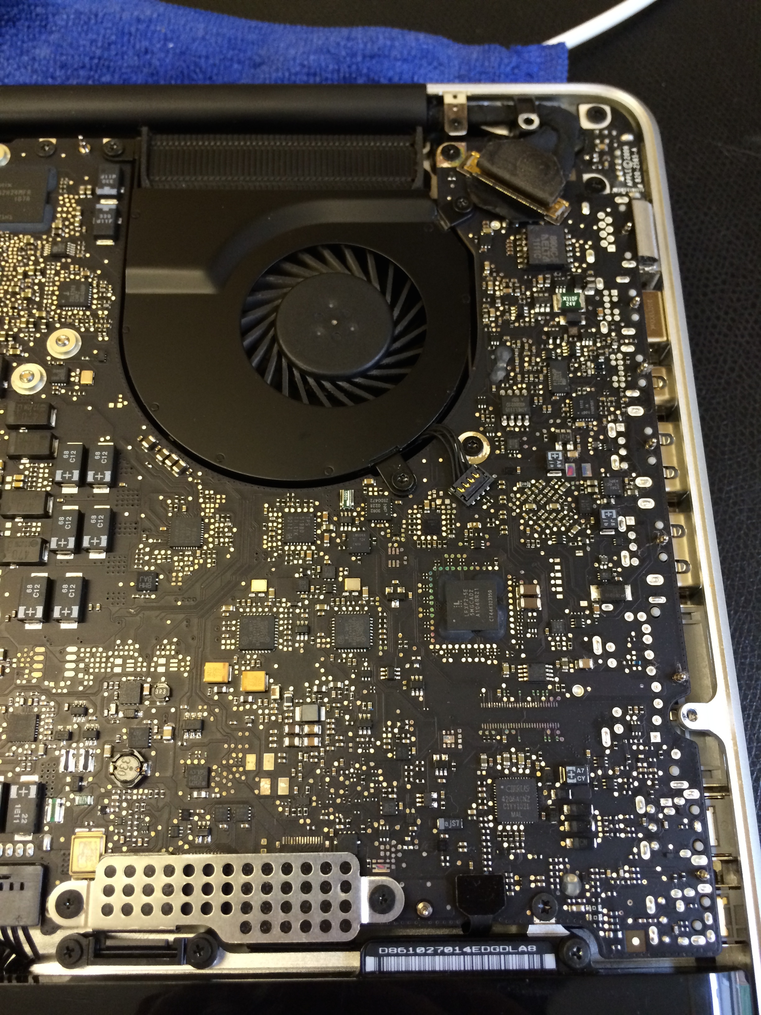

As you guys said problem is caused by the lcd connector which I aparently messed up a little. One of the tiny pins on the male side is bent and broken.
So how can i replace it with a new one? 🙂
As someone else already pointed out, the cable is very difficult to replace.
Looks like you'll need to replace the entire display assembly.

I do not believe its the cable itself that is the problem, its the connector the cable connects to on the logic board thats messed up. OP has the picture of it in his previous post. From what I read, to get this connector onto the logic board requires good soldering skill.
