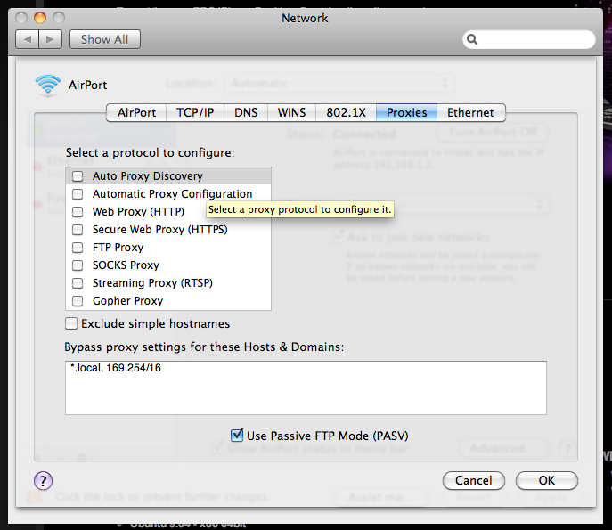

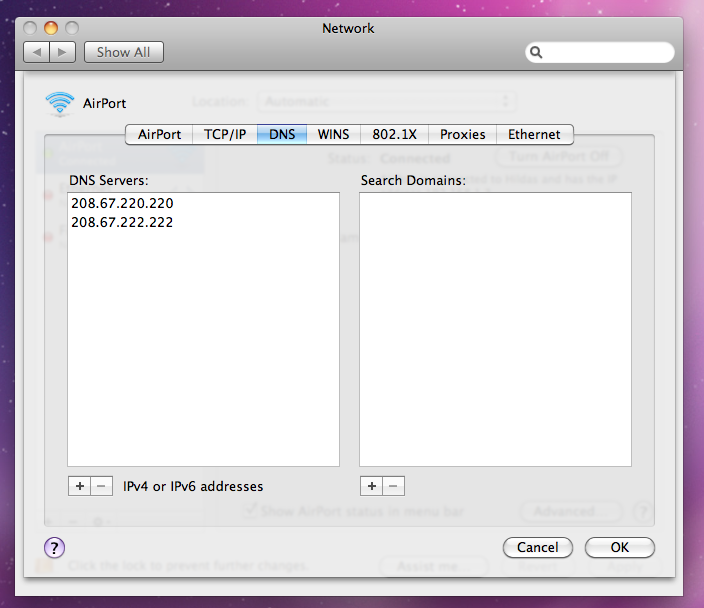

Are any of the other computers actively using the internet, downloading, streaming anything when you try to access it on the Mac? The AirPort menu will always rescan for available networks, there's nothing unusual in that process. Couple suggestions: 1) update your Mac OS and Safari, there's a chance you may be missing a component that will jump-start your web experience, 2) reset Safari via the Safari menu, make sure you empty the caches and cookies, 3) if you suspect you changed anything in the network settings for the computer that is causing this, you can create a new Network location via Network preferences, click where it says Automatic or whatnot and Edit Locations to create a new one and apply it. Something that step 3 will counteract is manually inputted DNS or proxy settings, which could artificially make the internet connection appear slower than it actually is.

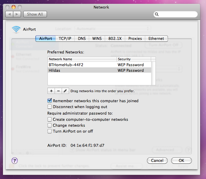

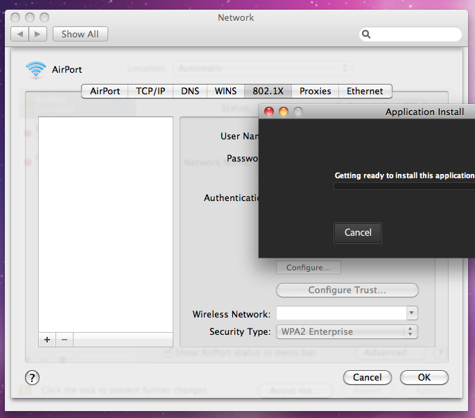

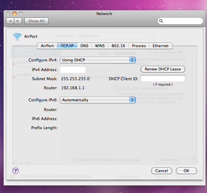

Here is a little more information!
Thanks for everyones input - I cant believe how quick everyone is to help! I did an online speed test and everything is running above the 3 Mbps (think thats right).
I hope these screenshots help.

I think I see the problem. Is the BT Home Hub your router? if it is I've read nothing but problems with these on ThinkBroadband. They are buggy beyond belief.

I would guess, at a glance, that your router is having problems interacting with your Mac. Some routers require drivers to function properly, but generally you can get by without them.

Have you tried putting in static ip / dns settings? If you cable the mac do the websites load quicker?
Also i would strongly advise ( if the router supports it) to change your wireless security from WEP to WPA/WPA2.
