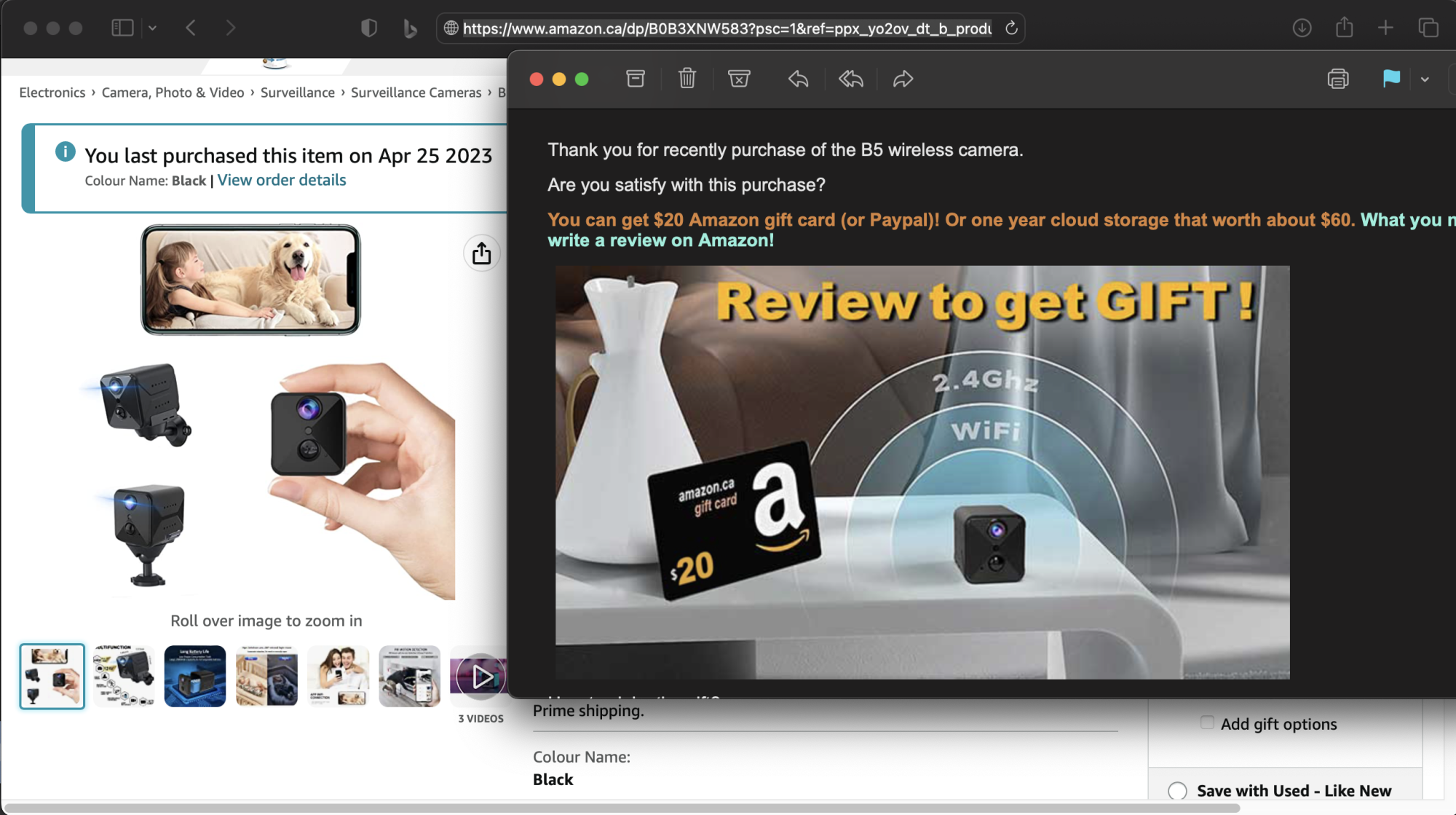

So it seems for iCloud and HomeKit indoor camera's the choices are slim pickings. I picked up a cheap camera that uses MicroSD to record and a VERY limited and expensive (after trial) camera for my apartment and I'm appalled at the weak feature set.
Having a look into iCloud storage options such as Eufy 2C is listed just $5 more on Amazon so I'll be going with this option.
What I've found shady was the explicit and incentivized request from the vendor that I purchased a tiny spy cam from Amazon sent me an email asking for a 5 star review and that a $20 Amazon gift card or 1 year camera subscription would be sent after completing such review and sent to them. wow!
So yeah I'll be looking into Eufy 2C series for indoor Camera with HomeKit and iCloud storage support. doesn't make any sense to have a camera which can be taken or destroyed during a break-in if the storage content will be unretrievable and while providing a free 128GB MicroSD card to the thief now does it? Nope.
Hoping for more solutions and wish these HomeKit security cameras can get smaller and less obvious while allowing the same build quality and feature set.
