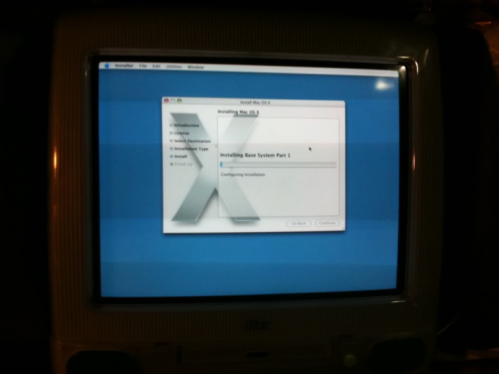

Edit: Is this a normal install screen for Xpostfacto and 10.4?
Edit 2: It has booted correctly into the 10.4 disc....
Edit 3:
I guess time means nothing to OS X:
The time keeps extending, as the installation progresses.... 😡
Now, after editing the pictures together, it is at "Installing Essentials" and estimated time: 1 hour and 27 minutes...

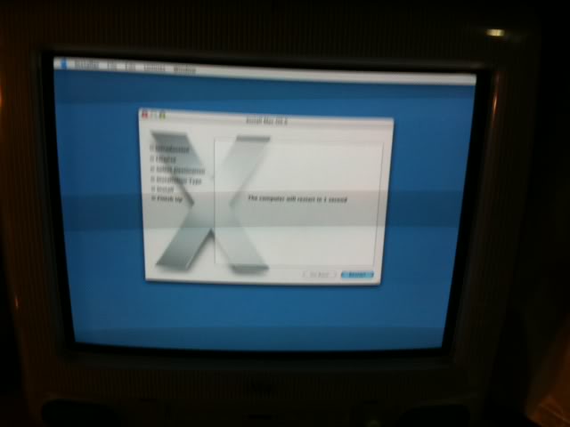

Sorry for the bad quality/bluriness. I had to take the picture really quickly... It says "This computer will restart in 1 second."
