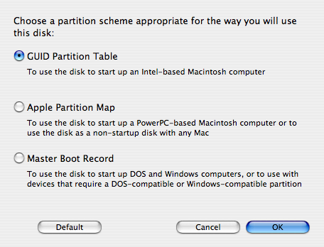

You should be able to install on either of them. But like Eldorian said, they need the GUID partition table to be bootable (they can be HFS+ formatted but not be bootable). With your install disk inserted, open Disk Utility and take a look at how they're formatted.

Either drive will work for now.
Like I said before, you need to make sure it's using the GUID partition table. It can be found in Disk Utility under Partition -> Options...

I just showed you in my previous post and attached a screenshot. Get back to us after you've checked there.
Hey thanks for your help, I've done that to my WD dive. Can I do that to my Lacioe drive on its own partition without having to empty the whole HD?

Well, for no apparent reason it decided to let me get to Disk Utility eventualy, so tahnks to your advice I'm now busy installing OSX on the WD drive formatted as suggested. It all seems to be going ok, i'll let you know what happens.
