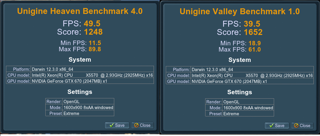

Looks about right... Here's what I get on a GTX 670.
