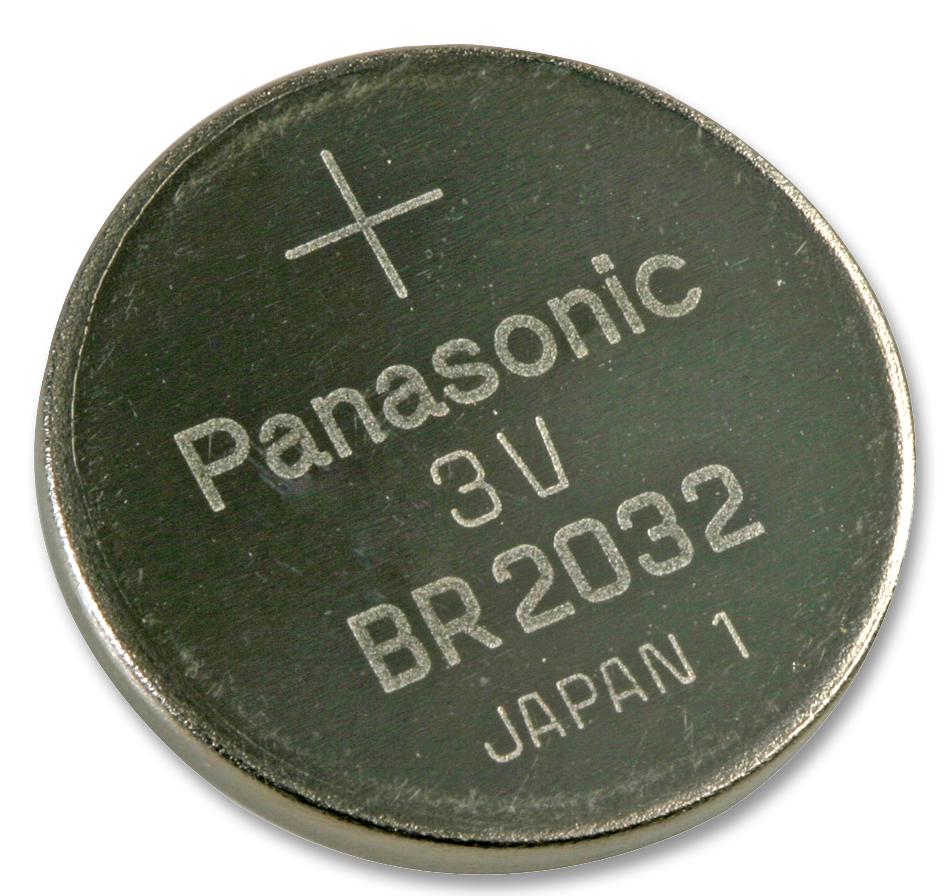

Looking at the original battery I noticed a detail, the original battery had the following written "BR2032" from the "Panasonic" brand; However, the battery I bought had "CR2032" written on it.
Researching on the internet I read that the difference is the compound with which they are made.
My question is why it does not work with a normal battery, or one that is easy to obtain like the "CR" ones since they are the same volts, 3 volts.

A CR2032 will work ! Make sure it’s a fresh unused device. Your old battery is gone south eons ago.
The current needed by the NVRAM is pretty low and the BR2032 battery type will deliver the needed current way longer - it has the ability to do this at higher temperatures.
The CR2032 will only last for 1 to may be two years depending on the usecase.

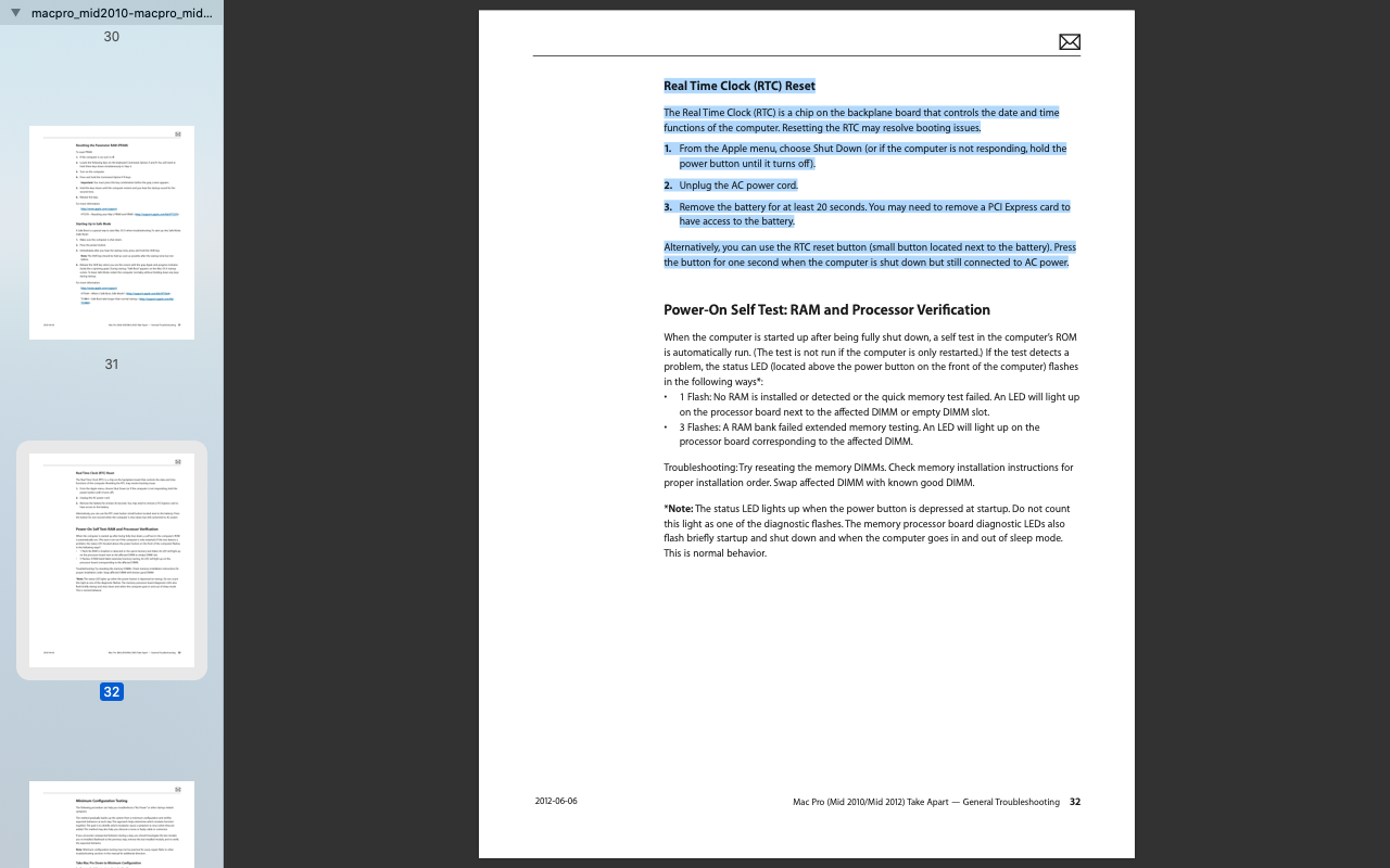

Seems you missed page 32:
Can you please make available as pdf for download?
Sorry, not allowed, more info here:
If you search enough you will find it.
