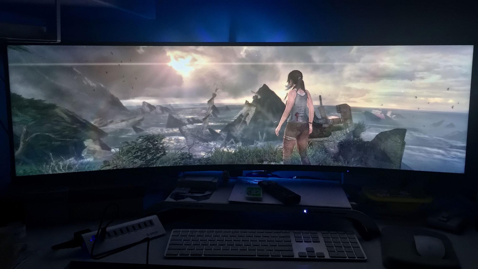

I can't see why the 7,1 can't gaming well (in macOS). Even my 2009 Mac Pro can do gaming very well.
And this is just the performance in macOS. In Windows, the same game usually can do 50% better.
If the W5700 eventually can't satisfy your gaming need, you can always upgrade the graphic card on the 7,1. It's the PCIe slots make my 2009 Mac Pro still able to game well in 2020.
P.S. the Youtube video is in 32:9 because my monitor is a 32:9 3840x1080 gaming monitor. The game was running at this double 1080P resolution (or half 4K).
