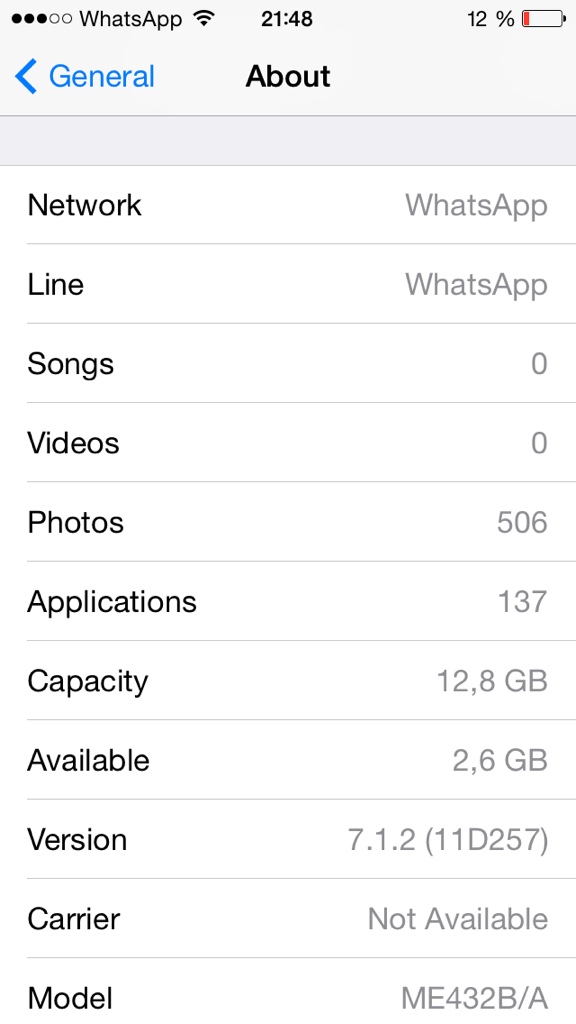

I just wanted to enable LTE functionality, but it didn't work, so decided to remove the two patches I applied. Then my problems started to appear: first I lost the carrier under settings/general/info. Now it shows "Not available"...

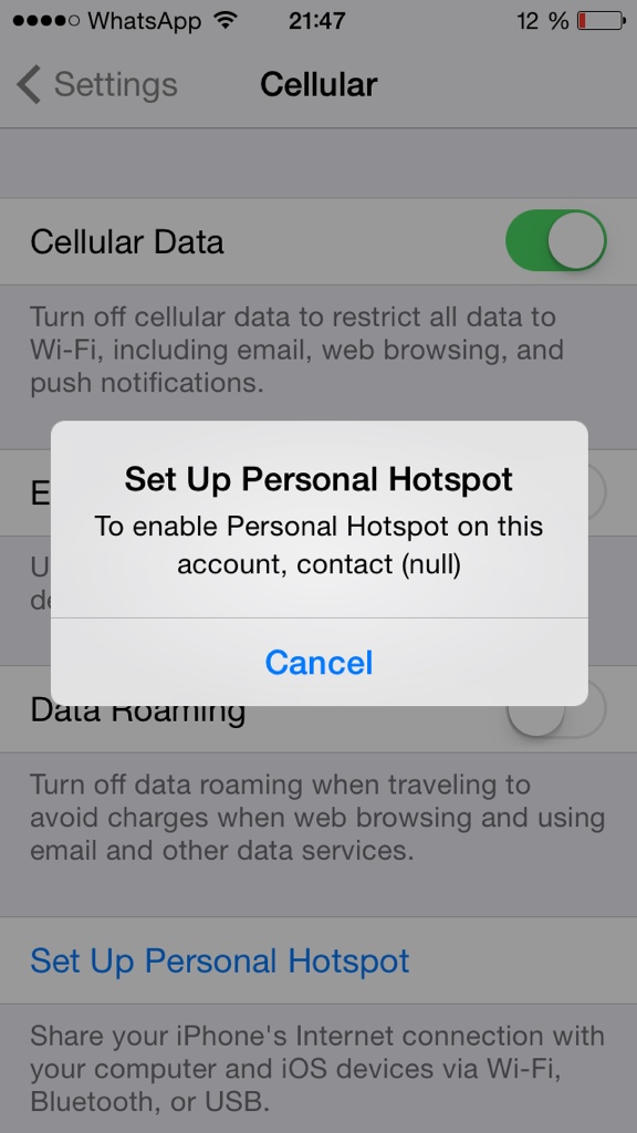

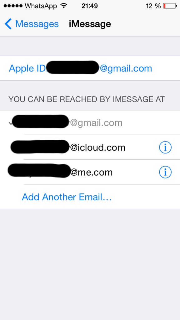

Also I lost iMessage (my phone-number disappeared as connected to iMessage and only two emails remains there).Also Personal Hotspot disappeared...
