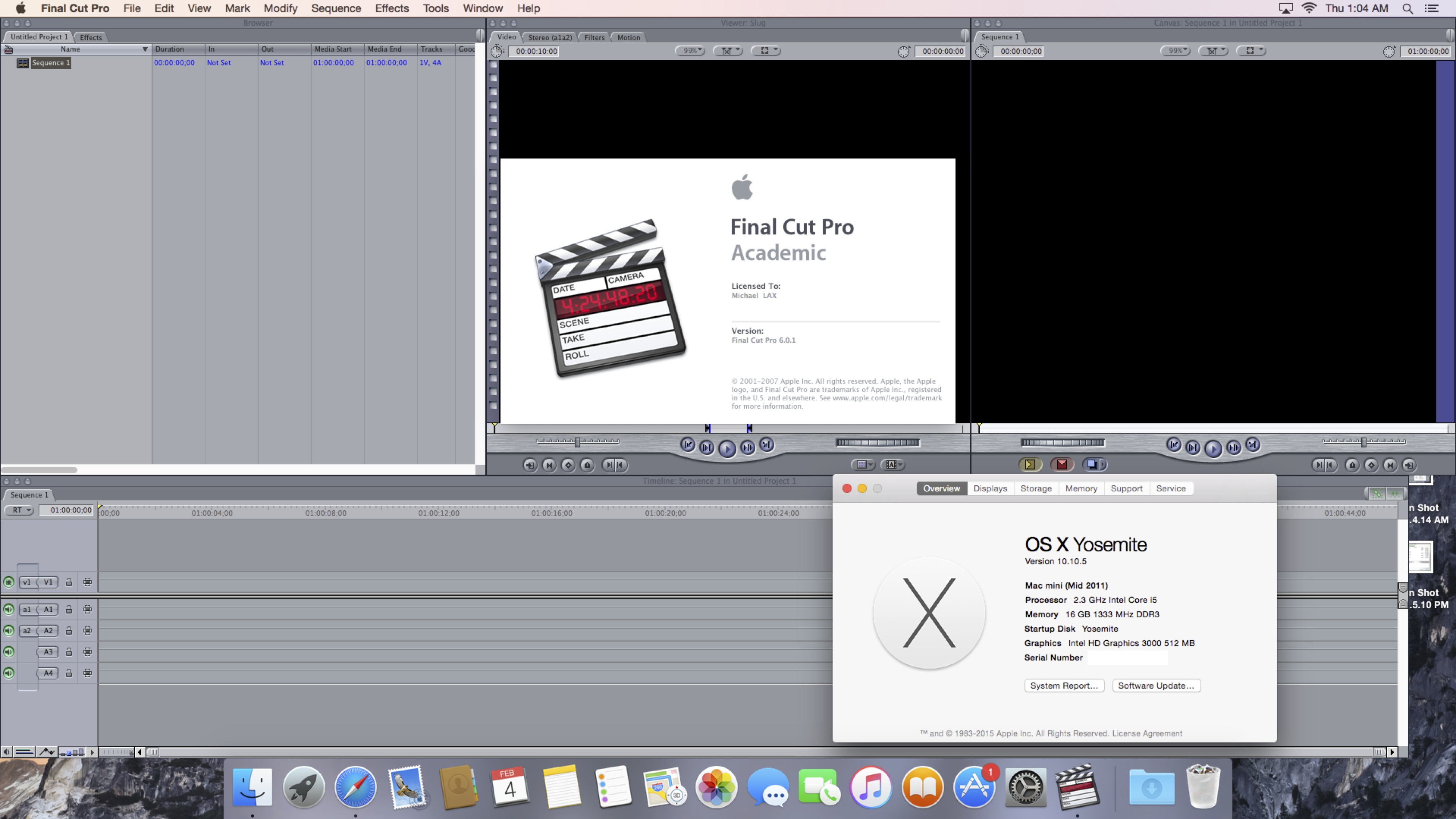

I have successfully utilized this method to install FCS2 in Yosemite (see screenshots below).

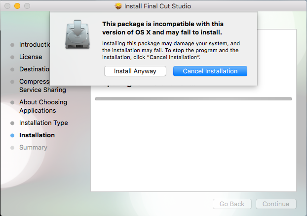

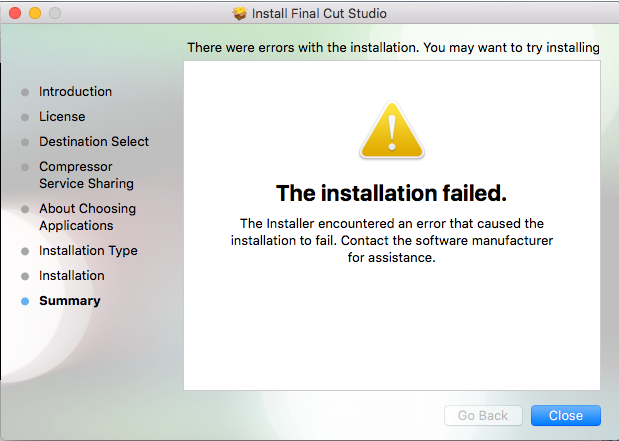

However, in my attempts to install FCS2 in El Capitan, it fails within the last 5% of installing the first DVD.

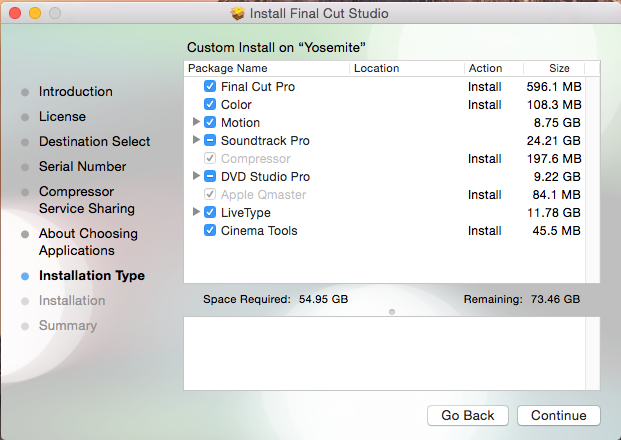

I need help in reviewing the Installer Log to determine what component it is that is causing the failure of the install and perhaps that element can be omitted from the install. If that element is not essential, then perhaps FCP6 can be successfully installed without it. And if that omitted element is needed, perhaps a manual method to install it can be determined using Pacifist.
That is my goal to help those who need to install and use FCP6 on their new Macs that run El Capitan.

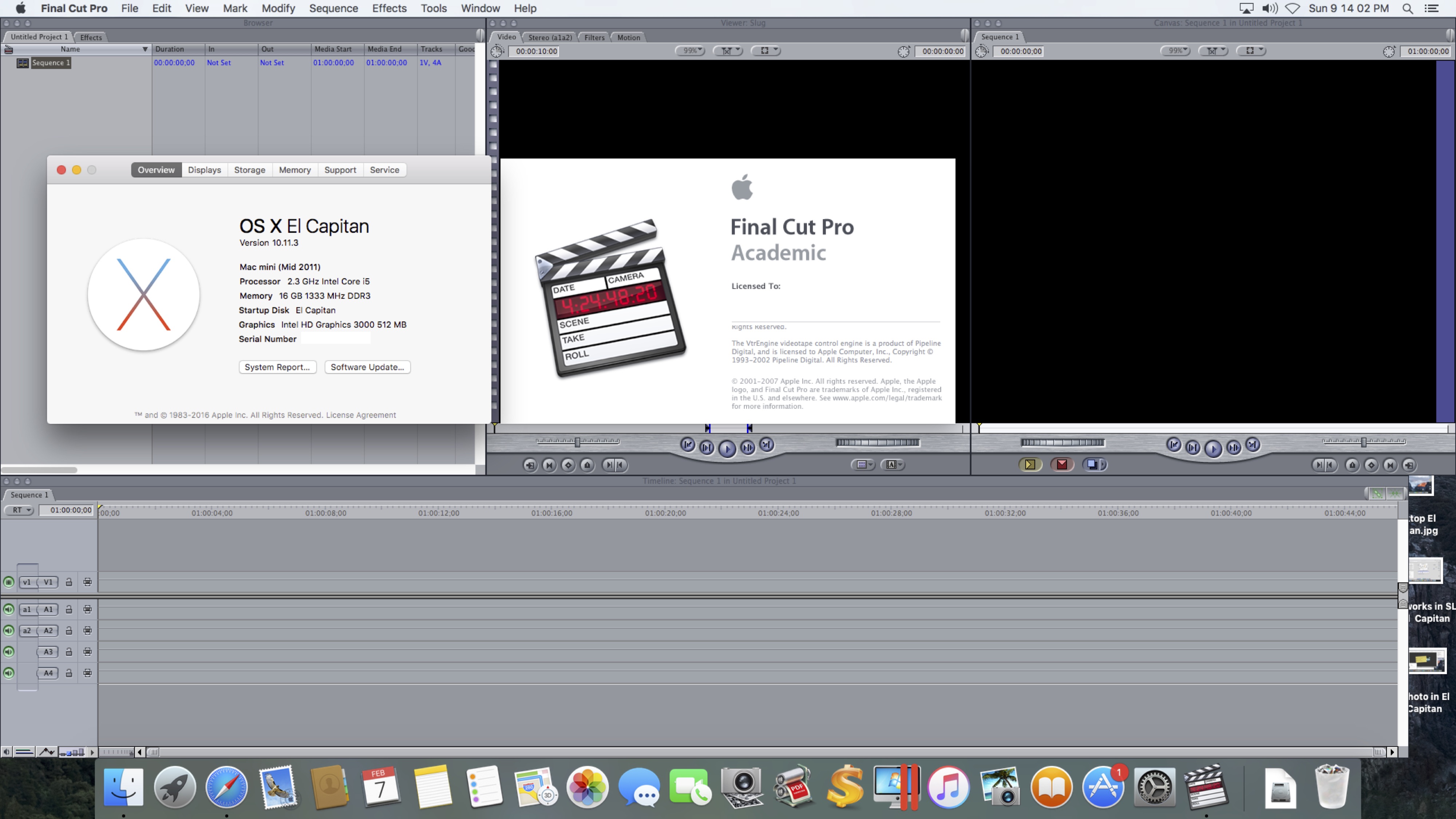

Success installing Final Cut Studio 2 (Final Cut Pro 6) in El Capitan!
EcoGreg suggested: "Did you turn off "GateKeeper" and set Allow apps downloaded from anywhere in the System Preferences>Privacy&Security Pane? You may need to temporarily turn off SIP in El Capitan."
By trying both of these suggestions, and using the HawaiianHippie method, Final Cut Studio 2 installs now in El Capitan:
Hopefully it is the easier to achieve step of turning off "GateKeeper" in System Preferences and not the more cumbersome step of turning off SIP which requires Terminal that allows Final Cut Studio 2 (Final Cut Pro 6) to be installed in El Capitan utilizing the HawaiianHippie method:
[click on image to enlarge]
