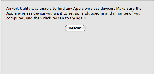

This is what I get (which is after I installed the CD on my iMac):
Connect the Airport Extreme to your Mac via ethernet then try rescanning. It should come up in Airport Utility eventually.
I tried that also, and got nothing. Can I do that without connecting the modem to the AE, just to see if it connects?

Still nothing. I did the reset, with the AE connected via ethernet cable, but I am getting that same message I posted earlier. I installed the software from the CD as well, but it just wont recognize the AE, and the AE is constantly flashing. Does the modem have to be connected to the AE in order for my MB to connect to the AE because I tried both ways, and neither worked. Do I possibly have a bad AE?
I tried hooking it up to my existing Thomson modem/router, just to see if anything would happen, and I still got the flashing light. Anyone have any suggestions?
It does sound like you have a bad AE...
