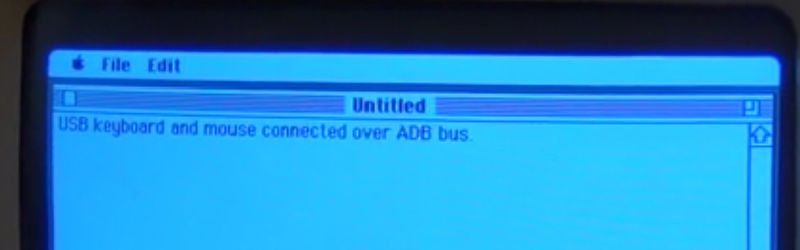

Well, this could solve my first problem, would be great if it worked with wireless keyboards with USB dongles. 😀

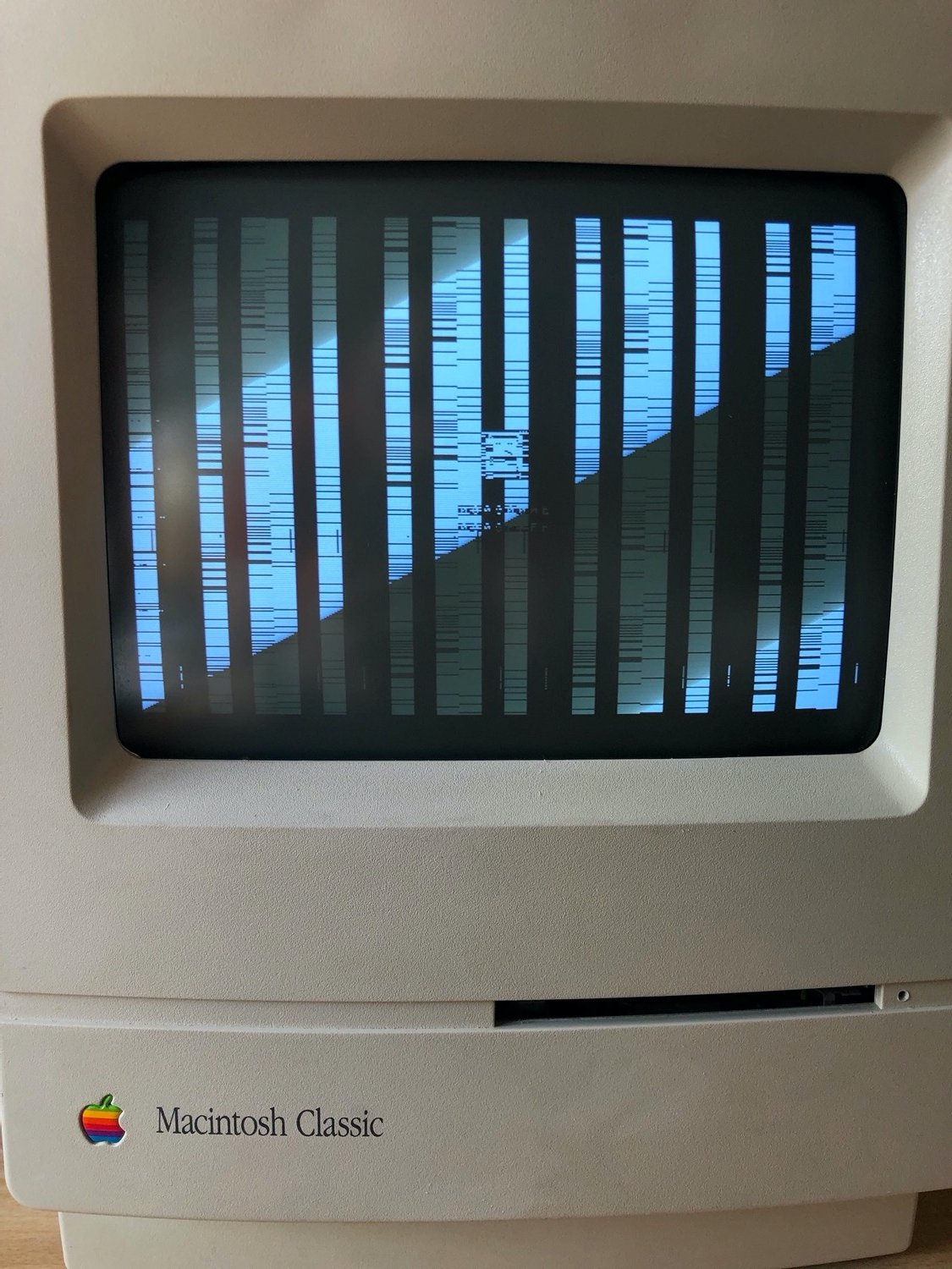

I thought I just save everything as .txt file – I guess there's something like the modern TextEdit in System 7?
  • Wow
Reactions: bobesch

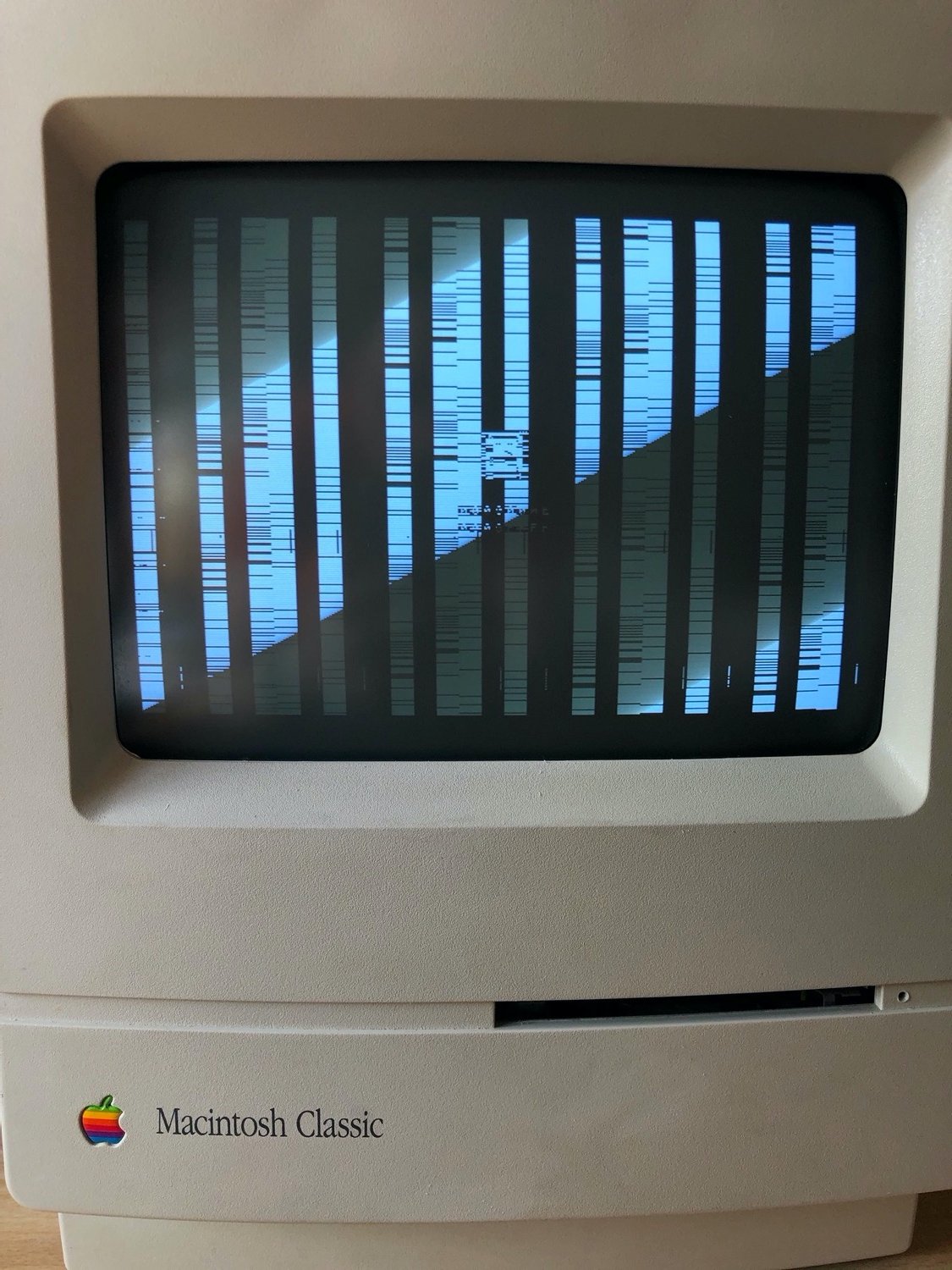

Classic with screen artifacts+sad mac=almost 100% bad caps.
Actually, I should say that I've gotten into the habit of assuming all Classics have bad caps unless proven otherwise.
As for the original question-the Apple Keyboard II is small and has nice Alps mechanical switches. With that said, I don't particularly enjoy typing on them, as they fit a full keyboard(with numeric keypad) into a small form factor and it's just too cramped to me. I much prefer the Extended/Extended II Keyboard, although it could never be accused of being small.
Reactions: weckart
Definitively needs changing the caps.
Or, you could try remove the main board, clean it in warm soapy water (carefully), leave it to dry 2 days.
Then it could maybe boot, but would be a temporary until the old caps leak again.
Do you hear the HD spinning ?
Thanks, I really hope I can do that, but since the mainboard looks super simple, I will give it a try.
The Mac is louder than I expected, and since it doesn't have a fan (?), the noise should come from the hard drive, right?
I'll try my best to get replacement parts – I don't have a ton of experience with repairing transistors, but I guess with some video tutorials I might be able to do it.

It does have a fan. Anyway if you hear a buzzing noise increasing at boot (different from a fan noise), maybe the old SCSI drive is still good.
Depending on how invasive/"redneck" you want to get, many old SCSI HDDs as installed on these computers had pins at the front for an access light.
If you have one laying around, it can be very useful for diagnostic purposes to see if the computer is poking the HDD at all, although when it boots to a sad mac there's likely not much if any drive activity. In my experience, the HDD in a Classic is USUALLY good(one of the few parts that is).
The numbers/letters under the Sad Mac are actually a hexidecimal error code that you can record and look up, but with failing caps it's not really that useful as it will generally throw a different one every time. The screen artifacts are tell-tale also of bad caps.
It's worth a peak inside also as I've seen more than my fair share that had its battery explode and cause a lot more damage to the board than caps ever will. Leaky cap damage is often repairable, while battery damage usually means that the board is trash, or at least on something like a Classic.

Soo ... just ordered a whole bunch of stuff, including an iFixit Pro Tech Toolkit, some floppy disks, an external floppy drive and the USB-ADB-adapter. I really hope I can get that thing to work.
As for the hard drive – I'm not totally sure if it eve has one (they did sell a model without a hard drive after all), and I seriously don't know how to use a computer that doesn't have a hard drive, but we'll see.
