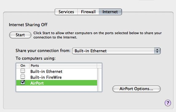

I think this might work
I think you can broadcast the signal from the PowerMac by opening the System Preference and then clicking on the Sharing tab. When the sharing section is open, click on the Internet tab. You want to share connection from Ethernet to computers using Airport. When you choose the right settings, click the Start button to start sharing. Click on Airport Options and set a password for security purposes. That might do it.
thanks for the suggestion. I have tried that though with no luck.
bill
This basically sets up your PowerMac to act like a base station. Using your PowerBook, you need to connect to that "base station". It'll either show up or you'll have to type in the IP address of the PowerMac to connecto it. It should work.
