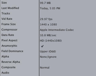

So i know that I shot my video at 30F. So there is no way that I can make this look a bit less home video look? I got the info on my video...here a pic i took of the info.. if im reading this correctly its at 30 f,...well the 29.97 it says

What I was saying is the "home video" look is caused by recording in a 30 frame per second, interleaved (even lines, then odd lines) instead of a 24 frame per second progressive (even lines and odd lines together) format.
Film look formats include 480-30p, 480-24p, 720-30p, 720-24p, 1080-30p, 1080-24p.
This is an example of interleaved fields. What causes the home video look.
If you see these lines in FCE then your picture is in 60i format.
In which case you will need a "film look for video" filter.
It looks like you shot in the 1080i mode.
