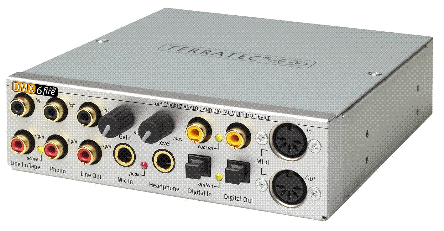

Several years ago, I built a Windows "Shuttle" computer that included a Terratec audio input device that took up a 5.5" slot. It had all the right software included and worked very well with the turntable I had purchased. This was not for me but for my father. Sadly Terratec doesn't make this computer audio item anymore. (Attached via cable to a card internally.)
What I suggest is your take a look at this link to provide a bit of clarity. https://www.digitaltrends.com/home-theater/how-to-convert-vinyl-to-digital/
