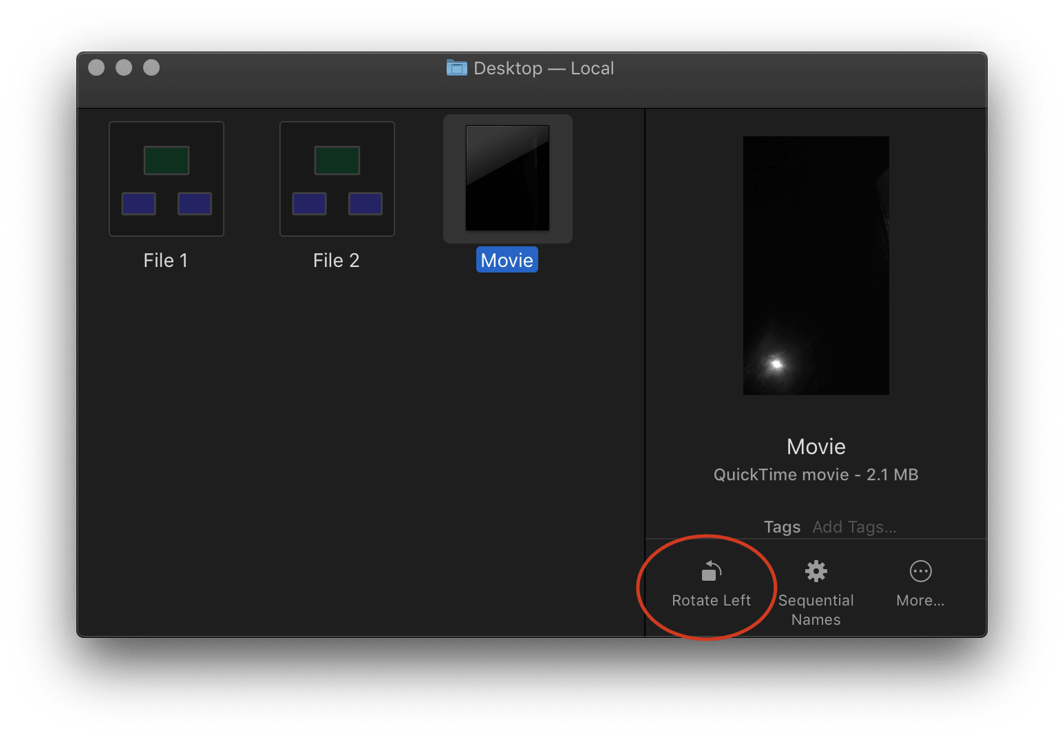

iRock1 – I don't know whether this still matters to you, but rotating movie files is built into the Finder in macOS Mojave. I'm not sure whether it works with every single movie file, but when it does work, the file size appears unchanged and the process is practically instantaneous.
