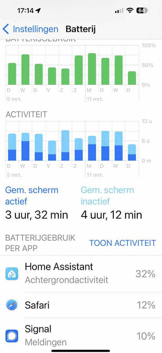

Thanks all for your input. There will always be different views re battery management and I accept that. The big question is if battery health drops can be caused by particular app behaviour.
Over the past weeks I noticed that I sometimes needed to charge my 14PM twice a day. This is a distinct change.
A major change since January is that I started using the Home Assistant companion app. While reviewing battery consumption stats this app has been eating battery charge continuously, because by default it reports sensors and gps location. I immediately disabled all of those.
Then I installed the same app with defaults on my work phone (iPhone SE3) to see what will happen. That phone is now at 99% battery health.

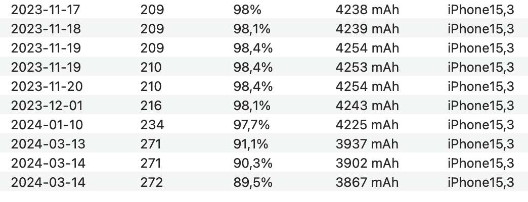

How many cycles?
Honestly, if these numbers are correct, this battery appears to be in a free fall

This is the 10 day energy usage graph and the top consuming apps. Home Assistant is up there doing much more than I actually use it.
I suppose if it keeps going like that you might be eligible for free battery replacement :(

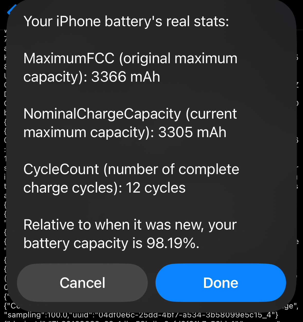

The battery states 100% even though it made be more than 100%. It could have gone from 105% to 98% the first year, and now from 95% to 91%.
This explains why many people can get maybe closer to one years with 100% BH. Many iPhones coming from the factory with more battery capacity mah than stated and iOS works off the min specced battery mah. This is giving more headroom and extra capacity before iOS starts showing the drop from 100% BH.
Eg… here’s my 15 Pro real battery stats from analytics. The original max capacity is higher than the supposedly 3274mah rated from factory (online sources) @ 3366mah and the BH is already dropping based on these numbers.
However battery health in iOS settings will stay at 100% until this drops below 3274mah.
Reactions: OSXphoto and Tsepz
