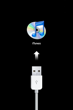

Hi thanks for the response. I did actually try both of these suggestions. I could get the phone into DFU mode and it seemed as though it was installing, after the phone rebooted itself though it was back on the emergency screen, I also tried using a different MacBook and then even tried on a Windows XP machine. Still at this point no luck. Cannot restore to 3.0 via iTunes.
This is the screen that I'm getting BUT it also has 'Slide for emergency' at the bottom!

I just tried to do a stock restore on an XP machine too. I'm still getting the connect to iTunes and slide for emergency weird combo screen. It also has a battery indicator and a lock symbol at the top. I forgot to mention that earlier. Not sure if it's going to mean anything to anyone. It's like it's stuck between two phases.
that is screen isnt that weird is it? i got it with both my used phones when it didnt recognize the sim and wanted to activate...
