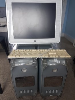

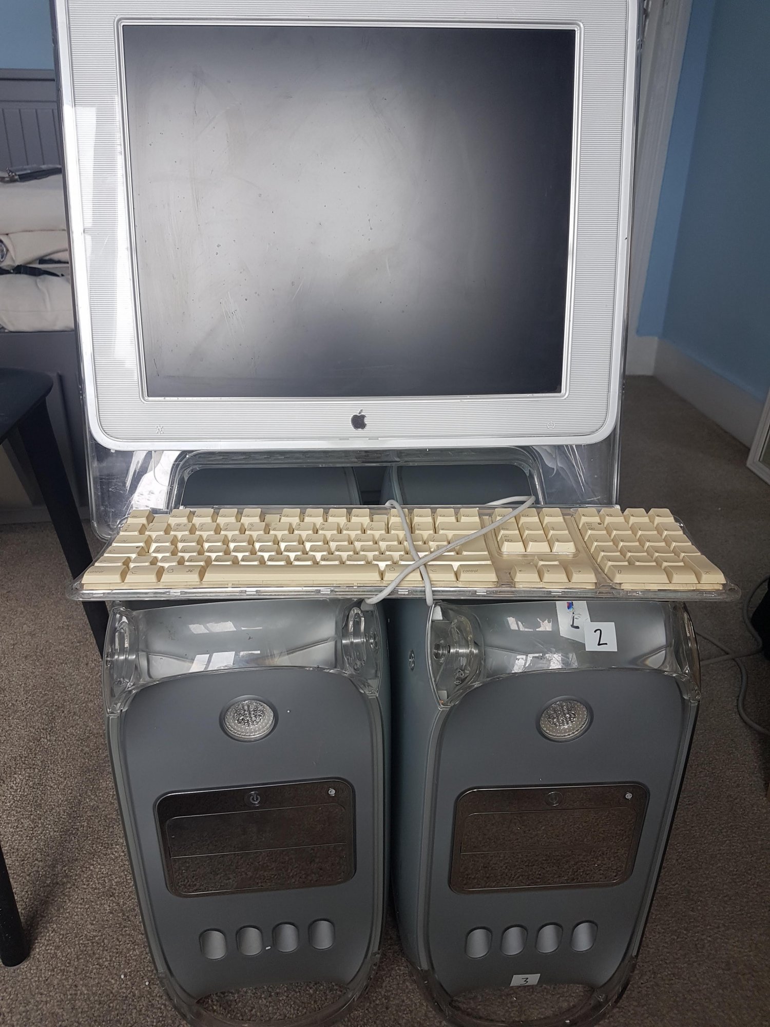

My PowerMacs have arrived!
EDIT: Man these machines are loud!!

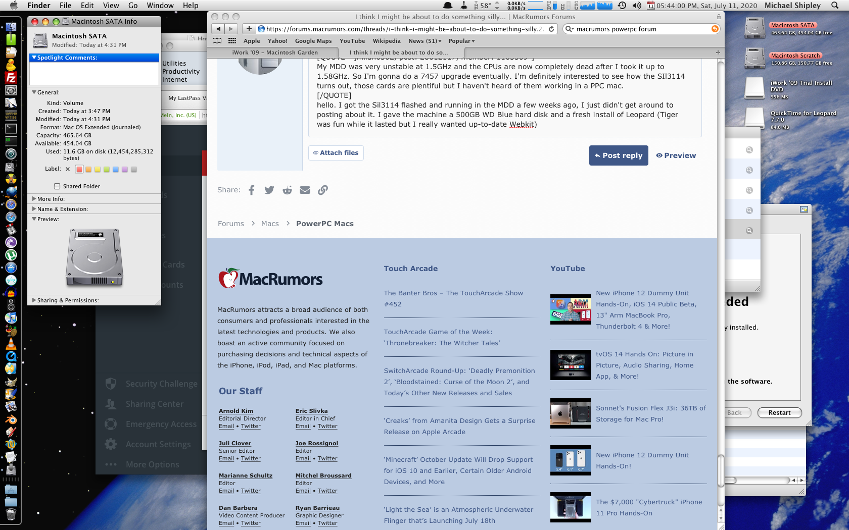

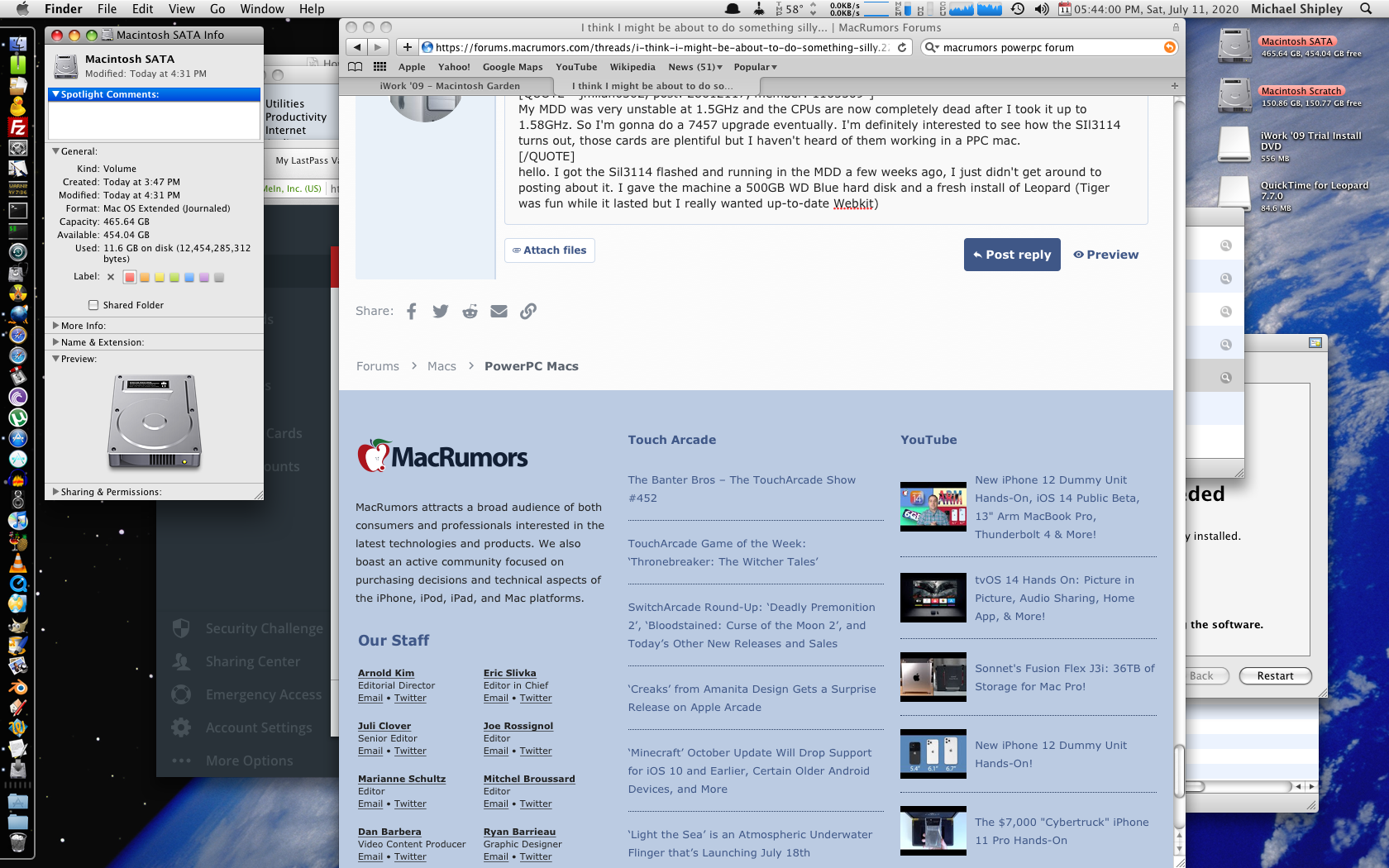

hello. I got the Sil3114 flashed and running in the MDD a few weeks ago, I just didn't get around to posting about it. I gave the machine a 500GB WD Blue hard disk and a fresh install of Leopard (Tiger was fun while it lasted but I really wanted up-to-date Webkit)
It actually runs just as fast or faster than the old PATA drive, despite what I've heard about the Sil3114 supposedly being a slow chip.
How did you go about flashing it? I wonder if it's possible to get a Sil3124 working in an MDD but I'm not sure if it could take advantage of the 64bit PCI slot as it's a PCI-X card which came later and was in some G5s that used the same connector as 64bit PCI. Of course that's provided you can even find a Sil3124 card they seem to be rather rare.
there's a post on this forum that provides a firmware dump that can be flashed with flashrom under FreeDOS. I'm pretty sure the firmware dump is just taken from the Firmtek Sil3112 cards, as the card shows up as a Sil3112 in the Mac OS X system profiler.

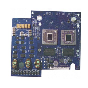

And here I am, now with my own MDD, a 1.25 ghz single cpu, and what I've noticed is that there seem to be quite a few stores that sell parts for it. Parts such as cpu daughtercards, from the look of things. Including ones for the 1.42 ghz dual. Now, I have no idea how good these shops actually are, and my aim is to make the best OS 9 capable Mac I can, which means my graphics card upgrade is a little more limited, but it certainly sounds like I'm thinking about taking my MDD down a similar "silly" path that you were thinking about.
Because the thing of it is, it looks like cpu daughtercard swapping is really limited to bus speed, and if you're starting out with a 1ghz model, you're already at the faster of the two possible bus speeds, meaning a 1.42 ghz upgrade should be possible. The real limiting factor is getting a copper heatsink for it, and those seem to be things you can buy at the same sorts of stores.
Again, no idea how good or valid these are, but I'm not use to a 17 year old computer having parts I can just buy at a shop. These are pretty much the best deals I could find, btw, there seems to be a whole host of shops that still sell this stuff, parted out.

@repairedCheese Yikes... That dual CPU daughtercard is way overpriced, and in my opinion not worth it at all for a nearly decade old machine. Heatsink is not much better, either.
You can do whatever you want, but I'd rather see if anyone here happens to have any spare ones lying around instead.
Reactions: Amethyst1

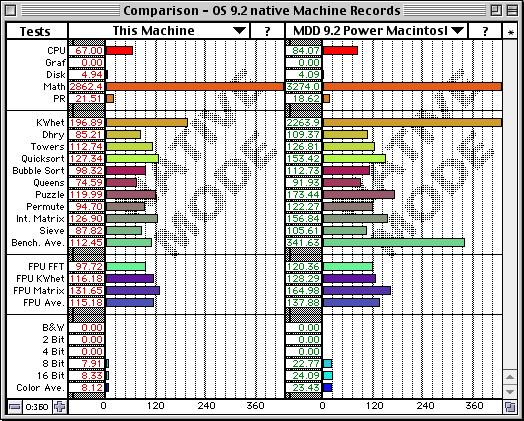

And speaking of testing, I thought I might through in a little benchmark. I haven't exactly had much of a need for Speedometer 4.02 since I stopped running Basilisk II on single core machines, but this version does have native PPC support making it perfect for my needs.
"This Machine" is the same 1.25 ghz MDD running the same test under 10.4 Classic. I can't say i fully understand the test myself, but I've always found the test useful for doing comparisons.

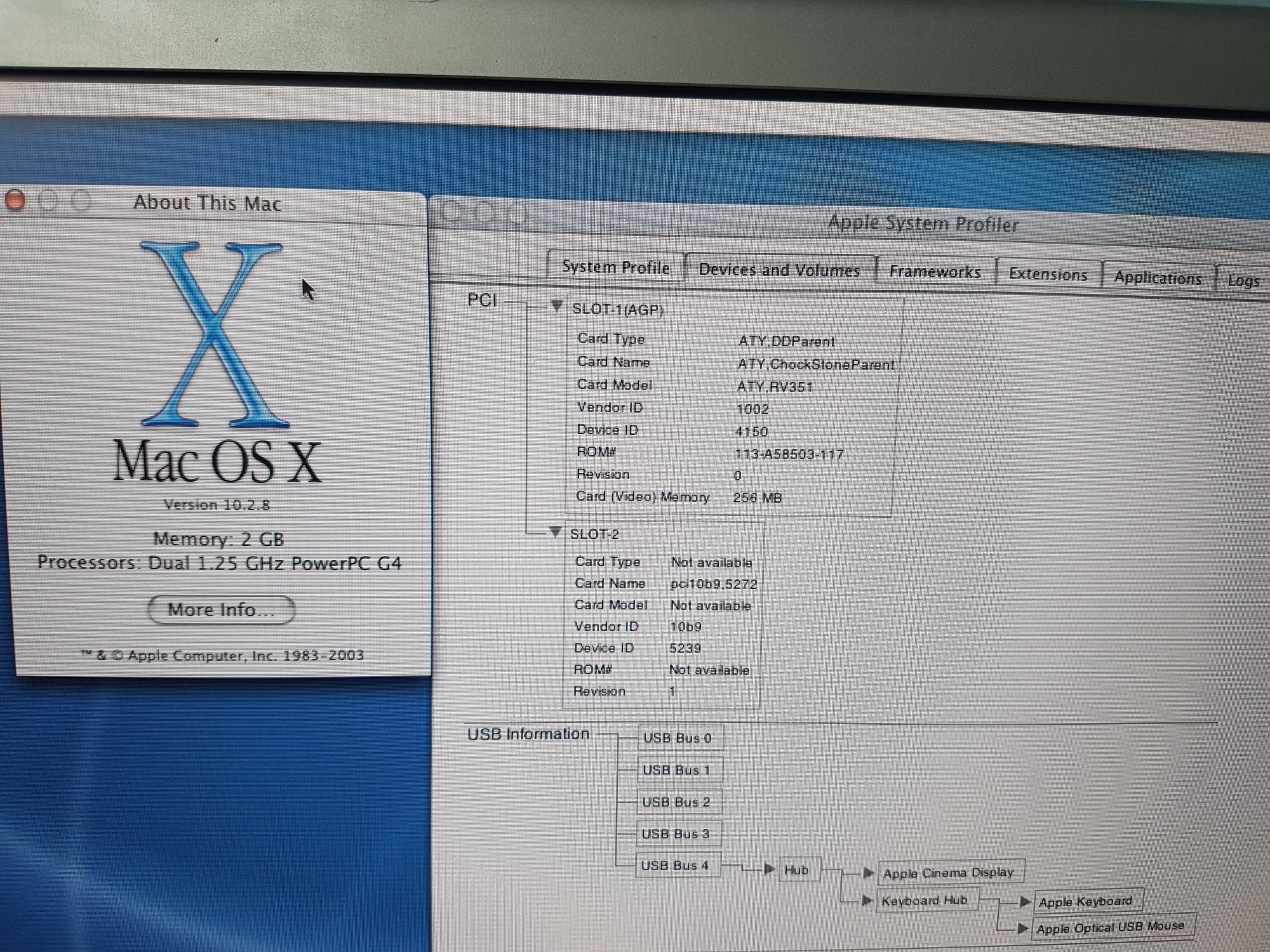

Failed at the first hurdle. Burned a 10.2 CD image from Macintosh Garden. G4 refused to boot, I guess as the minimum supported OSX for the G4 is 10.2.3. Anyone know where I can find an image for 10.2.3 or later? I did some searching and came across some methods involving Target Disk Mode, but I don't have another PowerPC machine unfortunately.
EDIT: I have found this - the 10.2.3 restore discs for the FW400 2003 PowerMac. http://macos9lives.com/smforum/index.php/topic,3266.msg20810.html#msg20810
Do you guys think this will work?
I'd grab a 10.2.7 disc set from 'the Garden' and modify it to work on your G4.
The comments even say it works unmodified on MDD 2003.
Edit - But yeah, 10.2.3 for the MDD 2003 should work as the model identifier is the same for all MDDs. According to the description, the images you found contain 10.3 though.
Reactions: r6mile
It would be great if you did that - to check if the 9650 works in 10.2 🙂
I can confirm that the Radeon 9650 works with no issues (that I can see so far) in 10.2.8 Jaguar. I installed from a 10.2.7 iMac disc (unmodified), ran the 10.2.8 updater, and everything is good!
