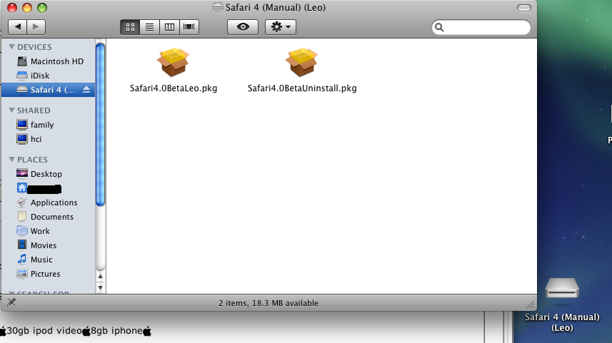

As a final resort, you could download firefox onto a usb key and use that as your default browser, but first give this a try if you haven't already - its the dmg file you first install safari 4 from, although your icon will look different to mine probably:

Thanks for all your help guys. I ended up using a windows P.C to put Opera on a disc. Installed that then re installed Safari 4.0. Thus bringing up the uninstall icon. Now i'm back to Safari 3.0 and my Hotmail is fine. All my Bookmarks are gone though! Any ideas on how to get them back? I have them stored on my Nokia N96,dont know if i can transfer them back?
