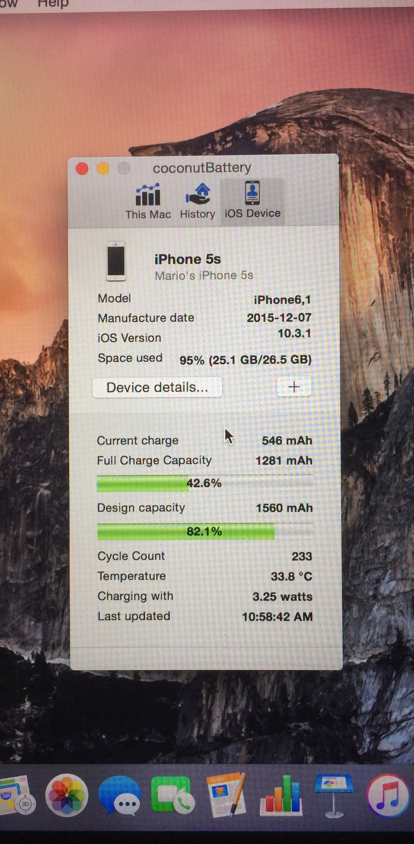

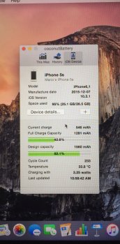

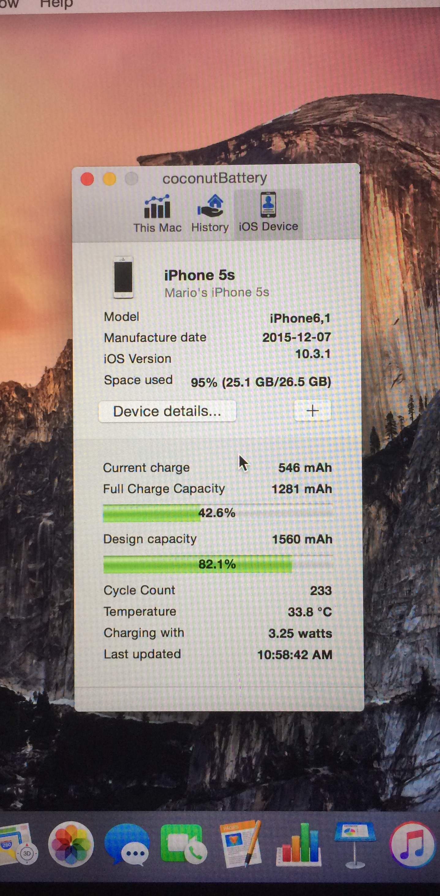

I got my new 5s swapped out for a refurb unit last September for a proximity sensor failure. Ever since then I noticed the battery wasn't as good as my old one.
Ever since I updated my 5s to iOS 10, the battery life has been horrendous. I've gotten anywhere between three to five hours of use from my phone.
I just checked Coconut Battery on my sister's Mac and saw that the battery is not too good. 82% with just 233 cycles?
Just how accurate is Coconut Battery, and what should I do?

I'd take it to an Apple store. See if they'll run diagnostics. Ask them what they think.

I'm sure they'll say it's fine, but doesn't Apple say that iPhone and iPod batteries should hit 80% capacity by 500 cycles? My phone isn't even close to that, according to CoconutBattery.

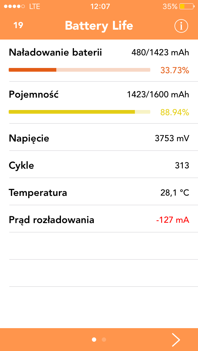

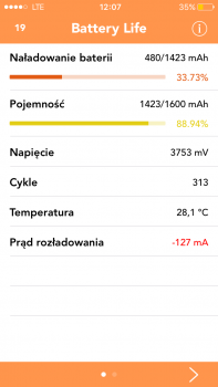

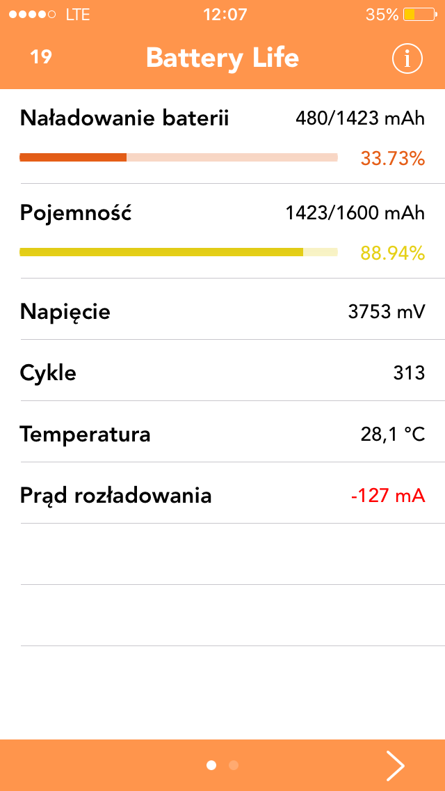

By the way that's my SE capacity (around 89% when fully charged). Is it normal ?

I don't know when you got yours, but assuming your SE was bought in Spring 2016, then it looks like normal wear to me over a year later with 313 cycles. My problem is that it's ~80% already with ~240 cycles now.
