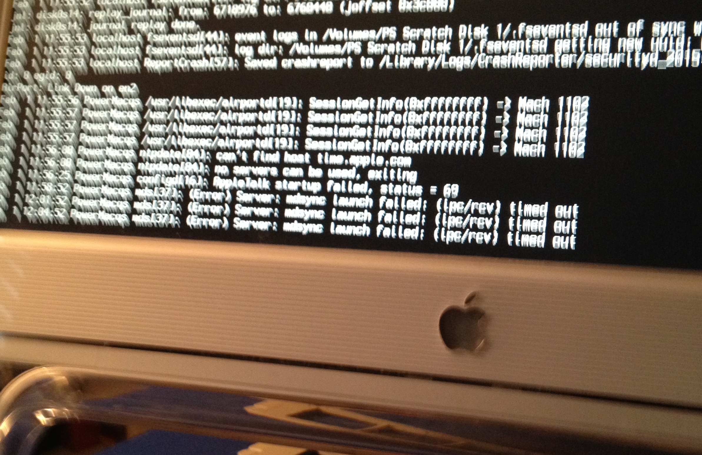

Somehow, somewhere along the way I've managed to screw up the Leopard install on my Quicksilver.
I know I should have backed up, but didn't, so I'd really like to get it going again. As best as I can tell, everything is intact, it just won't boot.
Sometimes, it will hang at the gray screen with the progress indicator spinning. Other times, it will boot to a blue scree with a cursor, but the login prompt never appears.
Booting in safe mode does not change anything.
I think I can safely rule out a computer problem-it boots to Tiger just fine, as well as when I put my Powerbook in TDM and boot off the Leopard install on its hard drive.
I've tried repairing the disk and repairing permissions from Diskutility when booted from the Powerbook.
I've also been able to successfully boot into single user mode. I've run fsck from single user mode a couple of times. Generally, it will report that it made modifications the first time it is run. In accordance with how I understand to use this tool, when I run it a second time it reports the file system as fine. Rebooting gets me back to what's described above.
As I said, I really want to preserve this Leopard install for a variety of reasons.
Is there anything else I can do to try and fix this? Failing that, is it possible to use the Leopard install disk(which I have, but not with me at the moment) to do a "repair" install that will basically keep everything as is but fix the underlying problems?
I had a mirror door doing similar behavior to that, it turned out to be bad ram slots on the motherboard. I finally had to junk that board.
Try removing some ram, and see how it runs.
If it were a RAM or logic board problem, why would the computer boot fine with things other than this specific Leopard install?
In any case, I'm currently trying to boot in Verbose mode, and this seems to be where it's hanging
mds[37]: (Error) Server: mdsync launch failed (ipc/rcv) timed out
Here's a photo(blurry) of the verbose mode start-up screen

Probably the hard disk starting to fail. Pull what you can off of it as soon as you can.
This is a brand new WD Caviar Blue manufactured in Feb. 2011 with about 20 hours of run time on it.
I actually cloned the install yesterday off the old hard drive-a 120gb Maxtor with about 1000 hours of run time that Smart Utility was telling me was failing.
I was having the same problem on the old hard disks-I thought it might be a permissions issue, and went ahead and cloned it because I know CCC repairs permissions as part of the cloning process.
I have Tiger on the same hard drive and it boots fine.

If you cloned this Leopard install off a failing drive, it is likely that the clone has similar corruption. A fresh install should fix it easily!
Well, mdsync is Spotlight, so maybe the Spotlight database has gone corrupt.
Try booting in Tiger, then on the Leopard disk go to the Spotlight DB files and move them elsewhere. Then try booting.
Your Spotlight index will have to rebuild, but small price to pay for booting.
You'll have to Google where these are as I don't recall.
Failing that, find a copy of Diskwarrior. DW 4.4 is universal (so is 4.3). DW is far more robust than Disk Utility.

That actually makes sense, as I recently re-enabled spotlight(after having it off for a while) and had not rebooted the computer since.
I just deleted the index, so we'll see what happens.
No luck with playing around with Spotlight....
I even went back into single user mode and disabled it completely, but the computer still won't boot.
I'm currently using Disk Warrior to repair the permissions...interestingly enough, it would not do so when booting from the Disk Warrior disk. I had to install it on my Powerbook, then boot the Quicksilver from that and do the permissions repair.
I'll report back in a little while when that is done.
If this doesn't work, I'll do an archive and install tomorrow.

No luck with Disk Warrior. I tried both rebuilding the directory and repairing permissions, and didn't improve anything. It looks like it's going to be archive and install.
With that said, I don't think that my time spent with Disk Warrior is totally lost. I have a corrupted flash drive that was formatted HFS+ and has been unreadable for a while. DiskWarrior seems to think it can fit it, so I'm letting it try. The drive didn't have anything important on it, but did have a bunch of my commonly-used PPC files that I kept handy.
Archive+Install got me going again.
