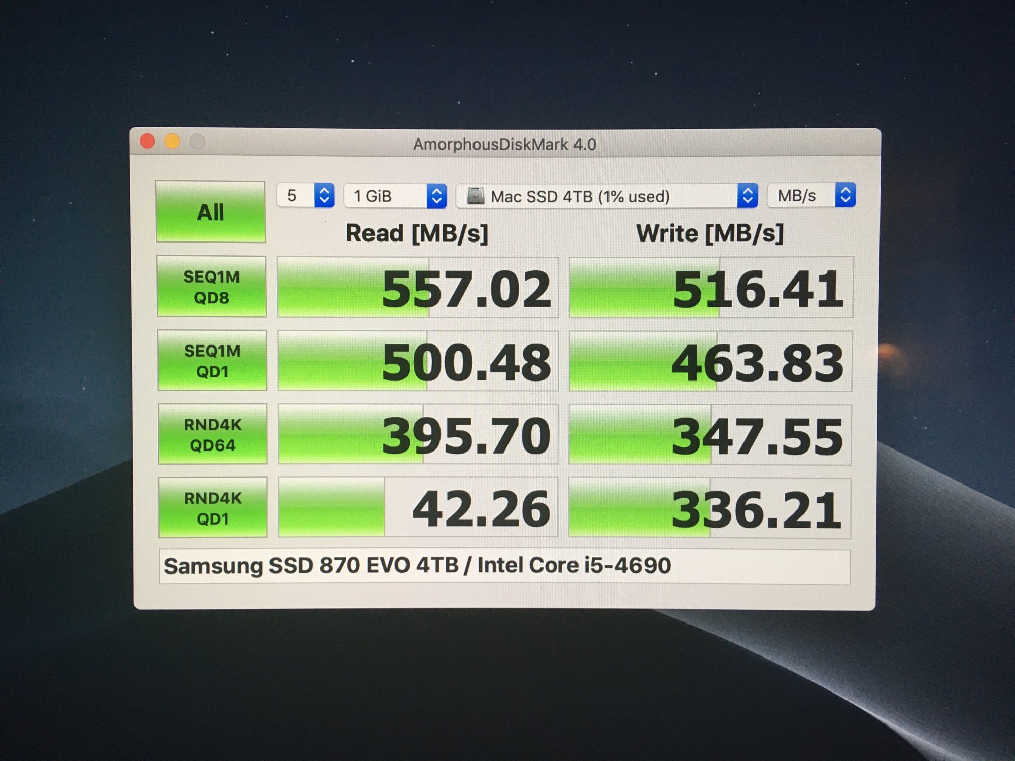

Given the age, and the fact that the OEM SSDs in the 2014 iMacs are PCIe2x2 and max speeds are not as fast as the 2015 and up iMacs, I would at least test the OEM SSD speeds by itself first, and compare the speeds to the new SATA SSD. If it is only a little bit higher, probably not worth the potential trouble. If the OEM SSD is still in pretty good shape, and the speeds are significantly higher, I would say go for it.
Use AmorphousDiskMark to test the speeds, it is in the Mac App Store, and tests random speeds as well as sequential (unlike BMDST which only does sequential).
Test both drives and compare.
Only one drive showed up in the app to do this test. Thew new 4 TB SSD. No other drives listed in the drop down:

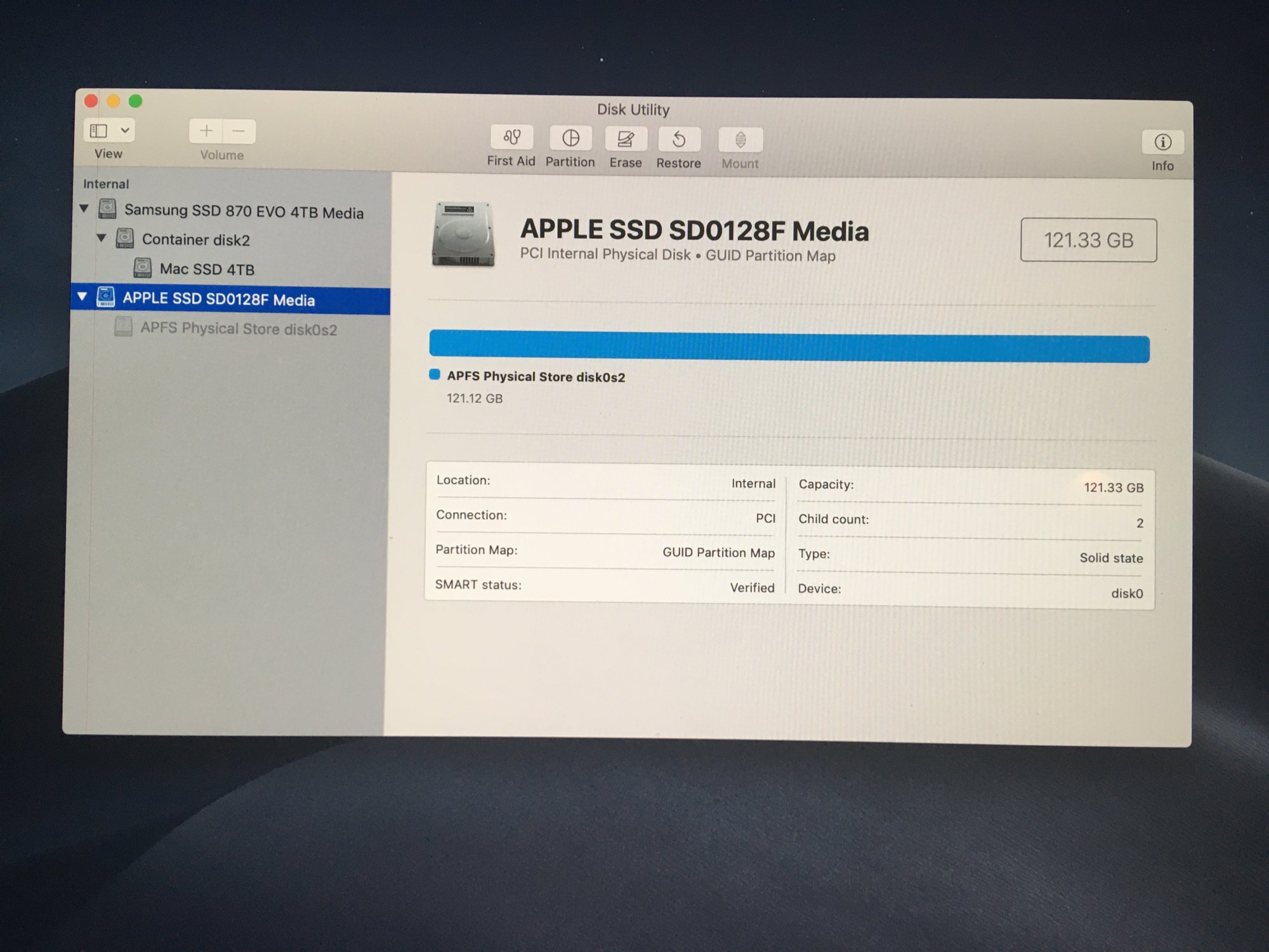

To use the 128GB SSD you just need to reformat it. It’s currently formatted as part of the old Fusion Drive, which is why it isn't showing any volumes.
Reactions: Brian33 and chown33
The only drives shown are the 128GB SSD and the external 4TB SSD. Nothing at all appears for any other drive.
I think @DeltaMac's suggestion to use diskutil list in a Terminal window is a good next step. You can drag-select its output text in the Terminal window, then copy-and-paste into a post here. Or post another screenshot showing the Terminal output.
@chrfr also makes a good point. Some enclosures simply won't work with large-capacity drives. Can you identify the make and model of the enclosure? With that information, it may be possible to find specs for it.
