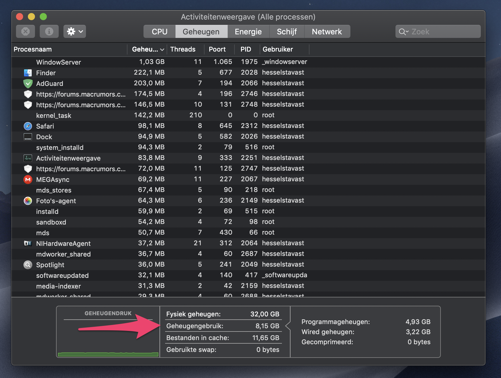

I think it will flatten out at 16GB in normal use cases. In fact It appears as though 8Gb is actually too little for MacOS to run smoothly. I'm running nothing else besides 3 safari tabs right now and my memory usage is still 8,15 GB. When I was using 8Gb my swap was always being utilized.

I think the 1,5 GB is the maximum amount. It will fluctuate depending on other tasks that require RAM.
