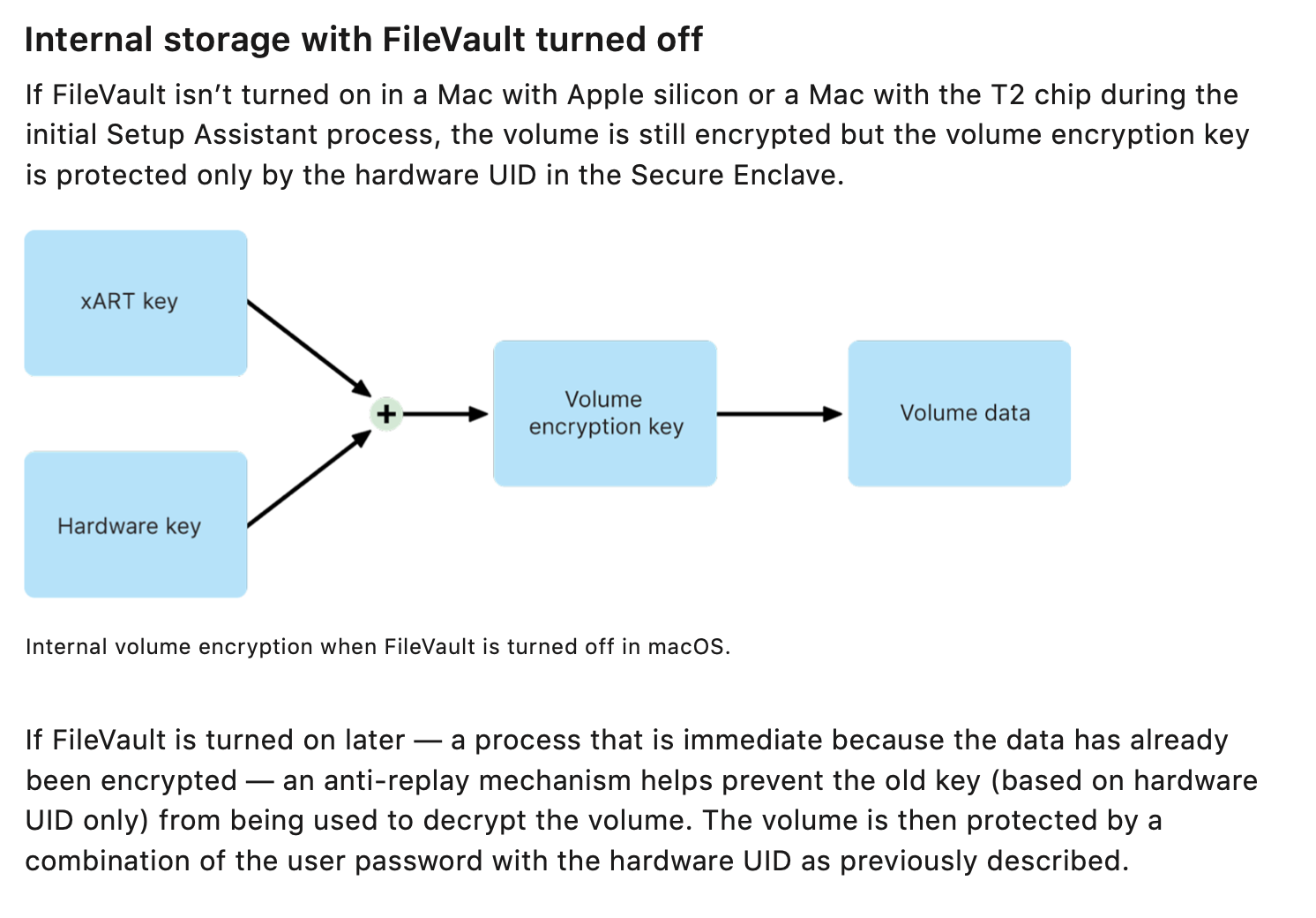

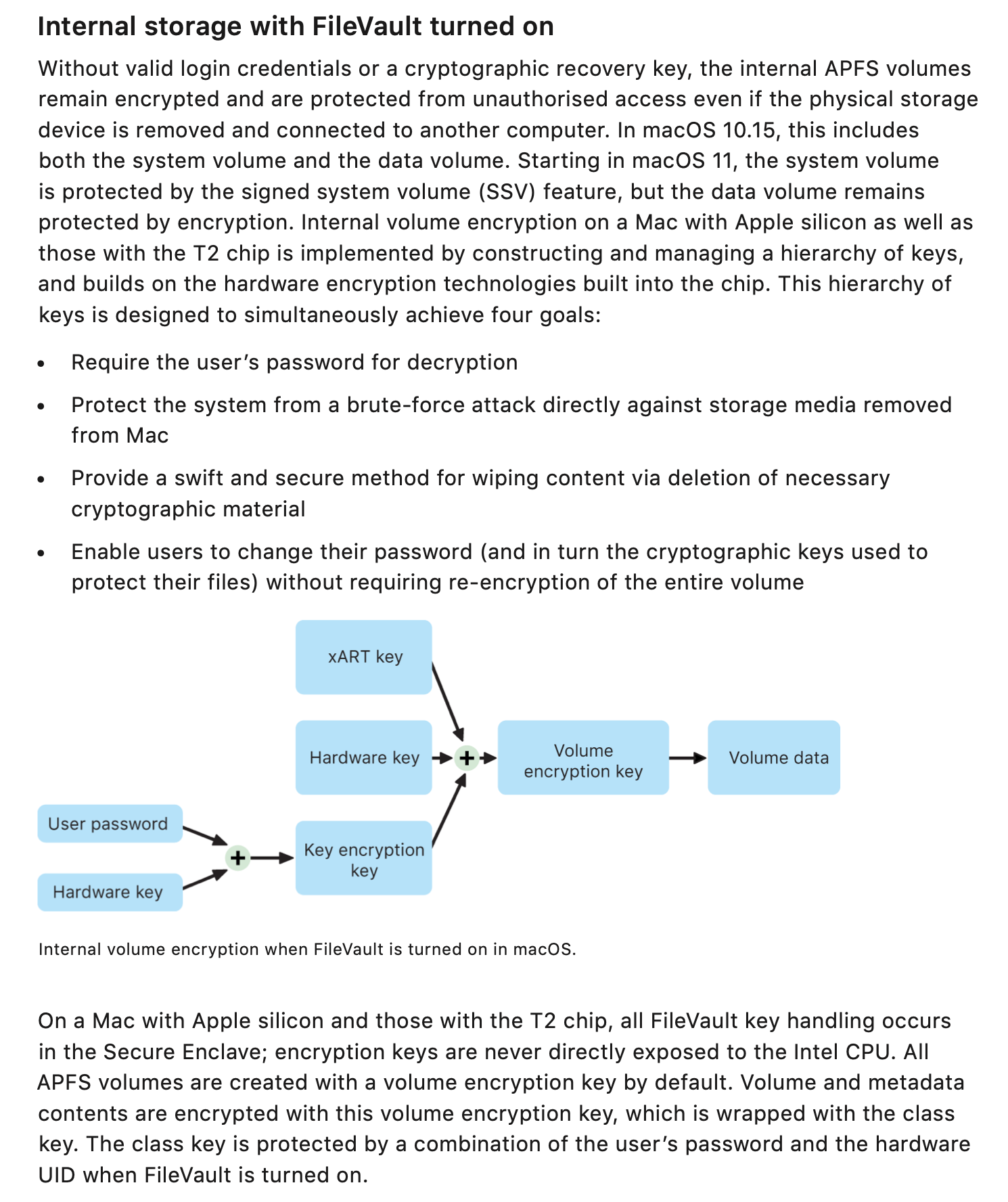

FileVault is a complement to the integrated data protection of Apple Silicon(and T2). Your data volume is still encrypted even with FileVault turned off. Turn FileVault on will protect the key used to encrypt your volume by another "key encryption key" which require your password to be unwrapped (hence the need to enter the password on boot up).
Below are from Apple's platform security guide.
Thanks for detailed explenation. I didn't know the details but I more or less expected it would work something like, except the xART part I had not considered. Since it is not descripted I searched for an explenation:
