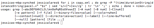

It throws this out 80+ times, but it does make the csv file, only it's just an empty table:
usage: grep [-abcDEFGHhIiJLlmnOoPqRSsUVvwxZ] [-A num] [-B num] [-C[num]]
[-e pattern] [-f file] [--binary-files=value] [--color=when]
[--context[=num]] [--directories=action] [--label] [--line-buffered]
[--null] [pattern] [file ...]
Comment

Make sure you are copy/pasting that whole line in it's entirety. That error message is from grep. I had no problem with it here, and I tried it again just to make sure. The only thing I can test it on is what you have given here, and another part from one of those xml files which I found online. Having said that, the error would not depend on the input, but grep being used wrongly.
I've attached a screenshot. I'm sure I copied it correctly? :confused:

           g   r   e   p       -   P       "   (   t   i   m   e   |   d
0000020   165 162 141 164 151 157 156 123 164 162 151 156 147 174 144 151
           u   r   a   t   i   o   n   S   t   r   i   n   g   |   d   i
0000040   163 164 141 156 143 145 123 164 162 151 156 147 174 160 141 143
           s   t   a   n   c   e   S   t   r   i   n   g   |   p   a   c
0000060   145 051 042 040 154 141 163 164 127 157 162 153 157 165 164 056
           e   )   "       l   a   s   t   W   o   r   k   o   u   t   .
0000100   170 155 154
           x   m   l
Which is an octal dump just to make sure there are no weird characters in there (characters up to 177 octal are valid ascii).

That's odd. What happens if you do 'grep -V'? You may try to replace the '-P' with '-E' the P option is for Perl regular expressions but the odd thing is that it's mentioned in that usage message you get there.
grep (BSD grep) 2.5.1-FreeBSD
And yeah, the -E instead of the -P finally gives me the data.

Interesting, I get "(GNU grep) 2.5.1". So, even though the same flag are supported "-P" there seems to be an incompatibility.
But with that out of the way, let's go back and try the previous version again, with the -E modification this time.
Code:
for i in *.xml ; do grep -E "(time|durationString|distanceString|pace)" "$i" | sed 's/<[^>]*>//g' | tr '\n' ';' ; echo ; done > nike+.csv
Btw, you can add a second "tr" in there to remove leading tabs if you have them in the xml.

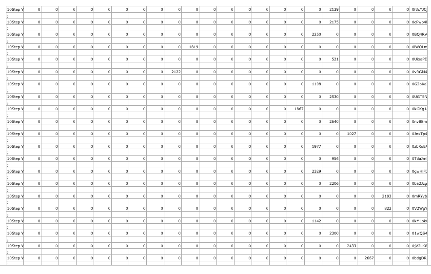

This is what the csv looks like.
And this is from the first cell:
10Step Workout2013-01-07T17:45:54+00:00181074230'11"1.54210.96 mi117418831'30" / mi81021390072.6MD477LL1.0.2 (37A20067)DCYJHBDRF0GP2013-01-07T17:45:54+00:002013-01-07T18:16:05-06:000

I think you'll need to attach one of those xml files here then, if you can. This is what I get in Numbers, with three xml files (all the same) which I found online here: http://blog.mattmecham.com/2006/09/05/ipod-training-data-under-the-hood/. It seems to only be a part of the file btw.
Edit: Actually, you can also try to remove the redirection to the .csv file (> nike+.csv) and look what it looks like in the terminal, it should be something like this:
