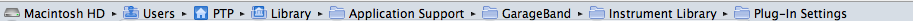

We know our applications go in the Applications folder, but where should
all your AU, VST and RTAS plugins go? HD/Library or User/ Library? and exactly where? What folder is actually correct?
I noticed that some AU files come in as .aif and others .wav
You also have sampler files with individual file names like a tenors sax with the file names like "TESLNOMA2X01" with and sampler instruments with an .exs extention.
So, what is the best method and location to PROPERLY organize your different loops, plugins
and instrument libraries?
I see that some plugins end up in HD/Library/Application Support, but others end up in Audio so it gets pretty confusing.
At the moment I have copies in several locations and I'm sure I'm wasting
HD space putting things where they don't belong.
The garageband folder is in your user library application support, and then garageband (see attached pic1.png)
The folder called audio in library has a purpose but im not entirely sure what it is. I think its where all the AU plugins are stored. (someone may correct me if they wish)
Next up protools 🙂 Digidesign stores all of its settings, for video engine, audio, plugins and stuff in its own section in Application support, see attached pic2.png
I cant remember logic or cubase because its been a while since i used them last. But they will be in the library folder somewhere, most likely under app support 🙂
PTP
