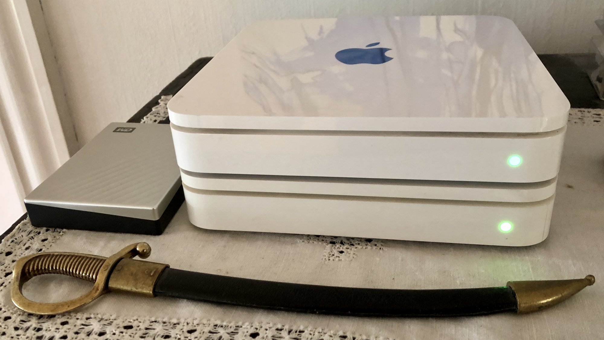

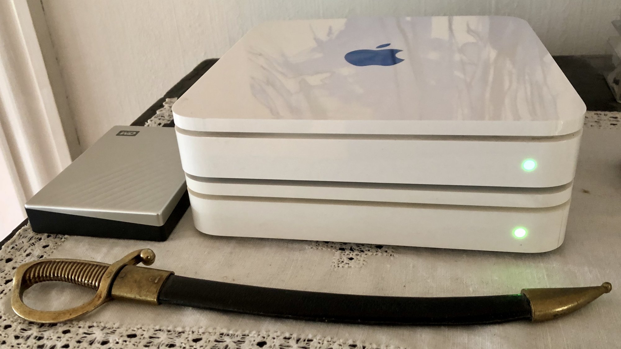

We use Google WIFI mesh, just found a brand “new” unused 2 TB Time Capsule for USD 40 as a backup for the 10 years old 1st generation, it’s a shame Apple discontinued the production.
looks like 2 of them in the picture? 👍
