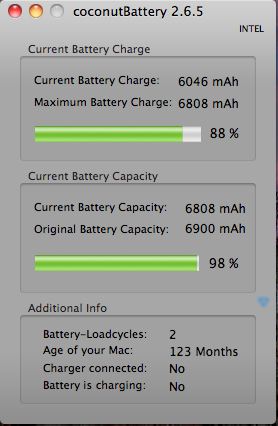

Does this look weird to anyone?
Why would a battery one day out of the box only be capable of charging to 6808mAH / 6900mAH?
Could it just be a matter of the battery not being calibrated yet?

Probably. Try calibrating it and then report back.
It could just be CoconutBattery. It sometimes has trouble correctly reading the newest machines.
Will do. What a pain in the a$$ process calibrating is... I probably won't do it until tomorrow night at this point.
If anyone has an i5 and can check theirs, I would appreciate it.
As far as it being CoconutBattery, iStatPro is reporting the same thing.
It's probably a calibration issue... I hope.
System Profiler is also showing the full charge capacity as 6808 mAH...

The readings are never 100% accurate. Your battery capacity will fluctuate up and down over time. It's not unusual at all. You're fine, as long as it doesn't drop below 80% within 300 cycles.

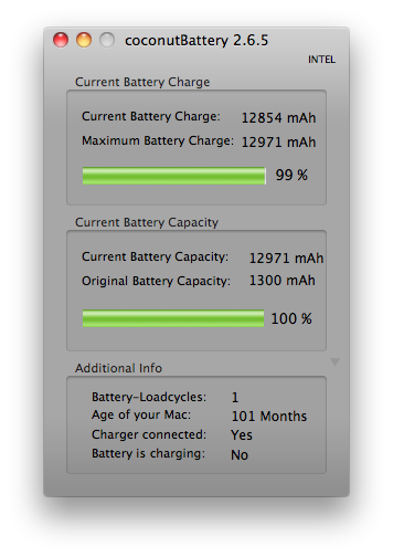

Coconut Battery is buggy as crap. Look at the screenshots, it says original battery capacity is 1300 mAh. That's like an iPhone's battery capacity !
