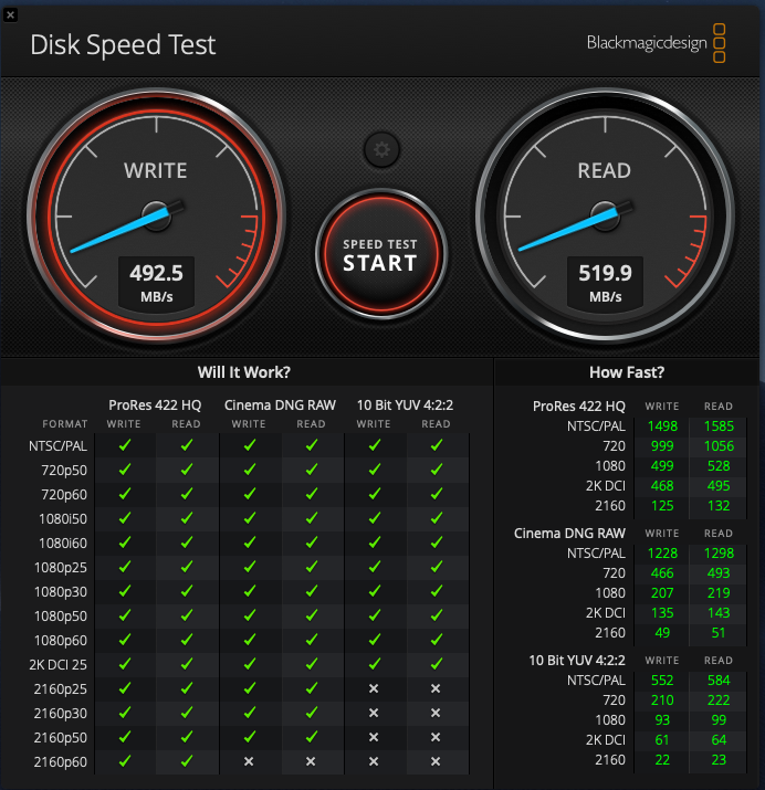

Thanks for the pointer on the T5 series. While it pains me to think of getting another external drive when I've got 6TB of them already, the fact of the matter is they are all several years old, the WD HD periodically gobbles itself and has to be reformatted, and none of them is an SSD.
Part of my speed problem with the old mini has been that old USB hubs and peripherals dumb everything down to the lowest USB speed, even if they are capable of faster throughput. Cleaning all this up is one of the challenges I will face in getting a 2018 mini. I've been using Macs since my 128K Mac in 1984, but it doesn't get easier, the older I get. I suppose in another five years we'll just be ordering Siri around to take care of it all. 🙄
Here is a Blackmagic Speed Test on my 500GB Samsung T5 flash drive > Mac mini i5 Thunderbolt 3/USB-C port. The T5 drive has two AFPS volumes:

F-train wrote:
"Here is a Blackmagic Speed Test on my 500GB Samsung T5 flash drive > Mac mini i5 Thunderbolt 3/USB-C port. The T5 drive has two AFPS volumes:"
Those speeds look good.
I'd be interested in seeing one from the t5 with an HFS+ partition...
The T5 is a flash drive that I've configured for APFS, two volumes.
